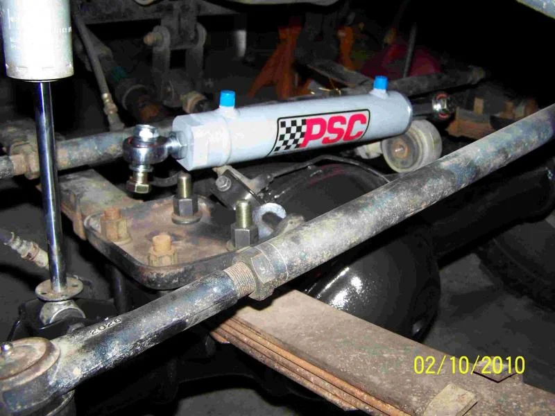

Still not sure how I am going to mount the ram to the axle since the 4x4 labs steering puts the tie rod behind the axle. With the C&T the ram mount will need to be more than just short tabs welded to the top of the diff.

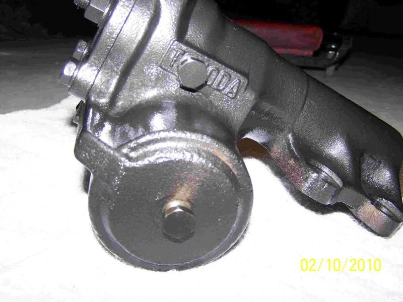

The steering box seal kit finally came in so I drilled, taped, resealed and painted the steering box so it's ready to go. It took me about 3 hours to complete including paint.
I still need to decide on the mount for the ram. I am thinking of building a mount off the spring plate. Any other ideas?
Not too keen on the spring plate mount but it doesn't look like you've got many options with being behind the axle. Would you beef up the spring plate?
I have a new U-bolt to replace the shorter old one in the picture. I would then make a 1/4" steel plate to add to the top and put the mount on it.
I could turn the ram around and bend a tube to add to the driver side axle housing and mount the ram to it. The truss in the picture is just setting on the axle so making modifications is not a problem.
I worked on a mock up of a hoop on the driver side axle as a mount for the ram last night. The hoop and the ram are not attached in the pictures. They are leaning against the tie rod for support. If I go with this mount I will have to do a little fit adjustment for the hoop to the axle and get it welded so the ram is spaced off the tie rod. The anit-wrap bar is removed from these pictures and would take some additional work to get it installed. Or I could just leave it off and see if I break another pinion.
Comments or suggestions on this option?
