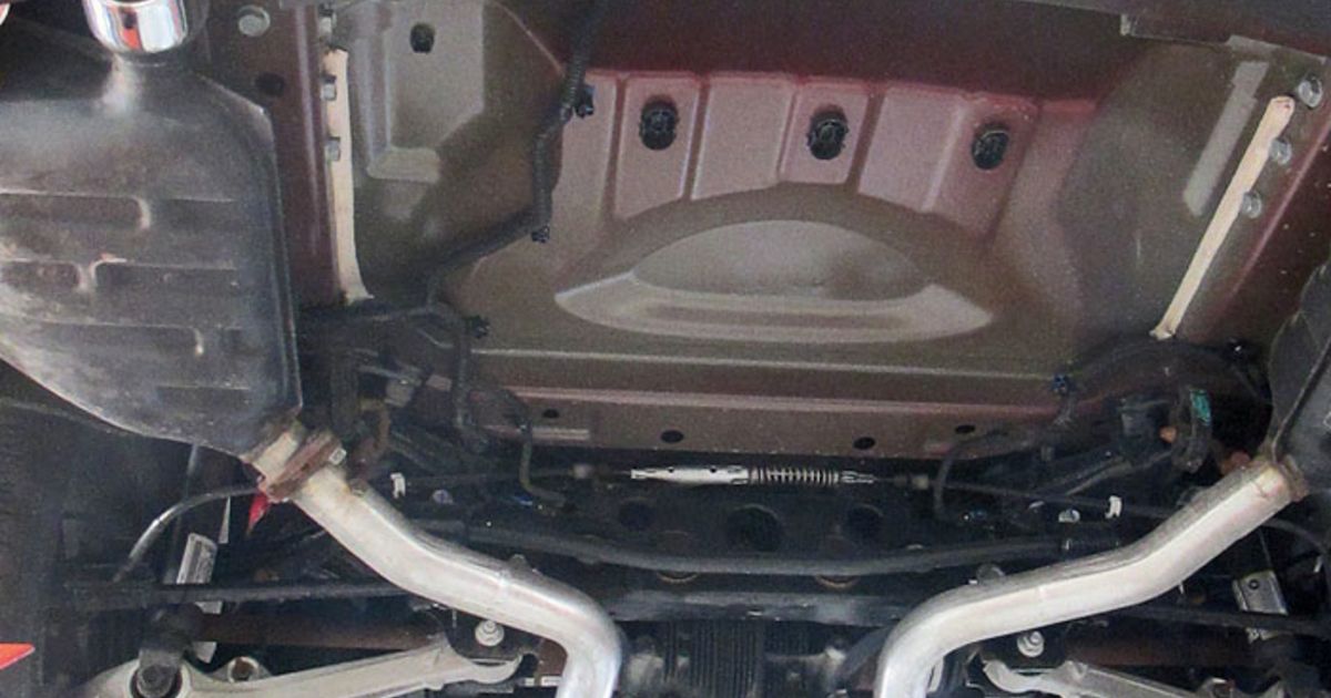

Stupid question to those that have this tank... are you guys afraid in a rear end crash? Has these tanks been crash tested? Since these tanks are placed behind the rear axle and in front of the rear bumper, it is kinda dangerous, no??
good question. A long time ago I was rear ended by a Honda while in my lifted FJ60. My rear bumper ended up on the Honda’s hood as the car wedged itself under my truck. It was a relatively low speed accident and my FJ suffered no serious damage. The Honda was a mess. If the Honda had hit me at a higher speed I think it’s bumper could have hit my rear differential.
From pictures I’ve seen of the 40 gal LRA, it would get hit in a similar accident. A lift and some after market rear bumpers would make this worse.
I still want one of these tanks but I am leaning toward the 15 or 24 partially due to this potential issue. Thanks for the post as I was having the same thought.
My LC barely gets 300 miles per tank...so, these things are great to have...and am thinking of getting one. As i wrote in other thread, besides the G-wagen (previous gen), I cannot think of one vehicle where the gas tank is right behind the rear bumper. I think most (if not all) have moved it to inside the rear axle (in front of) due to crash concern.
Has these long range tanks connectors / hoses etc been crash tested to not spray fuel everywhere?
@wardharris should be able to chime in on this as he distributes them.
I have the 24 gallon and it sits higher than the spare tire would. While that doesn't answer your question directly, it wasn't and isn't a huge concern to me at this point.
