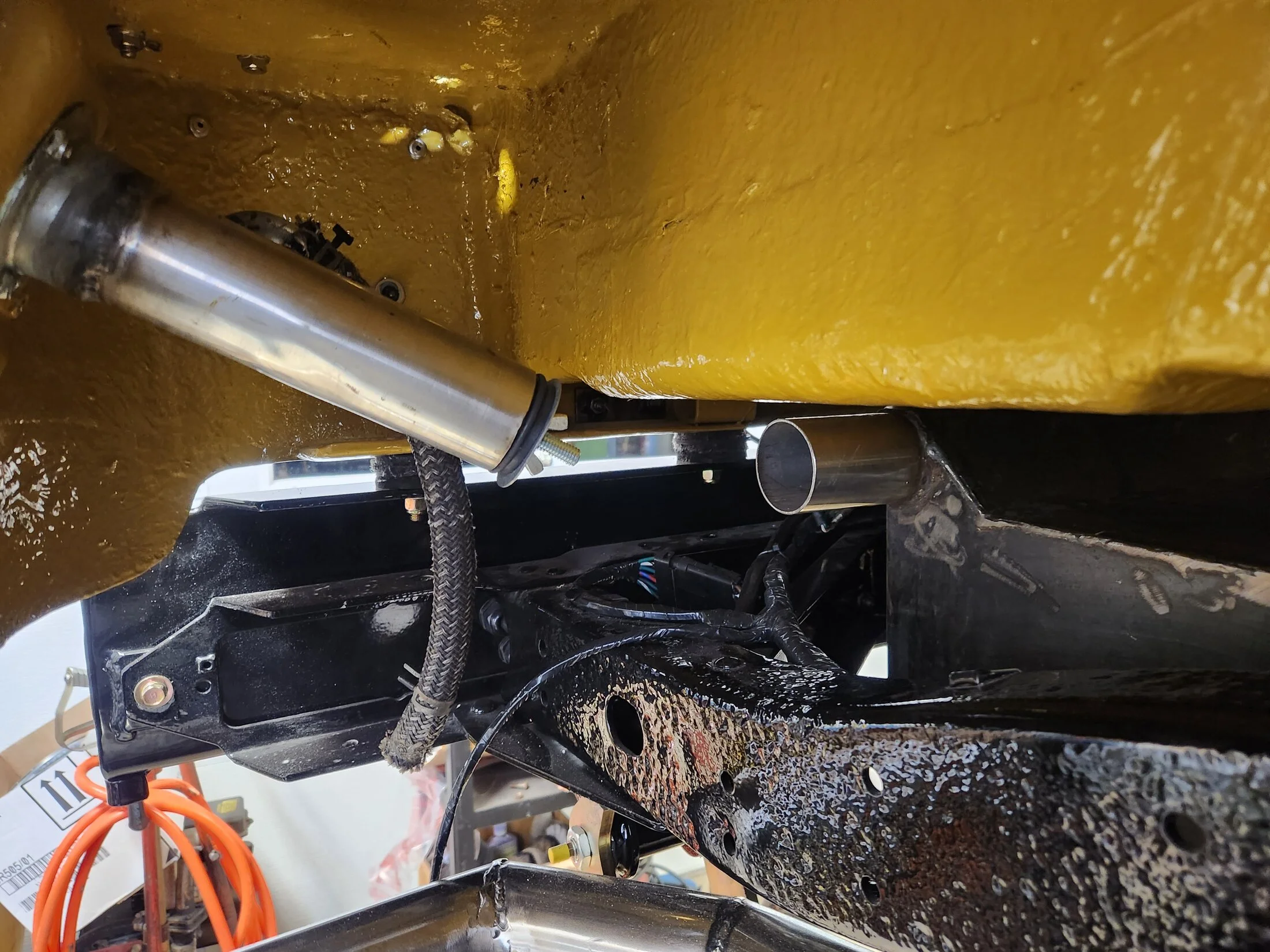

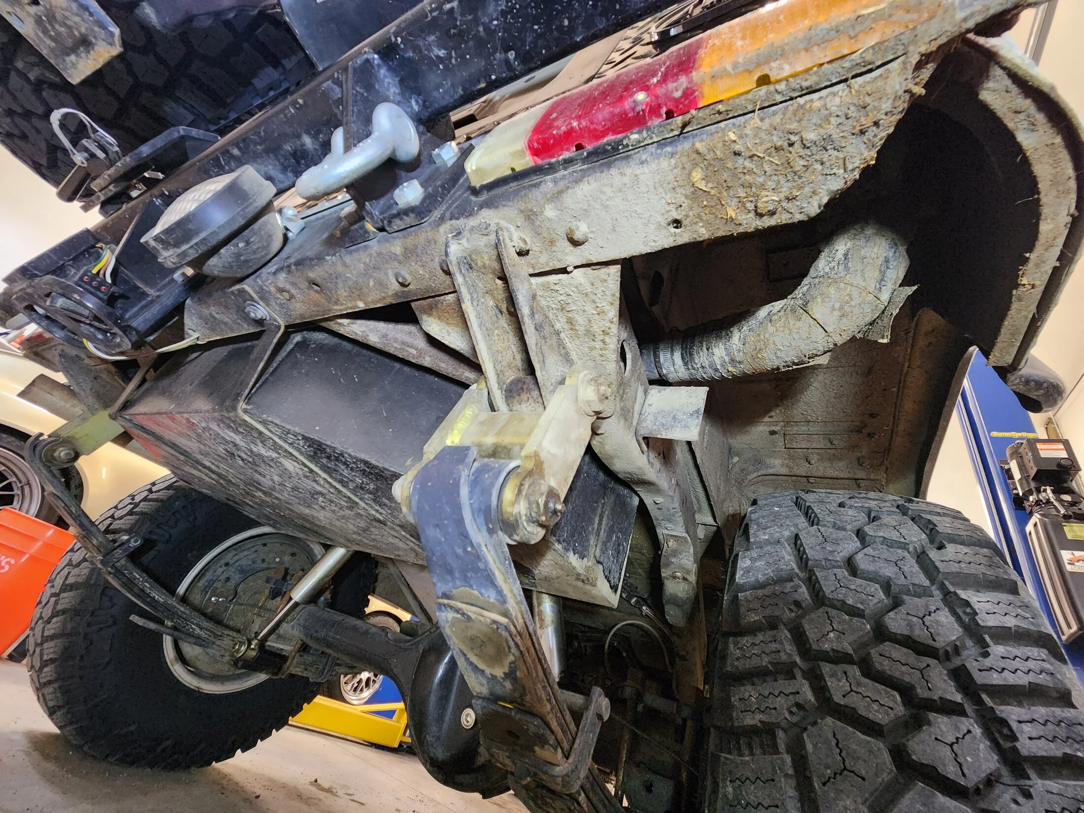

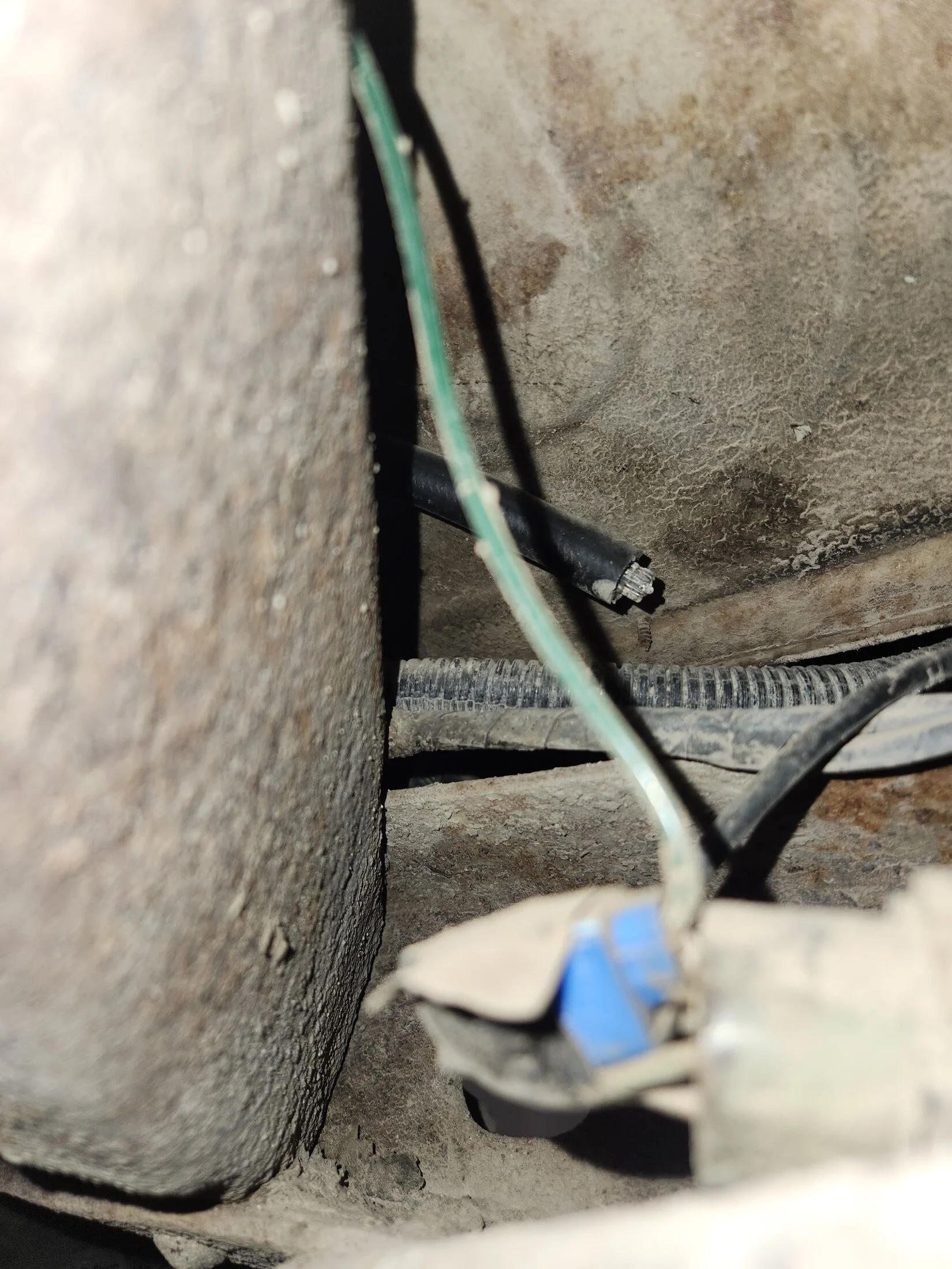

My 77 has an auxiliary tank in the rear. It's almost impossible to fill it at the gas station. The curve in the hose is so severe and it's at an angle where the gas wants to come back out immediately. I took a few pictures of the connection between the filler and the tank. What have others done to better make this connection?

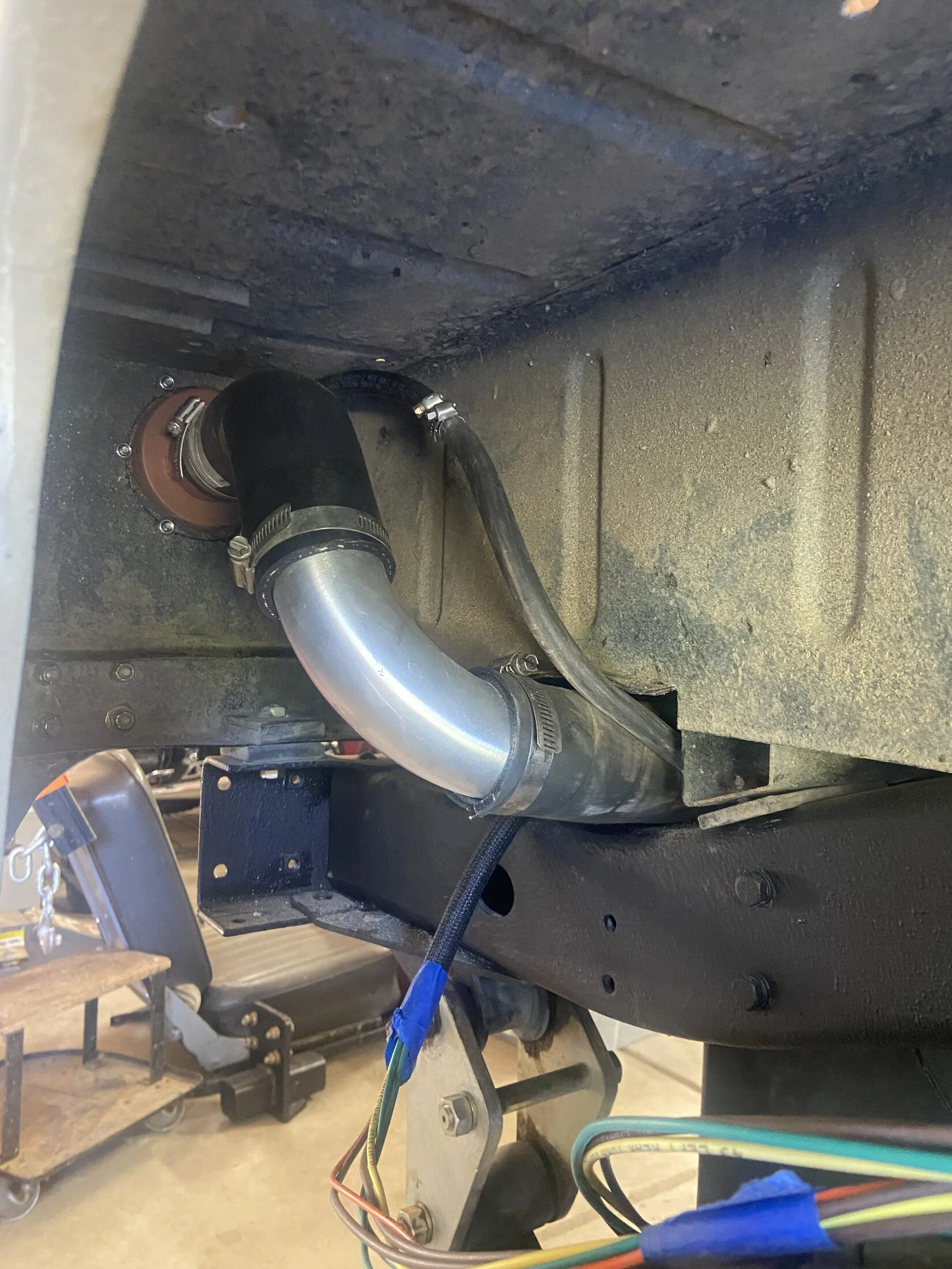

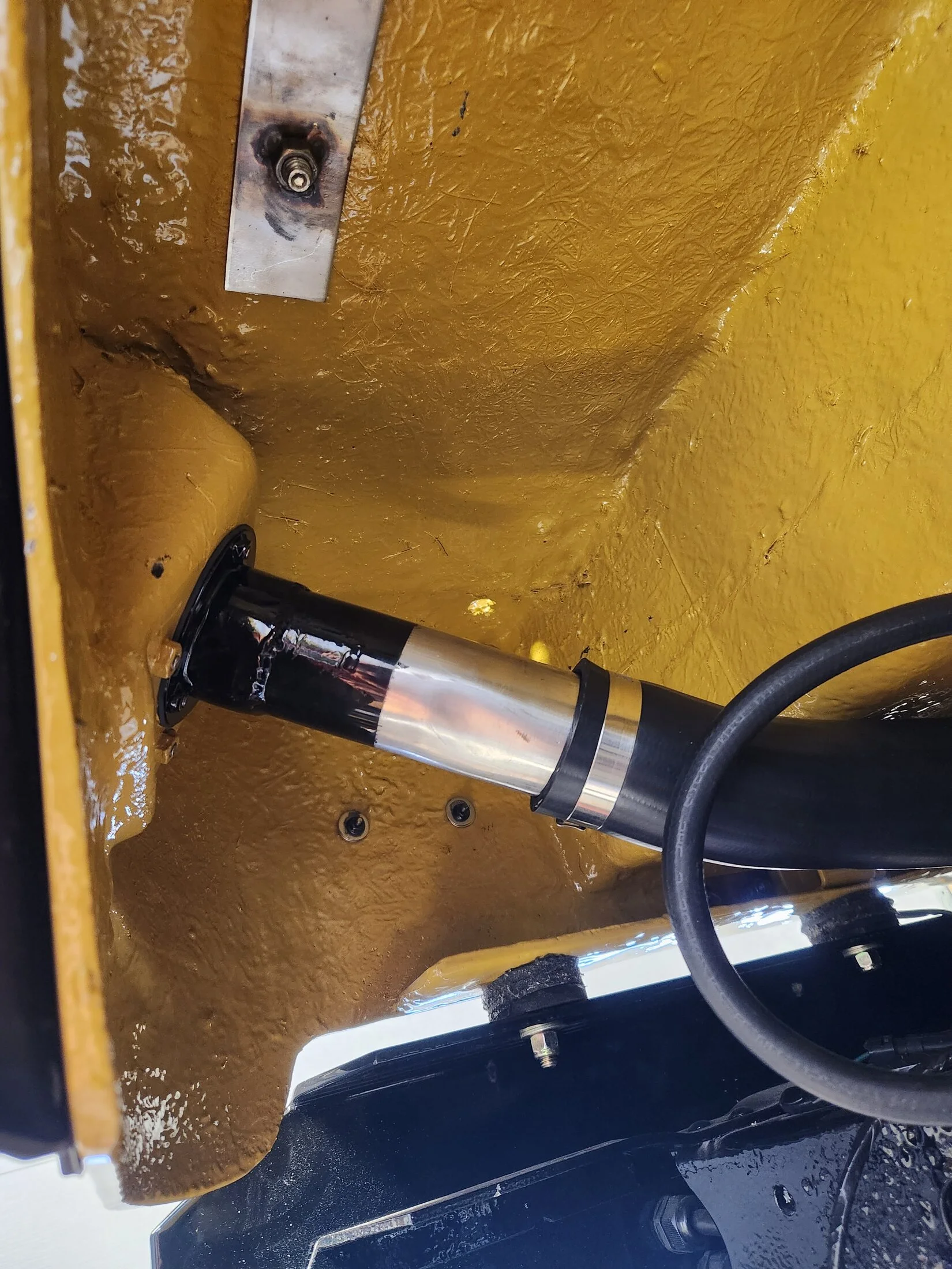

I used some 2” aluminum intake pipe that’s for turbochargers and bought some gas filler hose with a 45 degree bend.

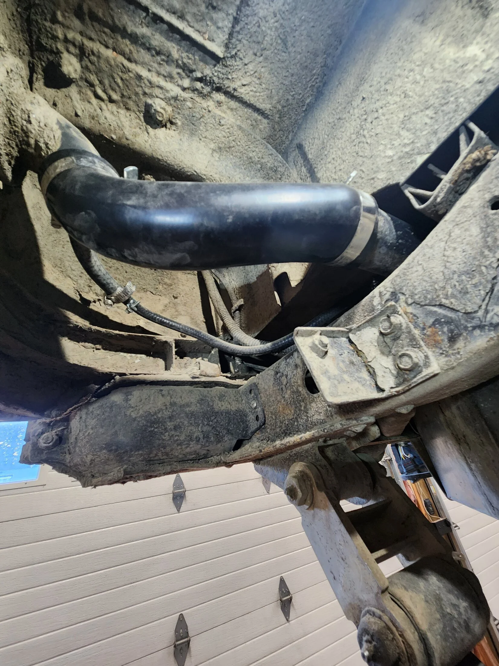

I ran mine out the back behind the spare and ran two vents; one to the filler and ran another up to the engine compartment with a home made carbon canister.
With the CA gas pumps it would shut down constantly before I ran that second vent. Now it can be filled in one shot.
I used some 2” aluminum intake pipe that’s for turbochargers and bought some gas filler hose with a 45 degree bend.View attachment 3782695
I ran mine out the back behind the spare and ran two vents; one to the filler and ran another up to the engine compartment with a home made carbon canister. View attachment 3782694
I like that it is hidden as well.
Nice job
Super clean install. OK, some great ideas here, thanks for the help.

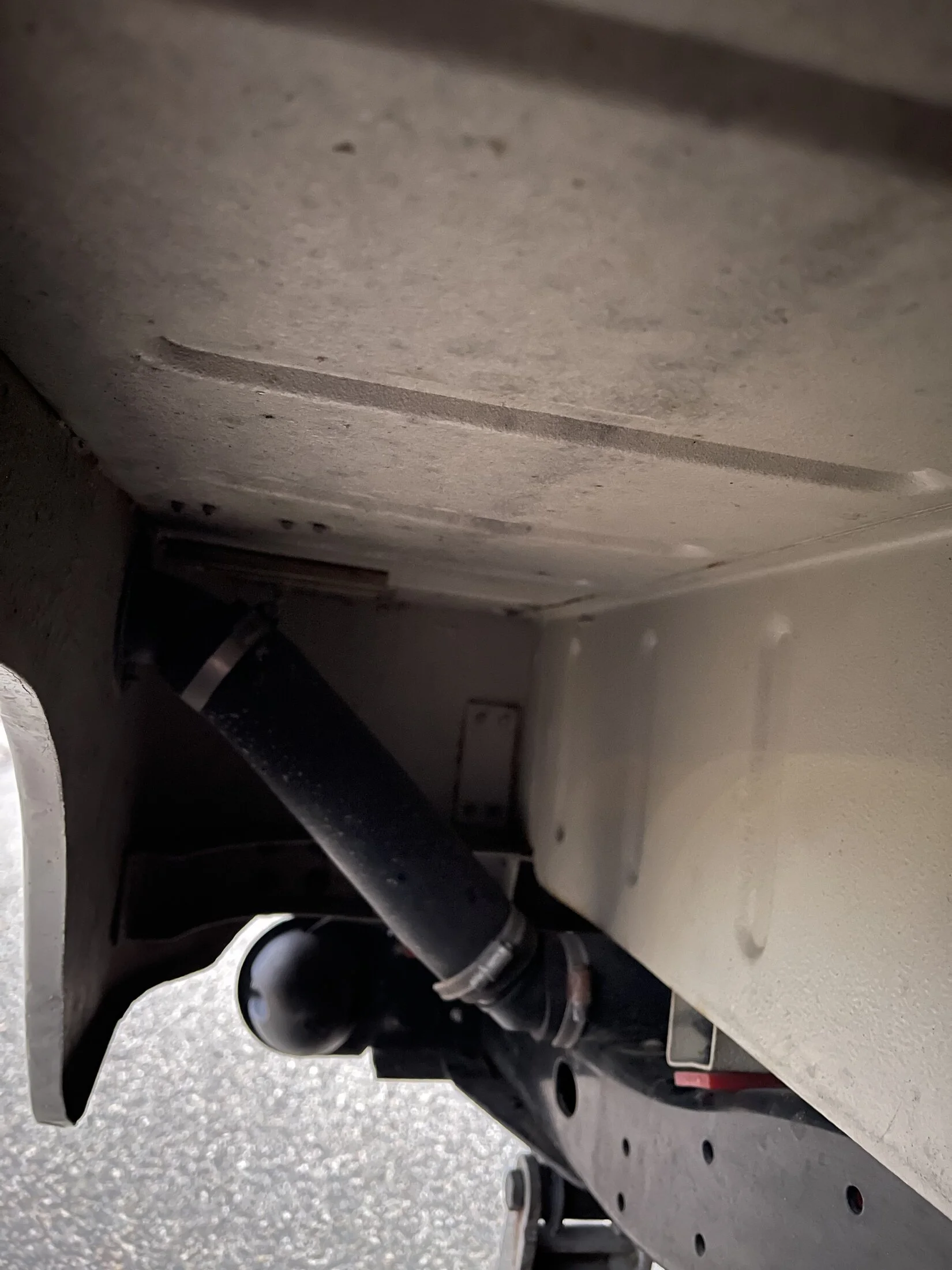

Taking that rib and folding or cutting it out makes it much nicer IMO. I did that as well. I used a SS boat filler that had a 30* angle, 2" nipple, drilled/tapped a nipple for vent just inside fender, and a piece of fuel hose 2" which was a pretty penny at napa. I have found that if you put 19 + gallons the sender likes to leak so I just stop at 18, I should drop tank & fix.

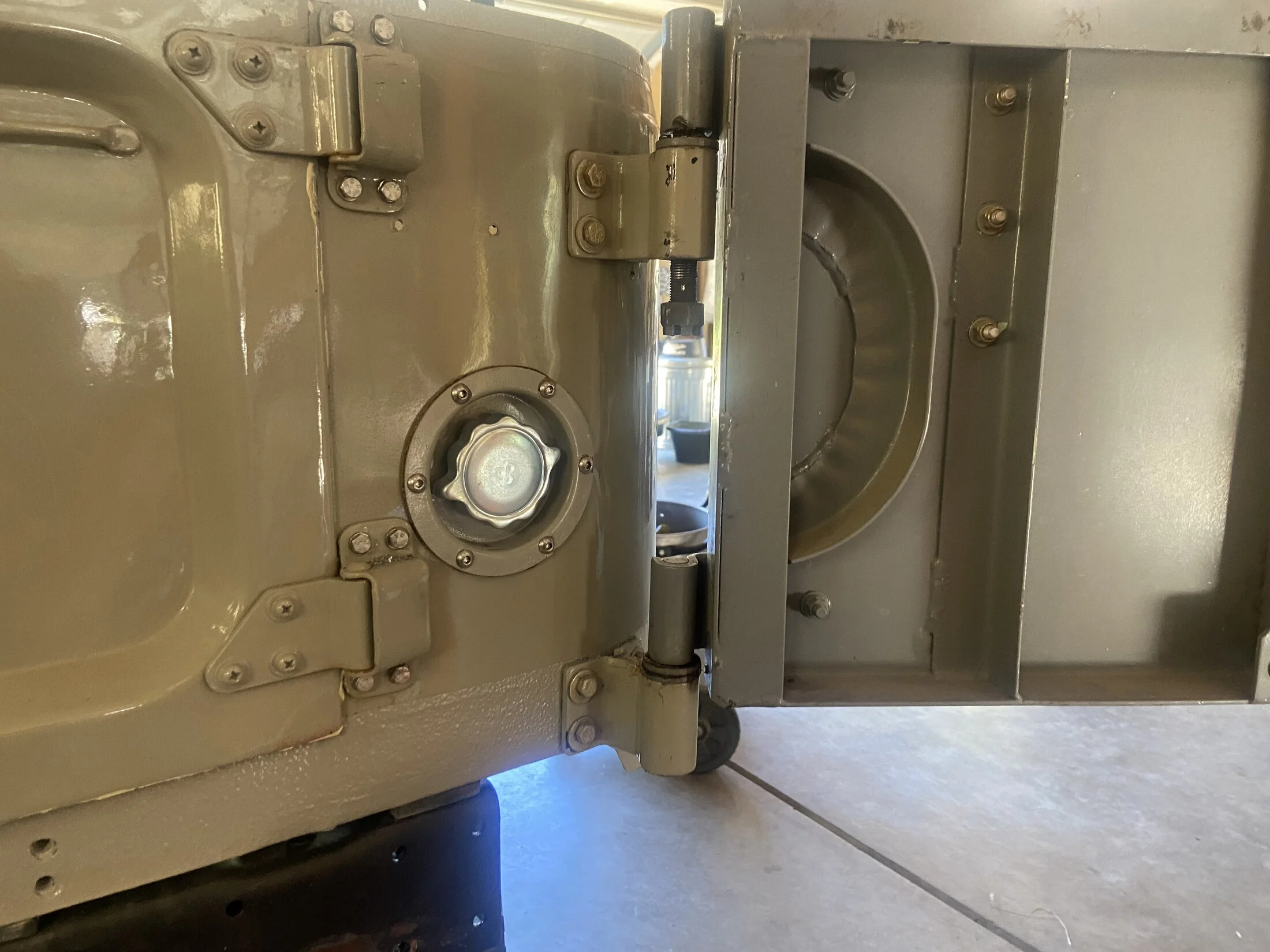

Evidently I will not be making more rear fuel cells in the future, can't find a Roto Molder willing to use my heavy steel mold, Sooooo I then have several filler neck panels like that shown in post #9 above, 6 bolts into the body, can sell, lemme know ???

So I dug into this in more detail over the last few days. It turns out the vent for the tank was capped off. The filler hose between the inlet and the tank was also kind of a mess. I redid everything, hopefully it will make it a lot better.
Fixing the vent will help a lot, as will making the run as straight as possible with fewer bends. But I always had trouble filling my aux tank because there isn't enough angle from the filler to the tank to allow the fuel to flow fast enough, so I always filled at half speed so gas wouldn't come spitting back out.

I can confirm that the changes I made improved things quite a bit. I was able to put several gallons in about half speed on the pump. Good enough.
