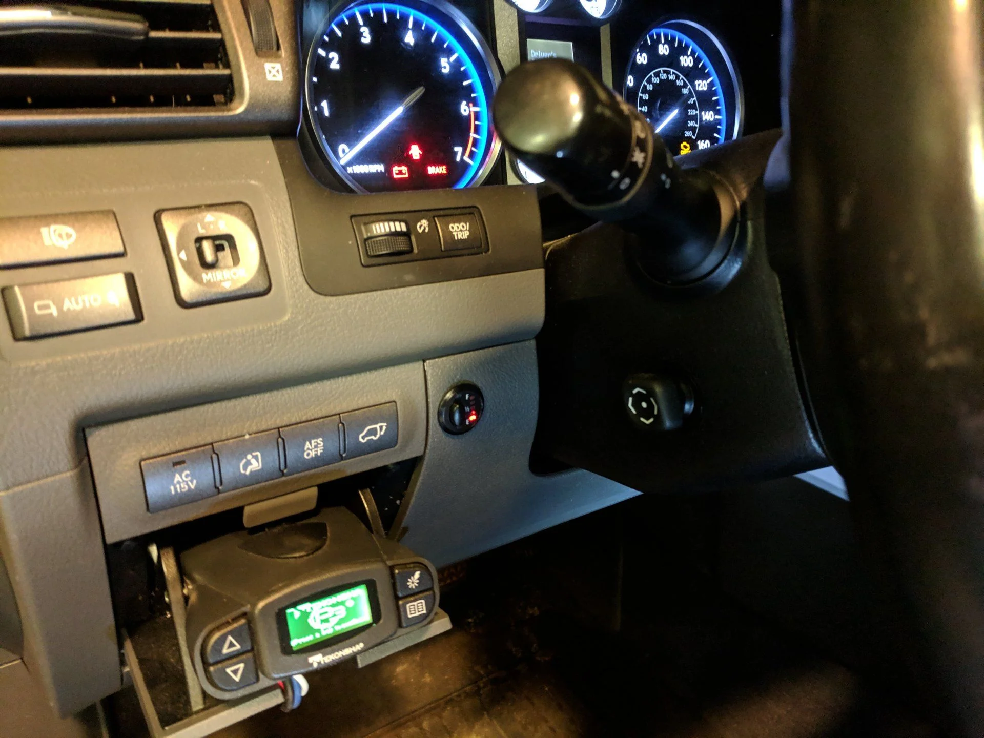

No light other than the LEDs within the button unit. As I’ve mentioned before...you CAN use a faster pump, but in my case it required a bit of electrical fiddling by Valley Hybrids as voltage draw was different. I’d suggest talking with Georg if that’s something you wish to do. I ordered my own pump version and they installed using it...instead of the slower standard unit.
yeah that is what I mean. I have no Led's on mine. So can't see it at night or the gauge. I was told they forgot to include the led light and Ward was sending it. But it's been several months. Guess I need to follow up myself with Ward. Easy thing for those guys to forget. Thanks for the info.
Jim
Actually it seems like the Led's would be attached to the unit. Anyone know. Maybe my mechanic goofed up and the LED's are in there?
Are the LED's supposed to be already attached to the button?
Jim
Just call them or call Georg at Valley Hybrids.
You definitely want the LEDs! Would drive me nuts being unable to monitor as it not only indicates an active pump, empty-beep...but also has four additional LEDs to indicate tank level in 1/4tank increments.
The only thing I have with my 12.5 is the single integrated controller with pump switch, fill level readout, and all lighting integrated.
yep....sounds like mine is just not hooked up correctly or else is defective. Thanks a lot for the pic. I think mine was just defective. The guy that installed mine knows what he's doing.
