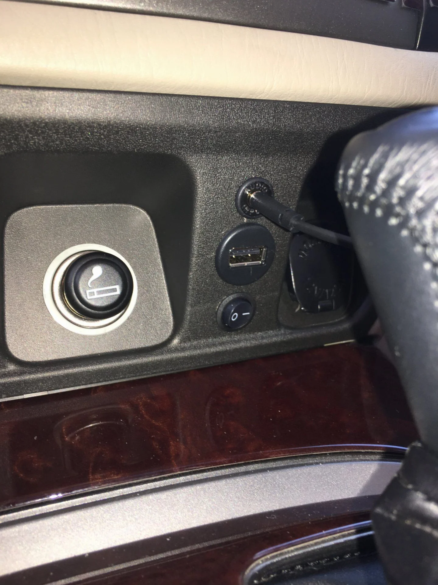

Thanks for all your help. I ended up going the ole Best Buy way. Bought a tranzit USB is32 and had them install it. Sound quality is good and looks stock IMO
Looks good. Mind if I ask details and pricing?
It is a tranzit USB is32. It cost me around $150 at Best Buy and that included installation cost. I talked to the installer about where to put it and we decided it would look best in between the 12 volt and the cigarette lighter. It works through the radio so you put the radio on the required station and turn it on, and you can play your music! Any other questions I can help with.

Anyone know how to get this to work? This aux cord was installed before I purchased my '06 from a dealership, and they didn't know how it worked.
If it's anything like the Grom TOYNA1 I just installed, simply put the stereo on disc, plug in your phone (or whatever you plan to use) and it should just work... maybe the 3.5mm cable is disconnected somewhere behind the dash if you're not getting any sound?
BTW, for anyone else simply looking for an AUX input, as I was, the Grom TOYNA1 works wonderfully. Super easy to install and the unit is extremely small and fits easily behind the navi unit.
As soon as I put the stereo on Disc, it begins playing the 6 disc changer, and nothing comes through the aux. I tried removing the 6 disc cartridge from the center console, but still nothing through the aux. I'll check behind the dash and see if it's disconnected.
try scanning radio stations while your aux is playing.
