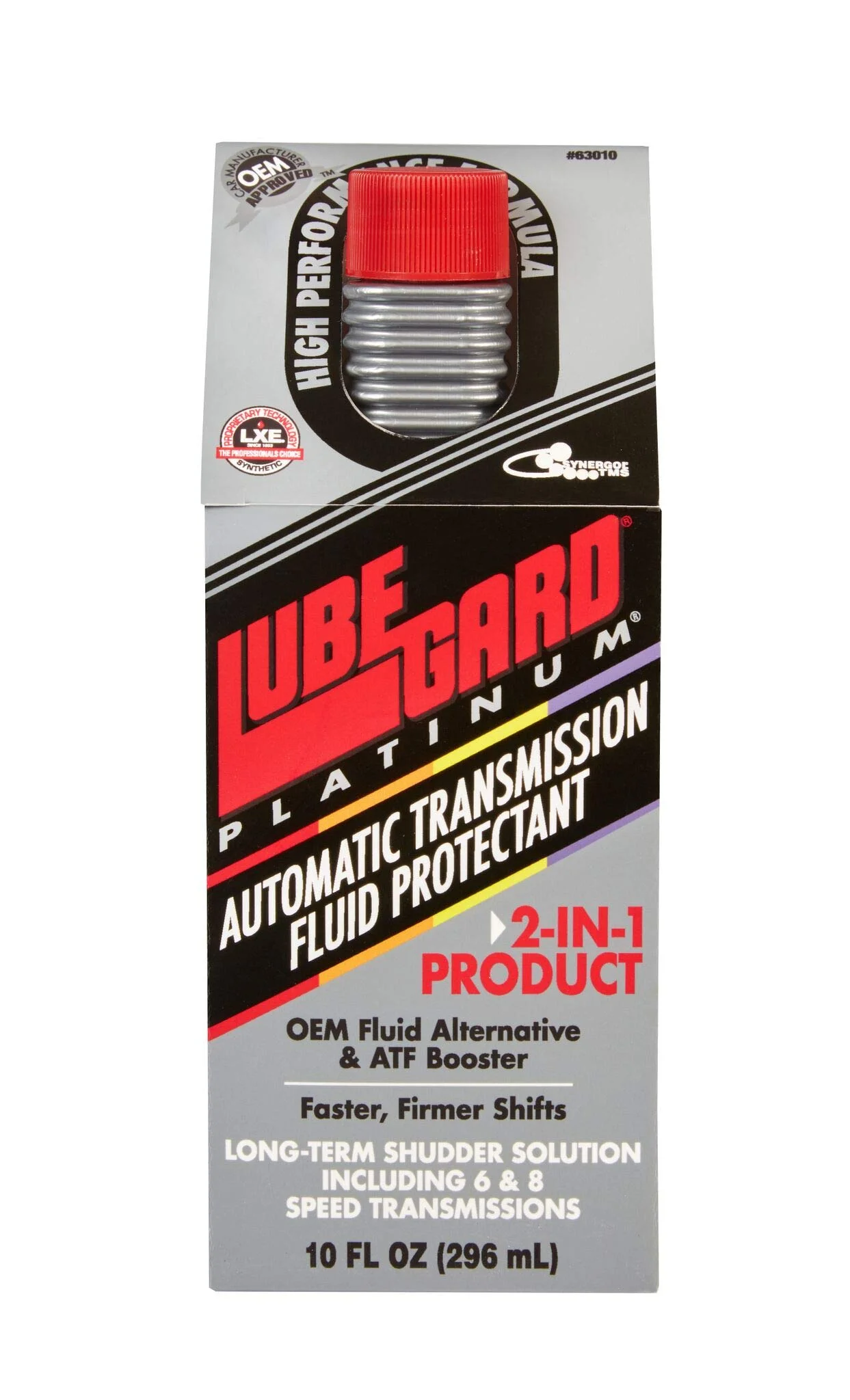

I've been seeing a lot of threads where people have use an Additive called Lubeguard and Instant Shudder Fix mixed together.
It supposedly makes the transmission shifts smoother.
Has anybody ever used it on their 80 series?
I'll upload a picture of the product
Shouldn't be needed, is your transmission acting up or doing something weird.
Its does not shift as smooth as I'd like to. Does not do anything weird, it shiftes as it should. But i was just wondering of someone has used it this in their vehicle
do a drain / refill of the fluid, maybe a couple of times over a month or so
ive used shudderfix in a GM transmission and yes it did solve the TC shudder

I would not add the shudder fix or the additive, IME they can make things worse, at least in the A343F transmission.
There is a LubeGard product IME that can help clean up a transmission if used correctly, it's their Transmission Flush product.
Just follow the directions, but if your transmission fluid is clean it's probably not needed.
Do not use any transmission flush/cleaner unless you follow that up by replacing ALL the transmission fluid. IMO.

I have used Lubegard Platinum in mine, I use this on all my ATFs for years.
