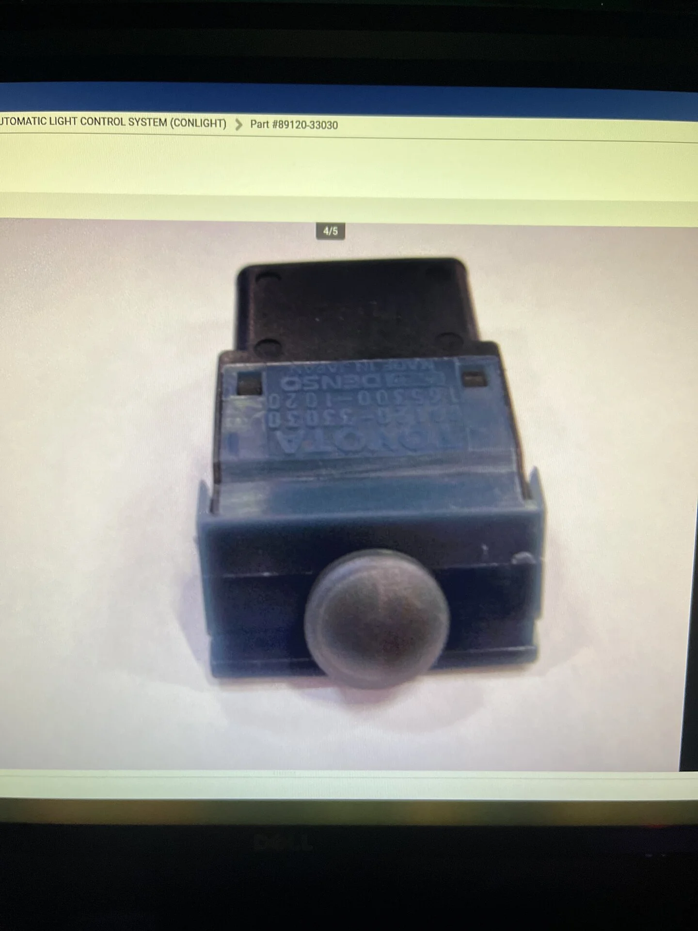

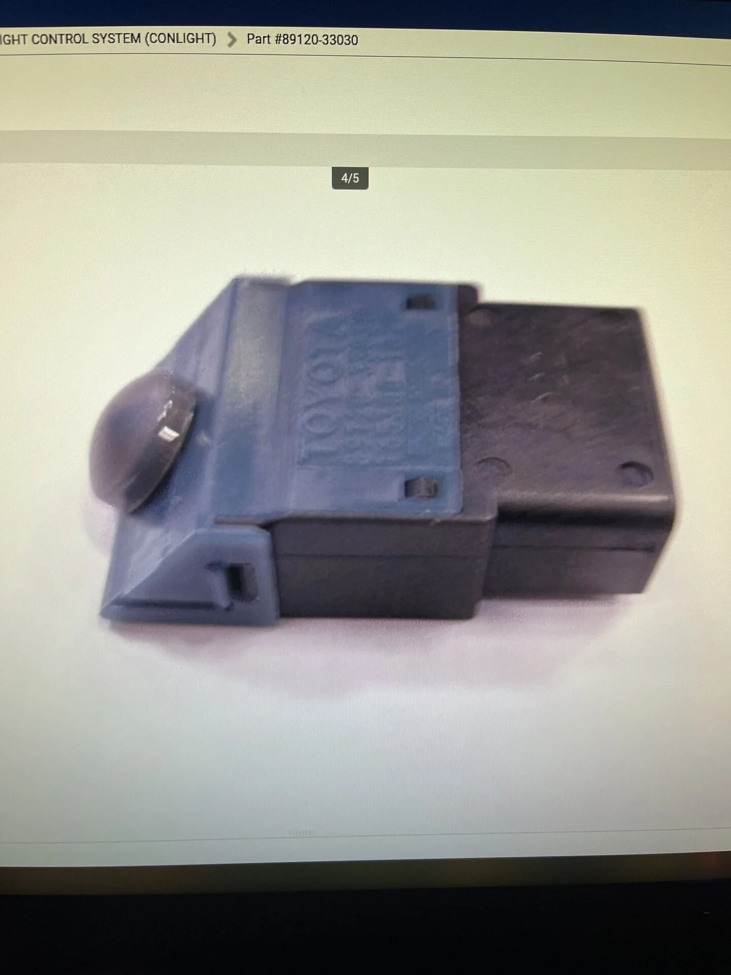

Picture I got from my Toyota SnaponEPC, no visible knob, so yes I believe it means turn the sensor itself to adjust sensitivity
Just went out to the garage and the one in my '04 definitely does NOT turn.
As mentioned earlier, part # (89121-30010) is different on a 2004. Part looks different too (post #8) on the 2004
Post #5 is what the part (89120-33030) looks like on a 2001
So unfortunately this only works for a 98-03. Part # remains the same on a '03 (89120-33030)
Ahh, found out why
Part number (89121-30010) and part itself is different than a ‘01

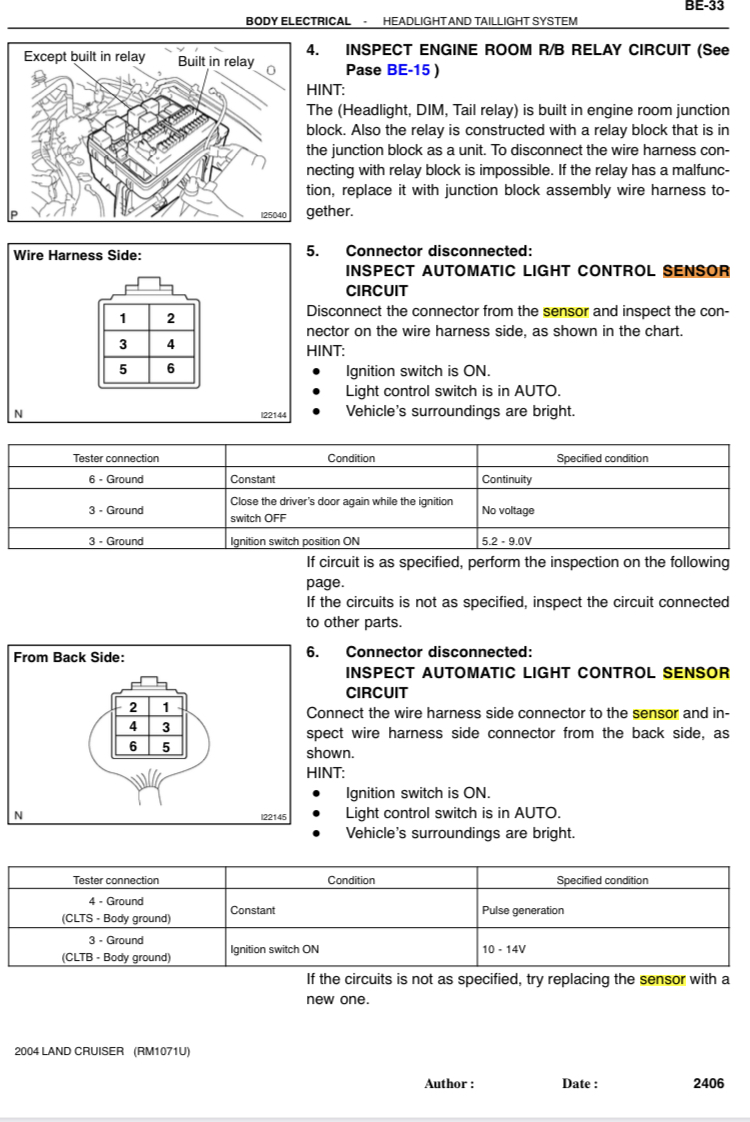

I think the part you pulled up for the 2004 is a light sensor for the HVAC system. I have that sensor on the left side of the dash and the auto headlight sensor is on the right.

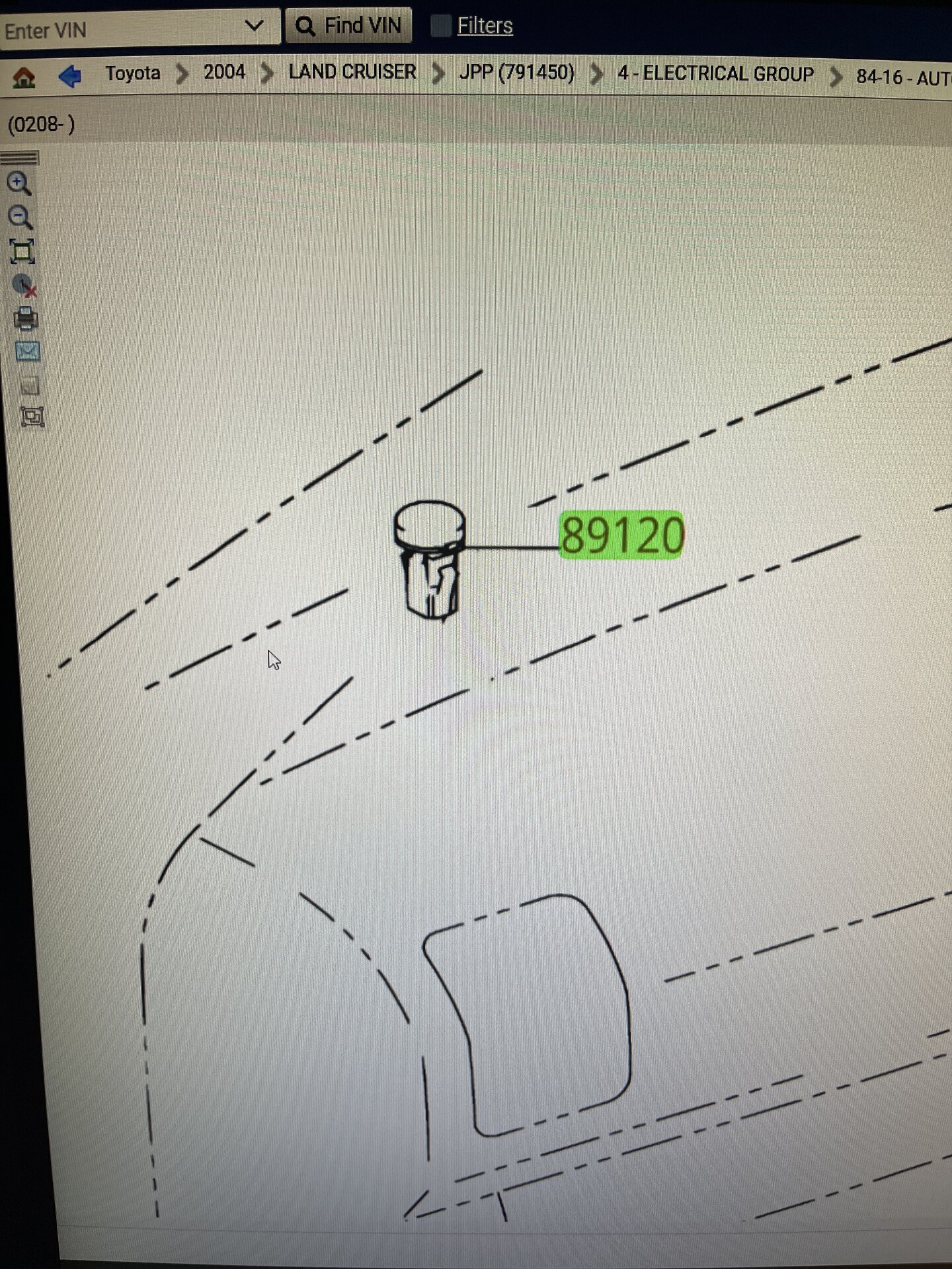

No, I’m almost certain that is the headlight sensor. Not to sound like a braggart but I work for Toyota parts dept. I have immediate resources to look these parts up without having to scour online.
I do see what you mean though, because on the parts diagram it shows the sensor on the driver side when we all know it’s on the passenger side. Story of my life with these parts diagram when I’m helping a tech.
