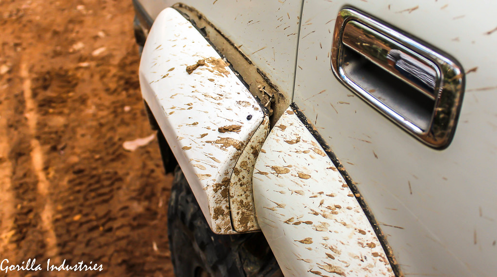

Hit lithgow last weekend for some Camping and again my compressor for the lockers didnt work, but this time I needed them. Got suck and damaged a rim, two flares and my ego haha.
