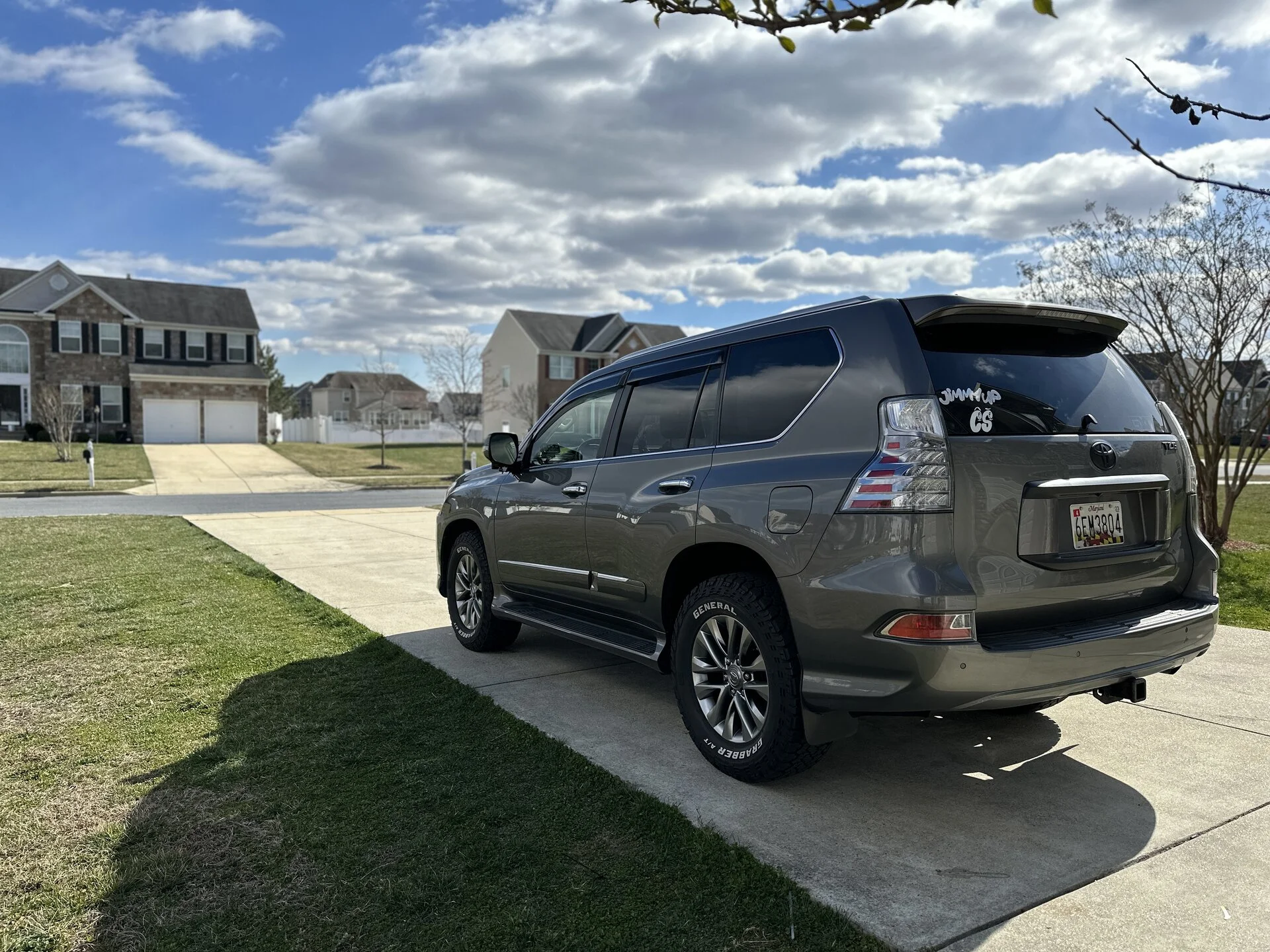

Haven’t done much in a while but did rebadge and wax the GX
it was nice today so just dropping some random progress pics haven’t done much lately just painted the chrome in the rear and replaced the toyota badge with the one from the actual prado still debating if i want to drop 200 on the Land Cruiser Prado trim piece

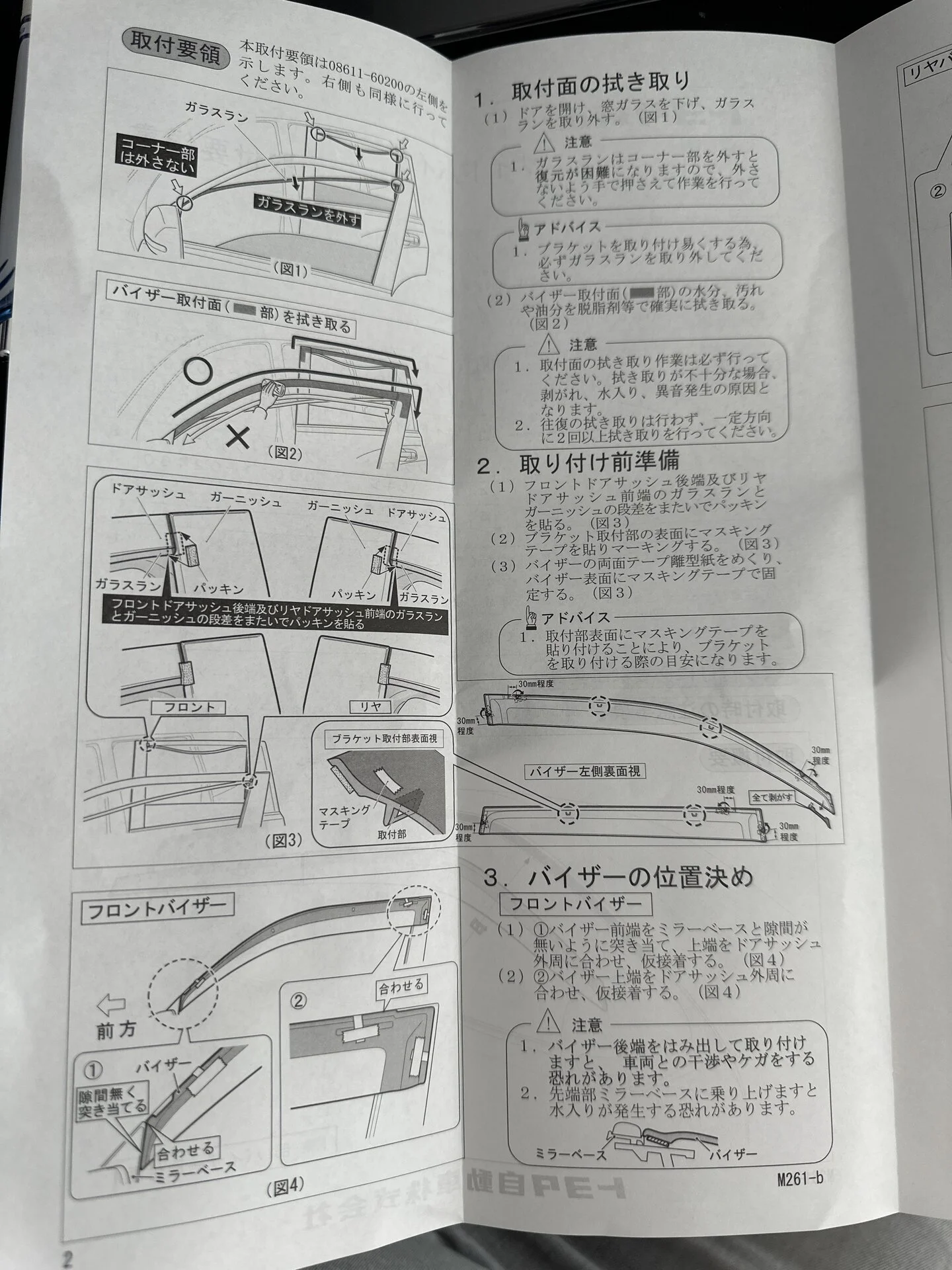

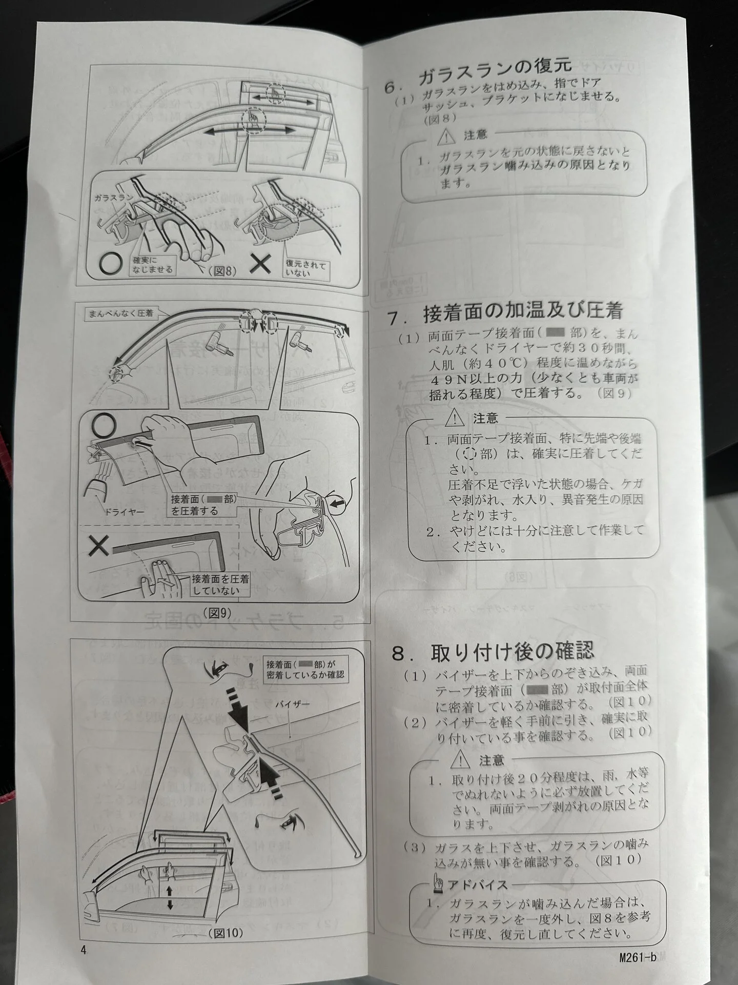

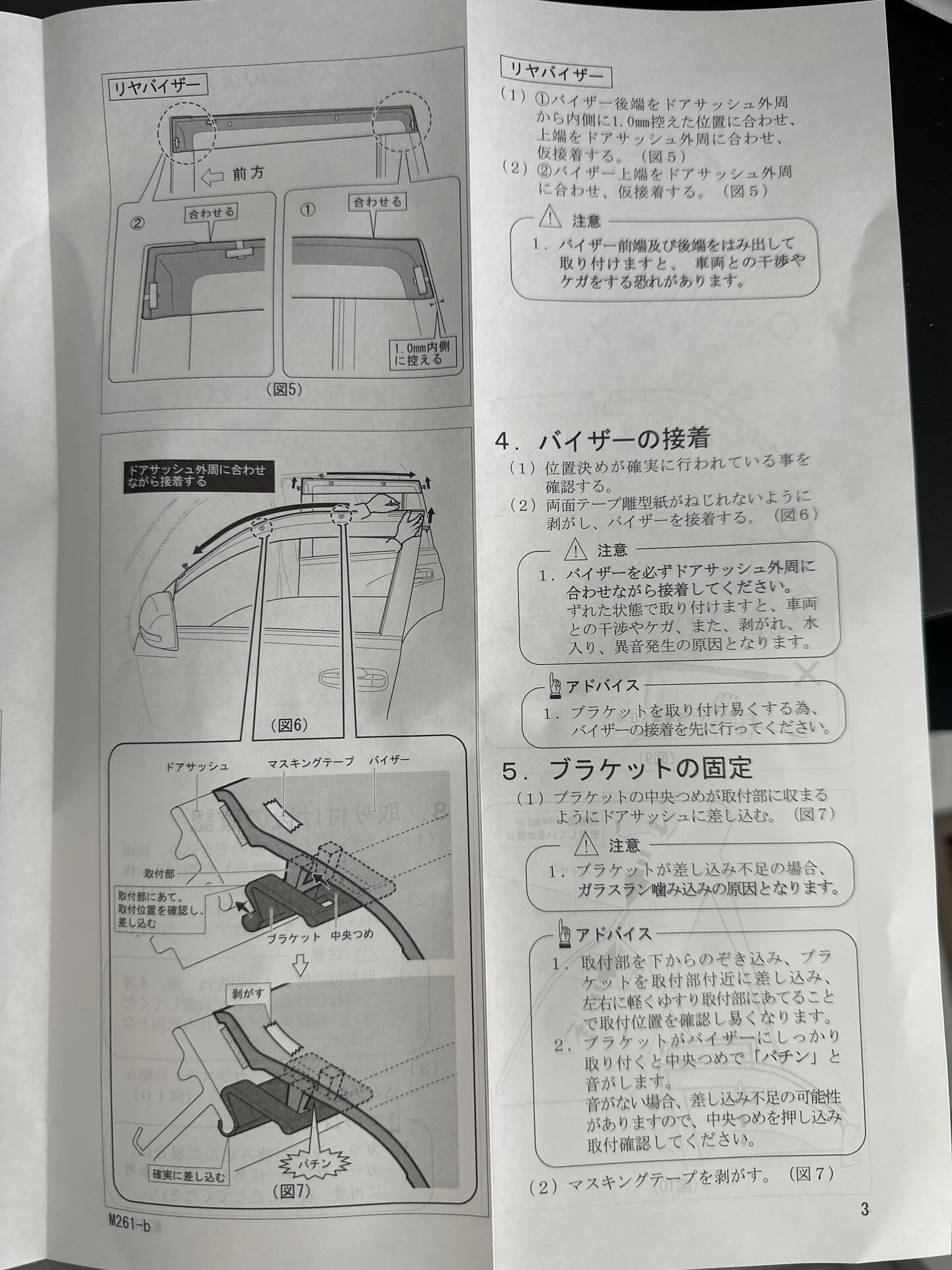

my prado window visors should be arriving today

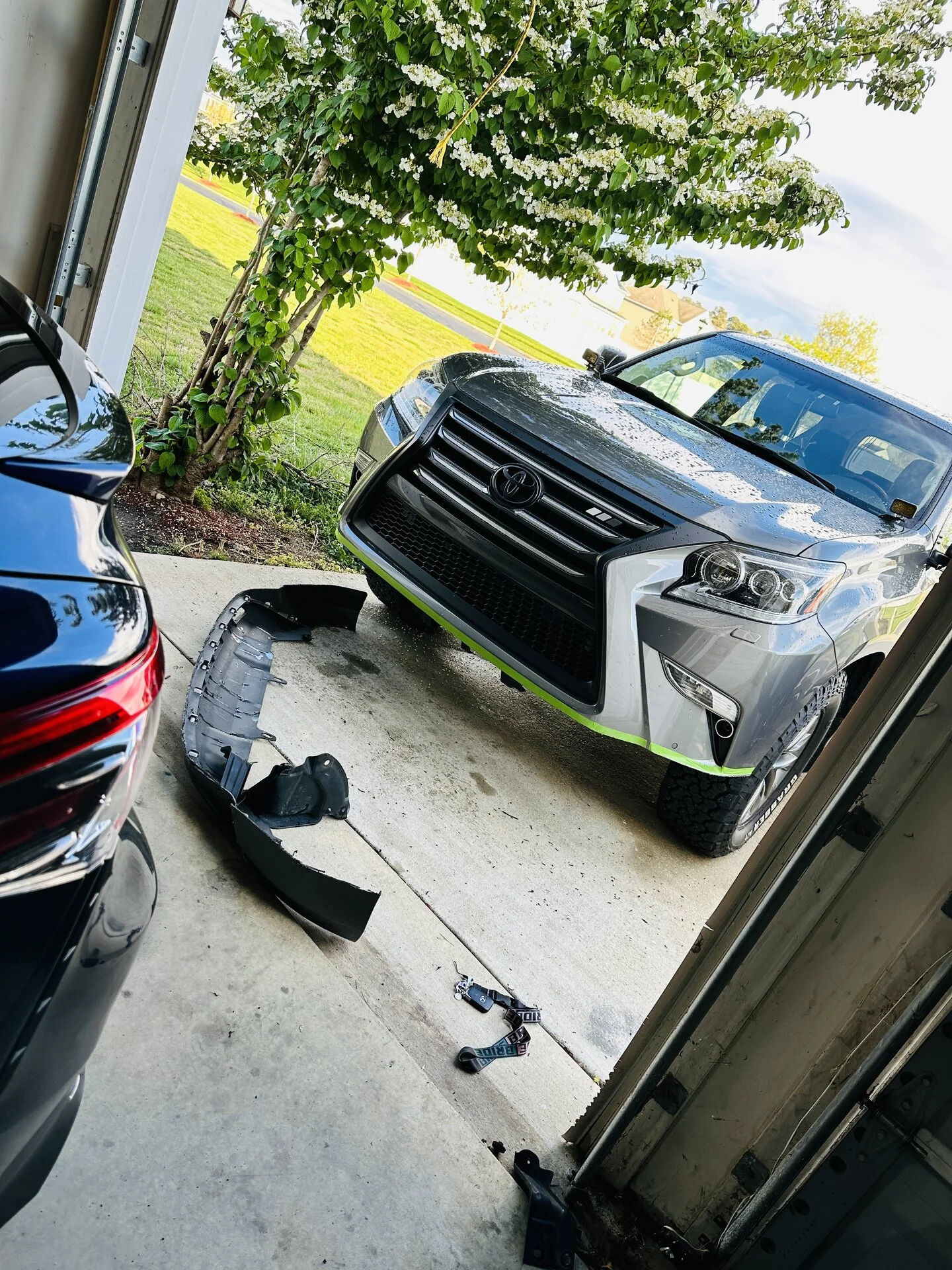

went through with the bumper cut today, i was really back and forth with it but once i got the first cut in there was no turning back. I still need to cut the brackets off the bumper reinforcement tomorrow when i get a new wheel for my cut off
Trim comes in tomorrow to clean up the cuts and i’ll post a better pic
Get a cheap surform plane and that will very nicely clean up any bobbles and wobbles in your cut line.

You don’t need to cut those brackets off, just a few swings of a hammer and the rivets will break loose. Way cleaner than cutting, quicker (maybe?), and you could always put them back on. When I removed the lower valence cover I was hesitant to remove the brackets, just in case I wanted to put it back on. I don’t think I ever would, but not just cutting them off affords me that option.
