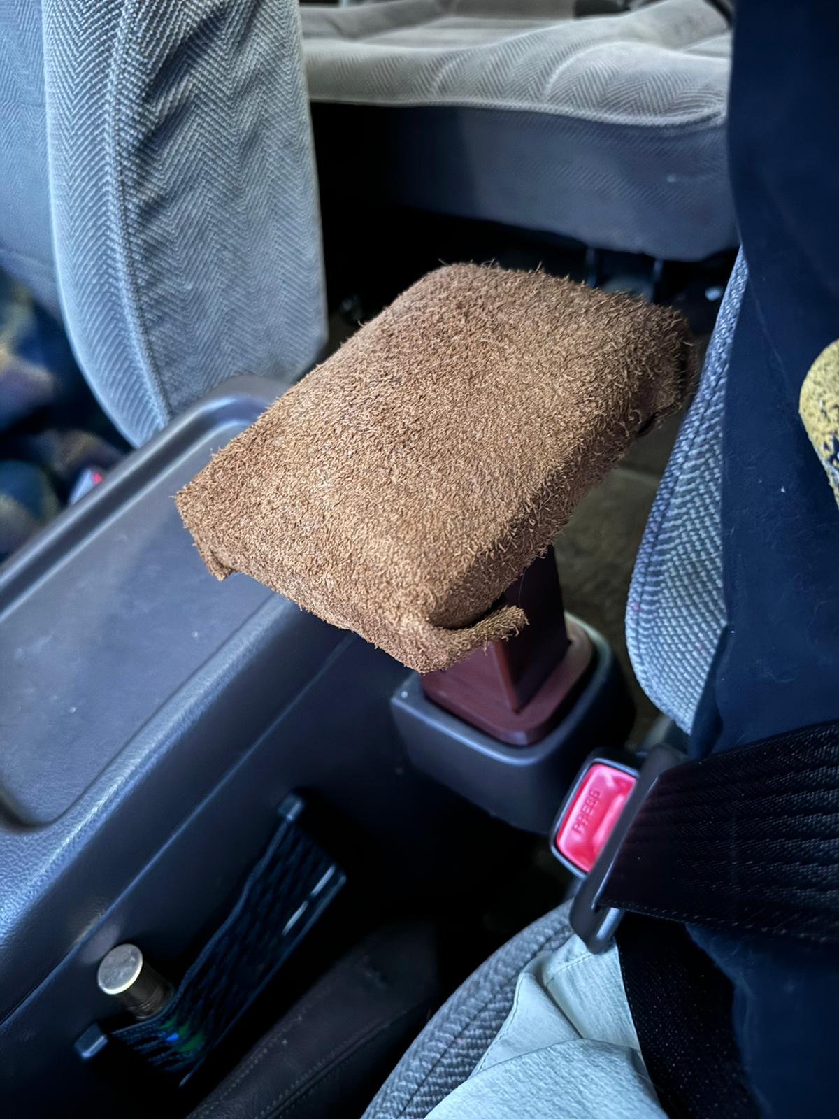

Sorry for the massive delay in getting these posted. I had to redesign and reprint, then I had a sock on it for a while before I got the leather. But here it is in its current form.
I am still using it as pictured. It works well. I am pretty sure this is it: https://www.amazon.com/Dimeani-Armrest-Organizer-Organizers-Adjustable/dp/B0BHZLL1V5/?tag=ihco-20
