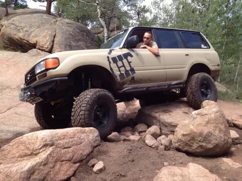

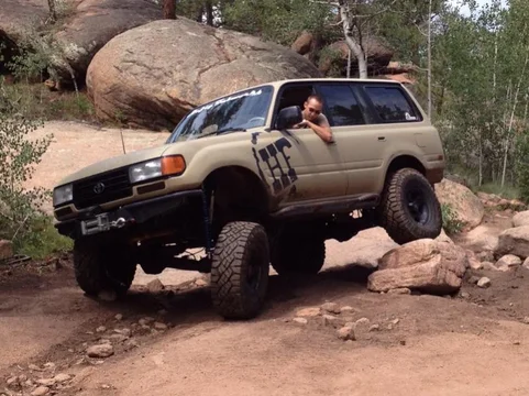

Well I finally got 'er flexed...
The outer edge of the tire is about 3-4" below the rock slider.
About 1# of up travel left in the shock.
I forgot to measure how much droop was left.
No binding at all.
Another 2-3" of up travel available in the rear too.
Overall, I'm very pleased. The front and rear are much more balanced than they were previously. Additionally, the truck was solid as a rock even while flexed. normally the truck was very unstable while flexed, but now I was trying to shake it and it wouldn't move at all.
OME Standard height
:steer::cheers:

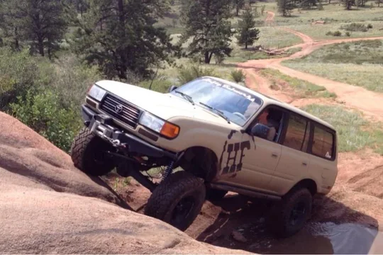

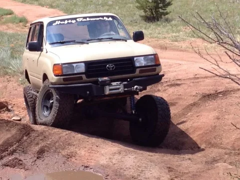

A few photos from last weeks trip. Nothing extreme as I have no money and we went alone. Everything worked very well and the truck was quite stable. These were the only times the wife was willing to get out and take photos(she has too much fun riding)...
That is so awesome. Nice work!
