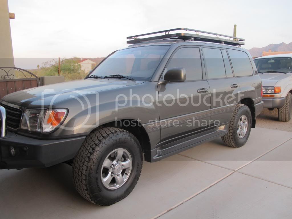

I purchased and had installed an ARB Sahara bar on my 2001 a mere 7 years ago :) It was installed by a reputable local ARB dealer. After the install, I never gave it a second thought and I never scrutinized the install to check for fine fitment etc.
Fast forward to yesterday. I had a local body shop guy pull off the ARB to have it painted and moved to a different 100. After taking it off, it revealed score line in the paint all around the truck. I was not there at time of removal so I don't know exactly which part of the ARB bar was pressing against the truck.
I couple of pics below, one with bumper and one showing the scratch.

You are right I can't be certain that no one has bumped me, but given there is not a spec of evidence on the bumper, nary a paint rub off, doubt it. Plus the scratch around the land cruiser is much too symmetrical and even in my opinion, with no denting at all, to be caused by the bumper being bumped by someone.
