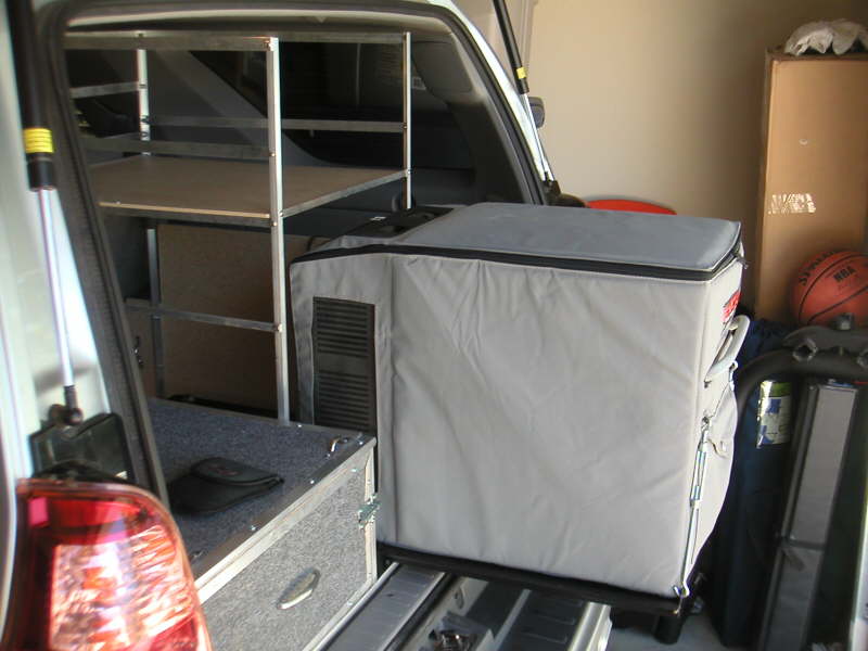

I got the fridge slide from Slee for the Engel fridge. It make it real handy as you can slide it out to gain access and use the space on top for soemthing else. It also slides back and mounts securely. Defintely something worthwhile to consider when getting a fridge.
Here is a pic of the drawer and slide in my 4R.
