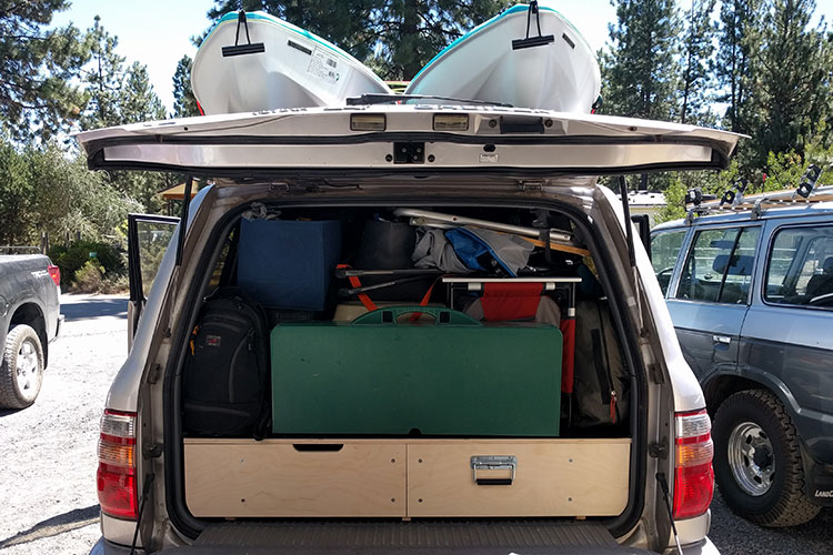

A HUGE plus for drawers (IMHO) is that you will have your gear when you need it, not just when you remember to put back in a bag or box. They secure your gear safely and give you near-instant access to your fire extinguisher, medical bag, flares, or even bottles of water in the midst of a trip:
(early prototype, ignore the different handles)
No bin or box system will give you as easy access as drawers.
The slide system you choose can have a big impact on space, like mentioned above, so consider as you design. Traditional slides eat up 3/4" each side, so x4 = 3" of usable space, multiplied by the length and height, well, I calc'd it at 74 liters of space - not trivial.
As for weight, I think a 5000lb cruiser that can carry 1000 lb of gear without dropping an extra gear can handle drawers. But do consider once you have them you WILL put stuff in them, so it really is the drawers+their contents. YMMV.
Final note on needing to take big stuff, I have not in a year had one instance where mine were a problem for taking anything I needed. And actually the drawer height matching the folded down seats has made it easier to take some large stuff, not less so. Also, I find it easier to load the truck at the store by only having to open the hatch, and the drawer tops are a couple inches below the tailgate lip so less bending over to load and unload - a benefit I never expected. FWIW my wife was pretty meh on drawers as I built mine but a year later agrees- their utility is so outstanding we'll never go without drawers again.
But that's just opinion #101 :cheers:
