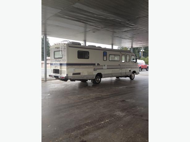

Nick, might sound crazy, get a class C and tow the 78.
That's hilarious Jon!! Haha. Maybe a diesel pusher something like this eh? (joking) http://www.usedvictoria.com/classified-ad/1992-38-Cummins-Diesel-Motorhome_23017559
Mid 90's Ford V10. I have relatives who tow to Jeep jamboree in Moab every year with it. Gets about the same mileage
as you do towing I expect.
Really? You're saying Ford's triton V10 moves a Class C rig and a tow vehicle for 15-17mpg (imp)? Thats pretty good if so. I would have thought something more like 5-12mpg.
