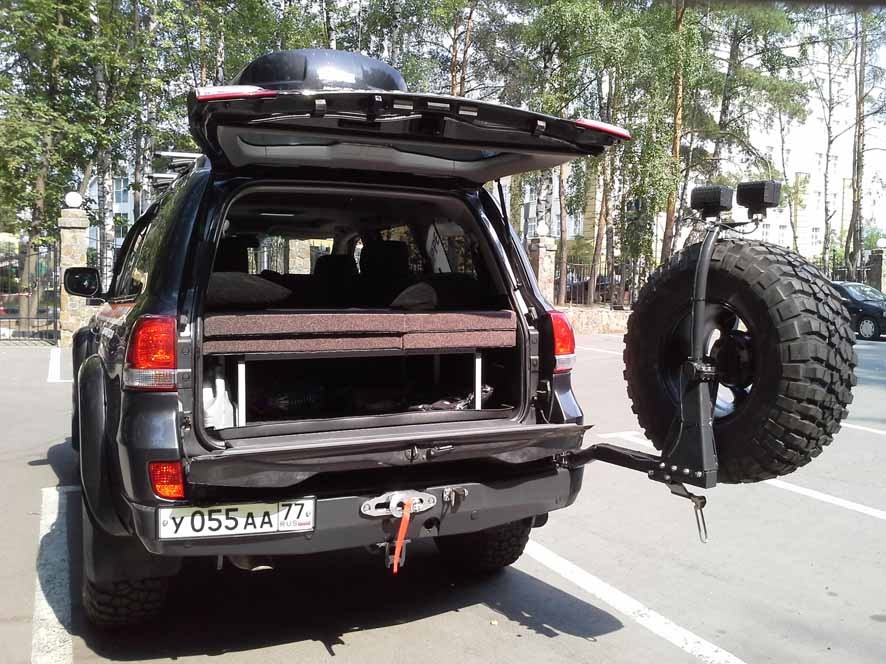

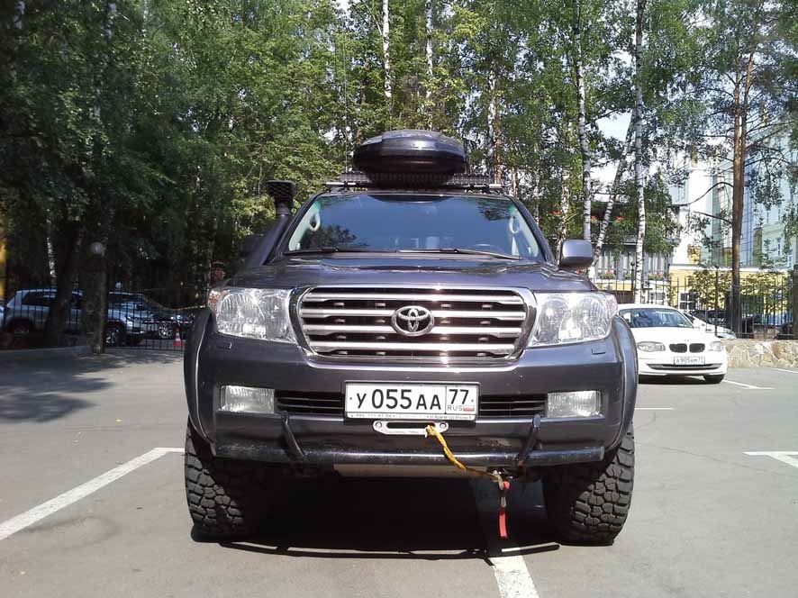

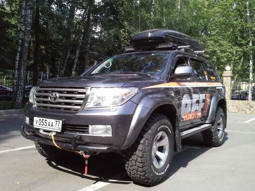

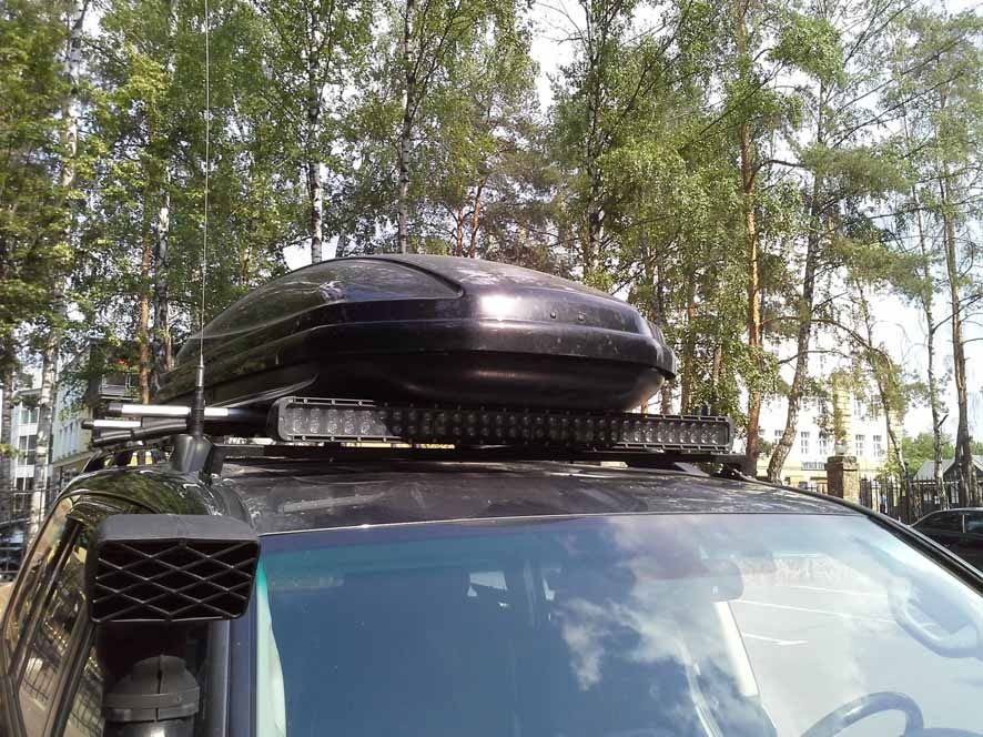

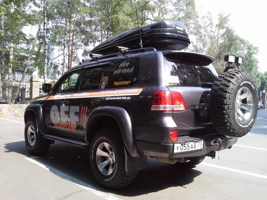

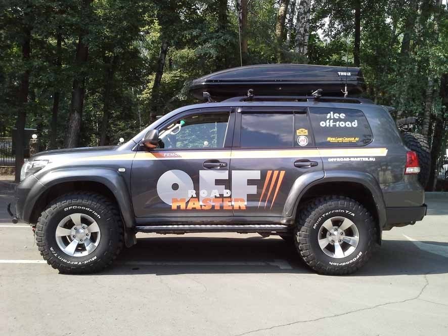

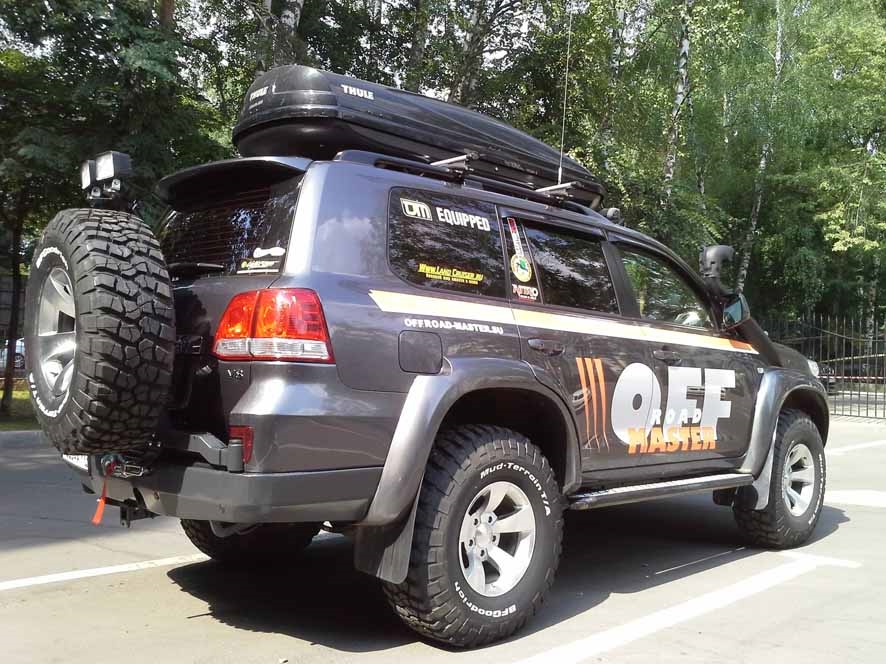

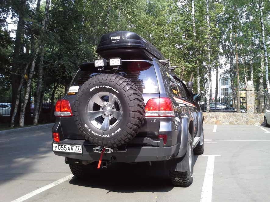

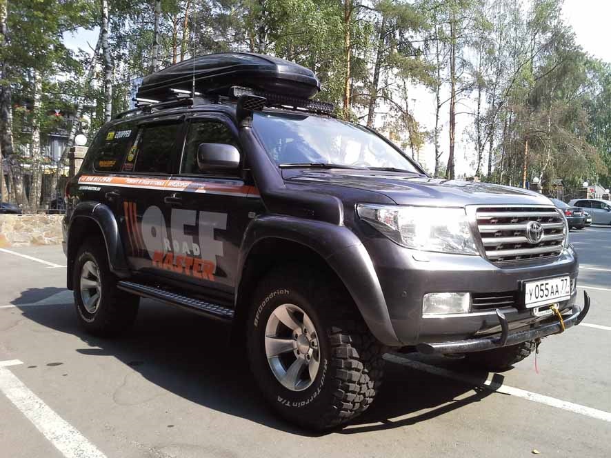

They dont say a whole ton of useful stuff in that video. If you do a search for 200 на колесах 37" you can get some results such as this..
Продается TLC200, на 37-х колесах, 4 000 000 руб.
below translated by google with some fixes by me.. emphasis mine
Sale of unique car, unique for Russia, no!
This off-road expedition vehicle premium built on 200 TD 2010g.v TLC. in 2013. For the base was taken dealership Land Cruiser 200 2010g.v. with an 8-cylinder turbo-diesel engine, 6-speed automatic transmission and the mileage to 41,000km in perfect condition, being still under warranty (warranty expiration date 10.2013), no accidents and other problems. Car Modification took six months, was carried out high-end professionals, using the best components. And so, on the car have been established and developed the following details:
1. Shock absorber Tough Dog firms increased stroke + 50mm (suspension lift)
2. Springs elongated firms Tough Dog + 50mm (suspension lift)
3. Spacers kopralonovye + 60mm (between the body and the frame / body elevator)
4. Brake hoses reinforced lengthened
5. Transfer of the radiator (in connection with the lift of the body)
6. Replacement KDSS system for established anti-roll bars
7. Replacement of regular Main Steam in gear on the main pair of firm Nitros (USA) with a ratio of 4.88 (compensating larger wheels)
8. Install locks the front and rear axles and the ARB compressor company
9. Completion wheel arches
10.Dorabotka body pillows
11.Ustanovka arch extensions Arctic Trucks (Iceland)
12.Wheel size 17h10 and departure -8mm 5pcs. Arctic Trucks (Iceland)
13.Tires 37h12.5 R17 BF Goodrich MT KM2 5pcs
14.Shnorkel Safari (sealed)
15.Sapuny bridges, Automatic, Manual transmission withdrawn under the hood
16.Winch front T-Max 12,500 (+ control) and its installation + Kevlar rope Dextron and fairlead
17.Ustanovka protective power tube front (can be lifted car hi-jack)
18.Winch back Sportway 12,500 (+ control) and its installation
19.Zadny power bumper gate under the spare tire, tow bar, the holder of the hi-jack
20.Silovye thresholds
21.Armor bottom
22.Perednyaya LED chandelier
23.Zadnyaya LED chandelier
24.Bagazhnik Thule maximum volume

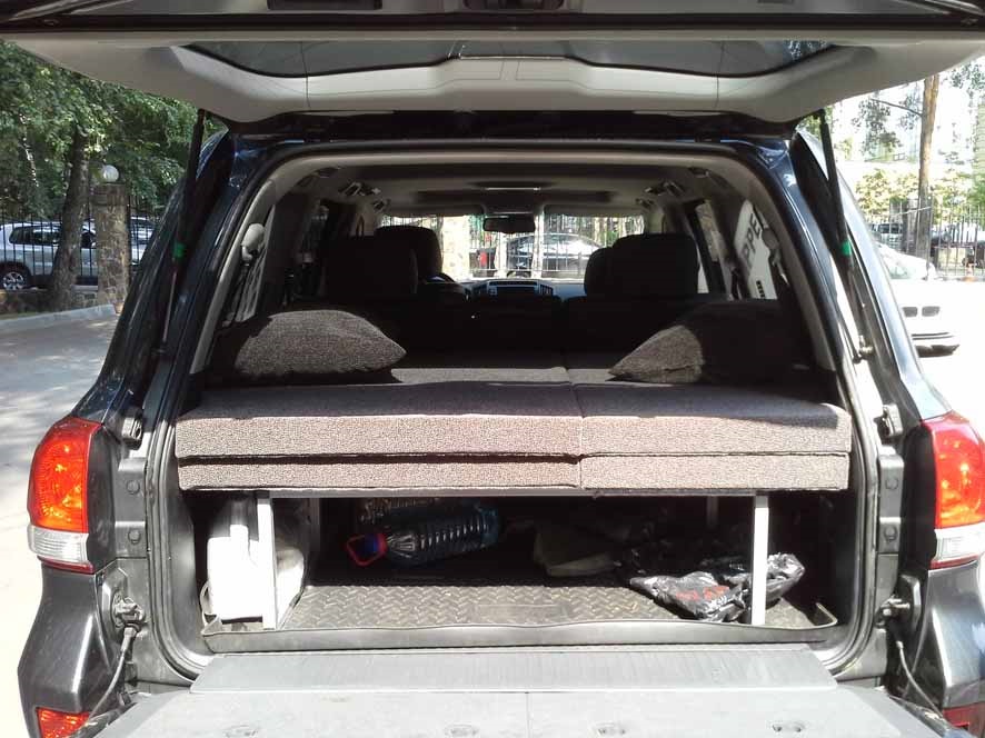

25.Spalny podium
26.Ratsiya Security Megajet (modified and installed by specialists)
27.Ratsiya UHF Yaesu (modified and installed by specialists)
28.Kompressor stationary receiver with T-Max
29.Dopolnitelny fuel tank capacity of 180 liters
30.Noise/ hydro insulation
Focal 31.Akustika
32.Chip 300+ hp engine tuning and a torque of 800+ NM
33.Xenon headlamps and PTF
34.Full TO (replacing all fluids, filters, pads, shpritsovka and suspension and chassis diagnostics)
The car perfectly controlled and moves around the track, cruising speed of 140km / h, acceleration from space - cosmic. On terrain of equal little. This car is ready for any challenge, no matter where the owner takes it, fast, comfortable, reliable; and even a meeting with respectable people to come on it is not a shame.
Since the construction of 2,000km run on Moscow (dirt is not seen). Excellent condition, any test in any specified by you service at your expense. Stickers with the body removed.

I see he has a second winch on the rear bumper. Haven't seen a rear winch bumper like that on a 200 before.

But it is quite similar to Arctic trcucks mod. That guys do 2'' lift and cut off lots off wheel arc. We have such lc200 and lcPrado in our town on 35-37''
