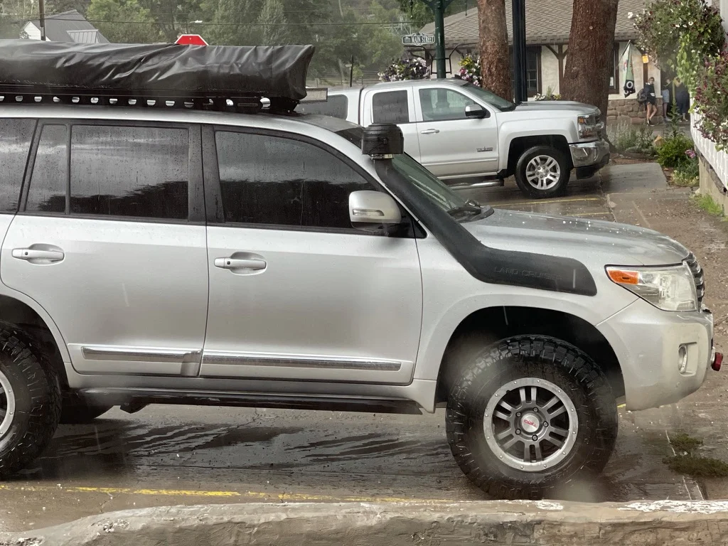

Yes, I had the snorkel at the time of that posting but I have not installed an awning. I did speak extensively with a guy with quick pitch about mounting one and it would take some fab and fitment work to make it all work without issue depending on the overall length of the awning when closed. According to him, the standard side mounting wouldn’t be enough to properly secure that particular awning, there would need to be some type of mount along the back of the rack.
All this to say that it is possible to mount on the snorkel side depending on how much effort you want to go through. I can tell you that the closed length of the awning you mentioned is 7’6” and the measurement from the intake of my snorkel to the back of my roof rack is 8 feet.
Let me know if you need any pics or measurements, I’m more than happy to supply them.

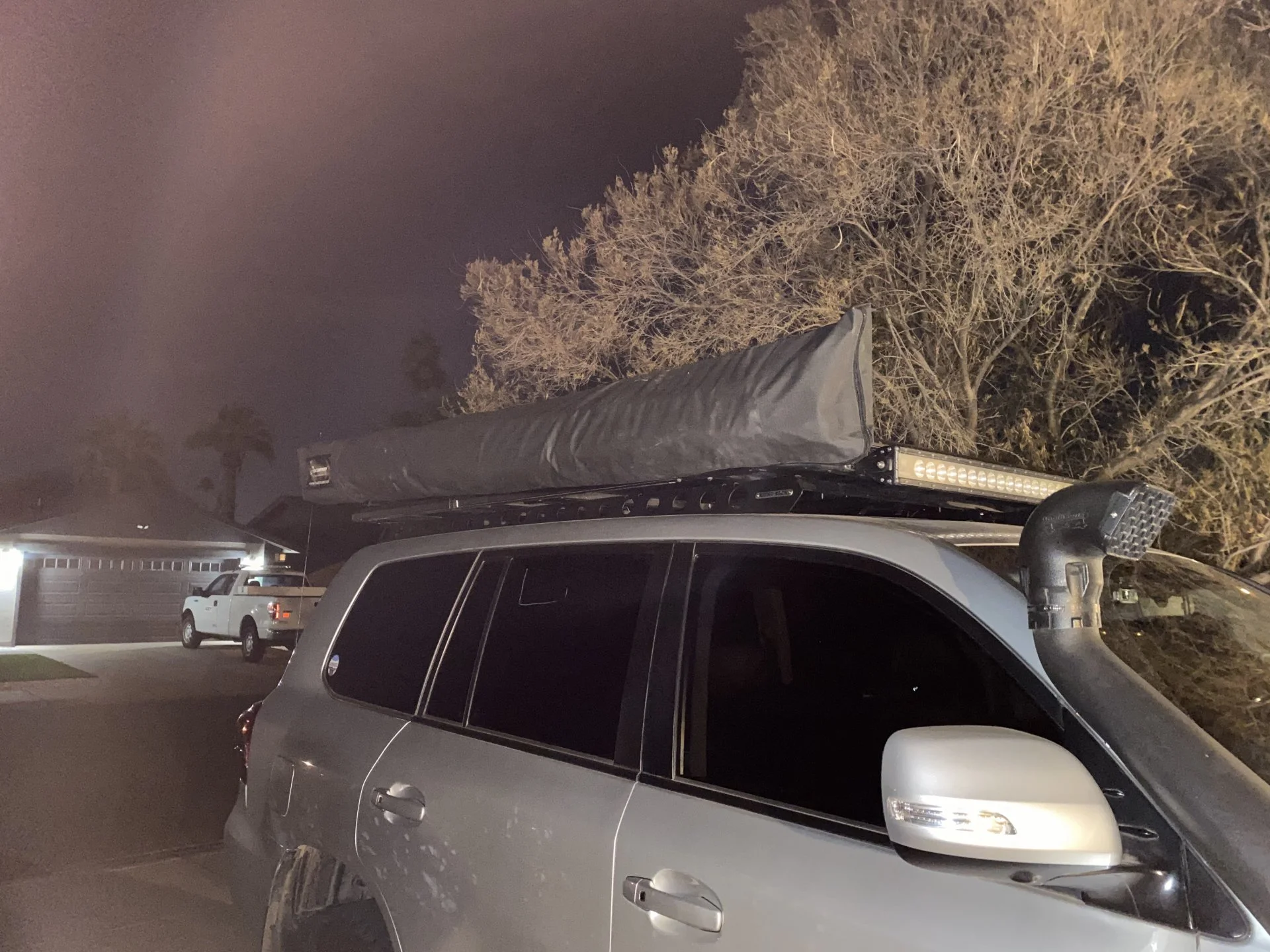

Yes, it's very close - maybe 3/16-1/4" gap between the rack and snorkel. I run my awning on the driver's side.
Let me know if you want pics of the rack/snorkel area

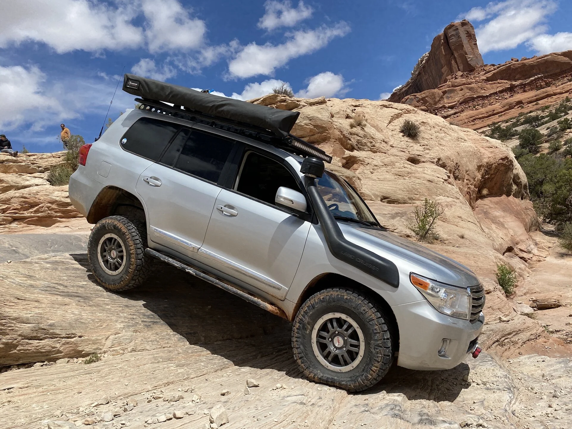

Hey @Artie and @radman can you send me or post a few pics of the FF snorkel and Dissent RR? Especially from the side. I'm getting back to this but haven't installed my snorkel or the RR yet on my new rig. I think I've convinced myself that the 270 XT Max can go on the passenger side and won't interfere with the FF snorkel. This pic of @TheGrrrrr 's rig seems to show that the 90" (7'6") mounted awning sits back far enough to not be in the way even with the the FF snorkel coming up to the corner of the Dissent rack.

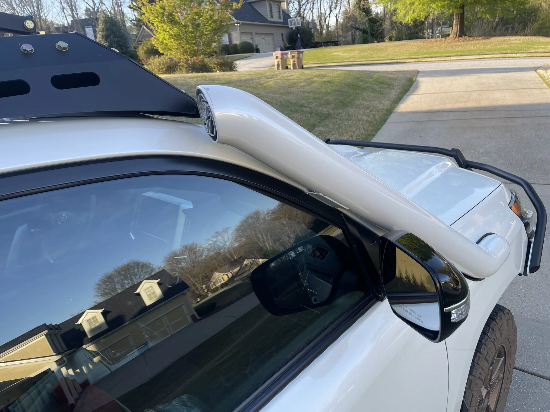

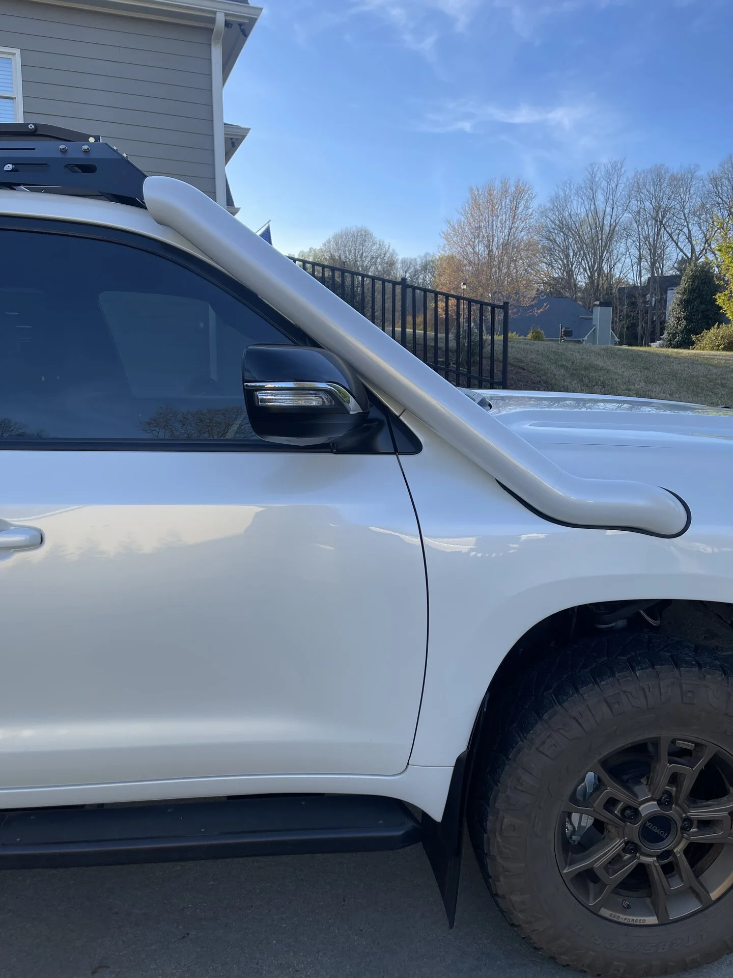

Here are a few. You caught me at a good time, I just pulled it outside. Let me know if you need any other ones.
Thanks. Did you notch the corner of the Dissent rack to clear the snorkel?
The shop that installed it did notch it, it is depicted in that top down picture. Hard to say if it was necessary or not but that tiny space came in clutch the time I had to remove the snorkel for the xpel wrap.
Dang. There's not much play when you install the FF (few 16ths here or there when you install the nutsert), but shouldnt need to cut the rack.
