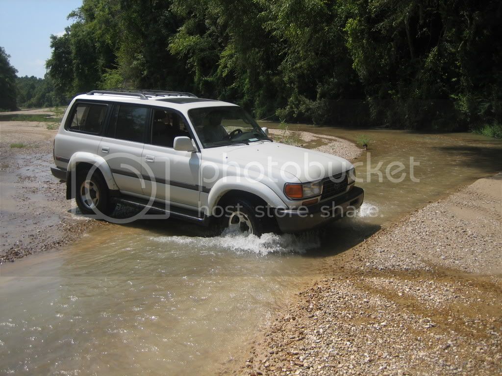

275 revos bone stock to compare. I think I'll be unhappy when I install my 2.5 " lift this month.

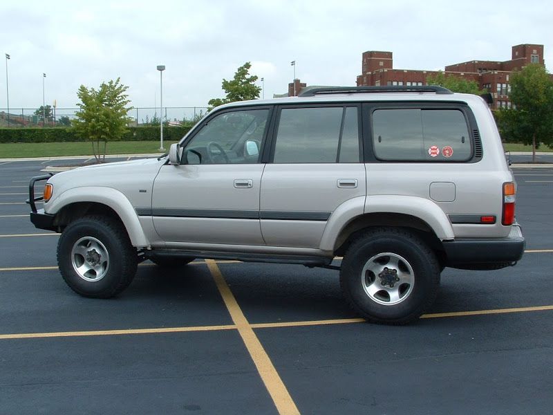

285s REVOs. The lift is an OME 850/860 combo. Just about 2.75"s of lift.
850 front 860 rear right? im new to these number things with springs, i always dealth with 2" 3" coils etc... without the front bumper was the front higher much? or did you add a spacer to the front after installing a front bumper?
reason i ask is because front bumpers are heavy and i have seen 3" lifts with front sagging because of the front bumper, so im trying to see how to avoid the front sag. plus i think 3" would be to tall, and 2.75 seems perfect with 285s (are yours 285 75?)

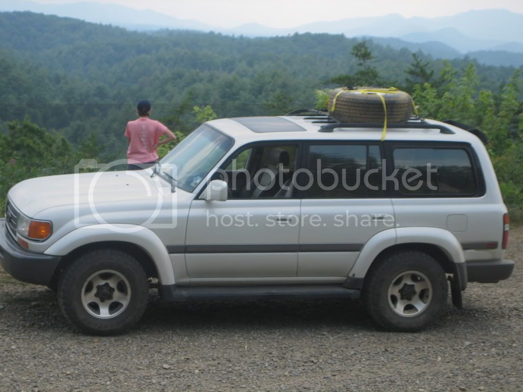

Here are 285's on OME 861/862 springs (1" lift), which now have been replaced by OME 850/860's (2.5" lift)
The 850s are the Heavy Lift FR coils (just 20mm longer than the 851 FR mediums). and the 860s are medium lift for the RR. The front dropped about .50" after I put the ARB and the M12K (installed after lift). I started with this combo b/c I did not want too much front rake (AKA Stinkbug).
My current measurements are as follows:
FR--22.5" from center of hub to bottom of fender flare (measuring straight up)
RR--23.25" from center of hub to bottom of fender flare (measuring straight up)
My pre-lift measurements were about 2.50" lower in the FR and 2.75" in the RR.
The following pictures show (1) stock, (2) Lift w/o ARB, M12K and Sliders), and (3) Lift with ARB, M12K and Sliders.
Next up will be 315's and Slee's 4" Kit.
