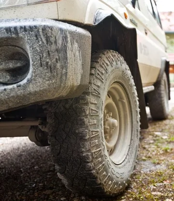

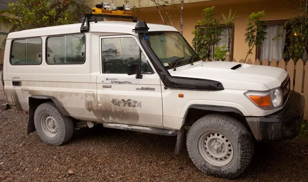

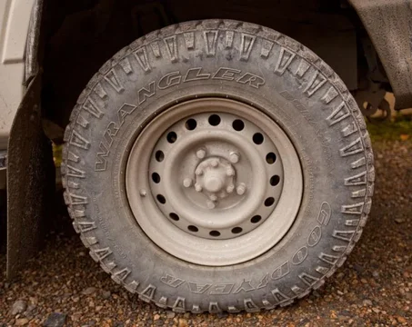

Not sure if this will help you...235/85 R 16 Goodyear Wrangler Duratrac installed on a stock 70 series rim (16 X 5.5 inch). These tires are pretty much exactly the same as the BFG's as far as the dimensions and sidewall, only difference is the tread (we run a few of the BFG M/T's, but the treads tend to chunk out pretty bad on the gravel/rock roads here). I really like this tire size and style, and will be using this exact tire on my 40 series, mounted on a 16x7 alloy rim with a 2.5" OME lift. No pictures of that, unfortunately not built yet.

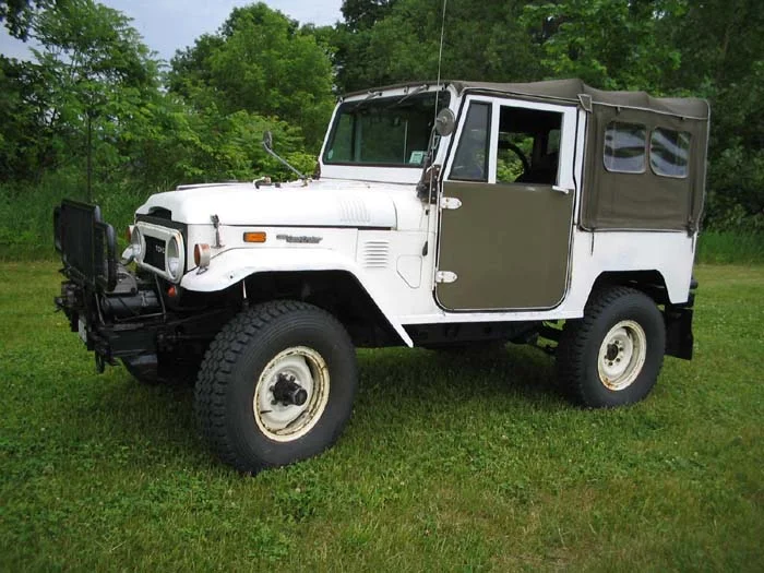

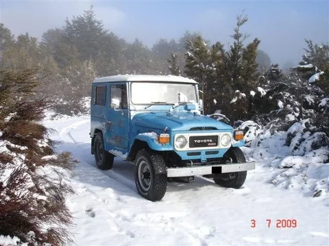

235/85 R16 on a BJ40 with original springs and no lift:
And I had to bend my pitman arm slightly inwards (towards the chassis) to stop my RH-front tyre from hitting my drag-link (relay rod) on full-RH-lock on uneven ground. (This a RH-drive vehicle but I'd expect a similar problem on the other side for a LH-drive vehicle that has no lift.)
:beer:

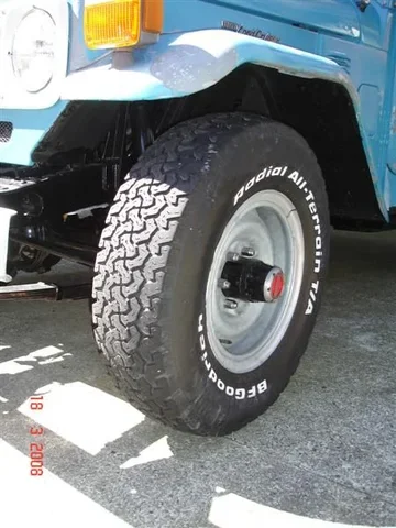

My photos in this thread are of my old all-terrains.

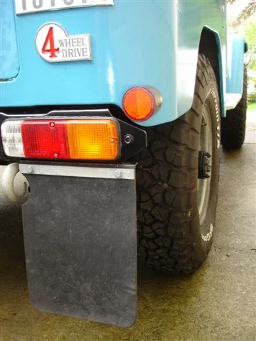

Not a scenic location (just my driveway) but here's a photo of BFG KM2 235/85 R16 mud-terrains taken from the rear:
As you can see, there are no clearance issues at the back with stock springs and stock split-rims.
