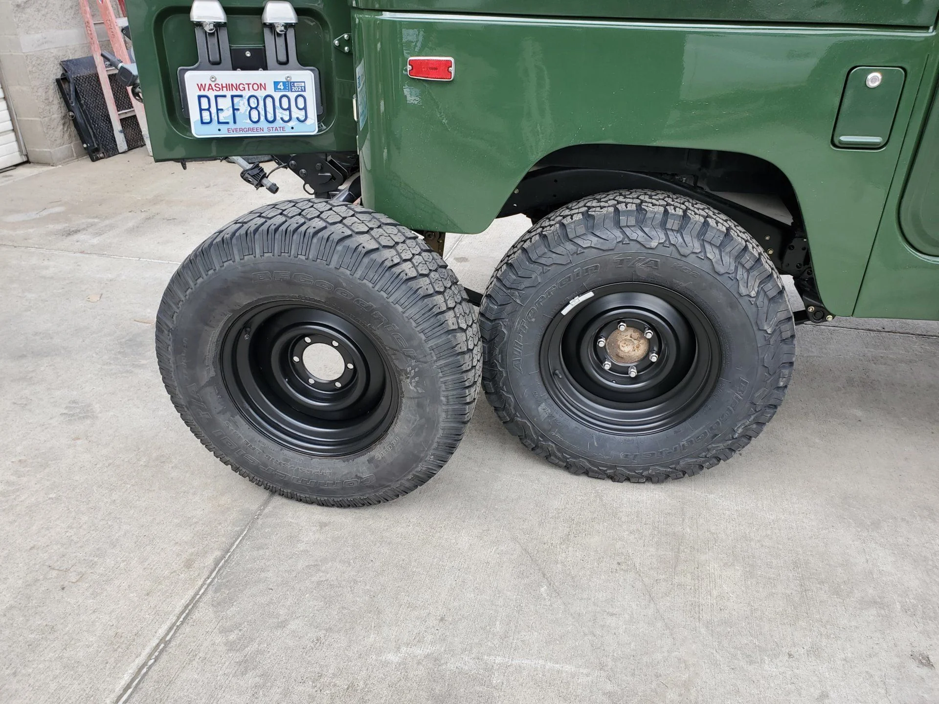

I just put some 235/85/16 BFG ATs on my FJ40 with 16x7 WV Smoothies. I am really digging them even with the E they seem to ride pretty nice. I love how they tuck right under the fenders. I would like to try some 255s as well but they charge a $60/ea premium on them and dont offer AT.
Here is a picture of the 235/85 L and 265/75 R for a size comparison.
