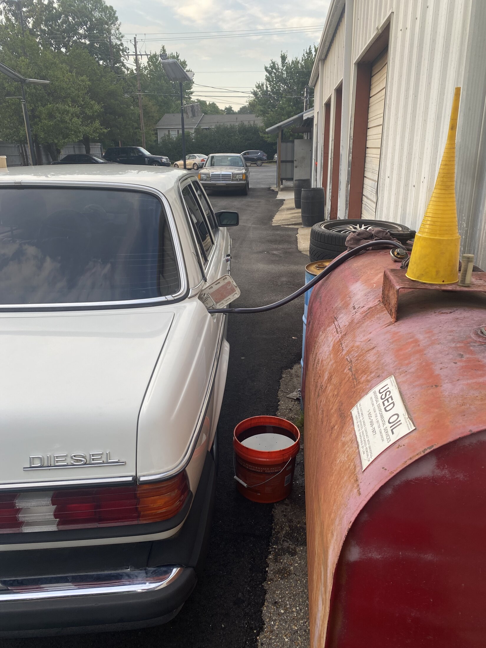

This does not apply directly to the 1KZ, but I thought I would chime in anyway. I have a 1980 240D with the OM616. I run all sort of waste oils in it. Vegetable oil, used motor oil, lamp oil, kerosene, and most recently expired airplane oil. I try to cut it with diesel at about a 60/40 split, being 60% diesel 40% oil. Anything higher than that and the car will get slower, especially in the colder weather.

do you pump in used engine oil without filtering or anything
This does not apply directly to the 1KZ, but I thought I would chime in anyway. I have a 1980 240D with the OM616. I run all sort of waste oils in it. Vegetable oil, used motor oil, lamp oil, kerosene, and most recently expired airplane oil. I try to cut it with diesel at about a 60/40 split, being 60% diesel 40% oil. Anything higher than that and the car will get slower, especially in the colder weather. View attachment 3782515
If it's clean, yes. I filter any used vegetable oil, and I haven't run a lot of that at all, only about 2 gallons so far.
Most of the used engine oil I run is caught straight from the vehicle as it comes out, and I don't filter any of that. The car has three fuel filters on its own.
It mainly feeds off thin oils like 0W20 from newer VAG, BMW and Benz vehicles that come through the shop.
If oil is too dirty to run through an engine, why would you run it through a precision injection pump?
