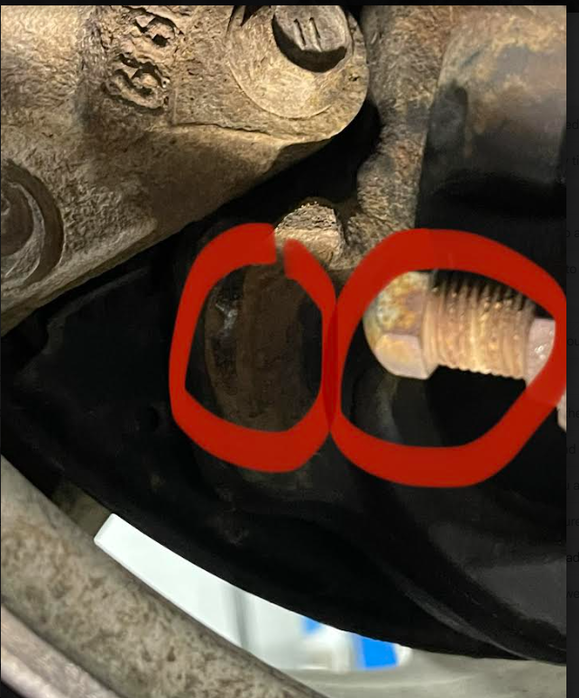

Have someone turn the wheel to full lock while you look under there and see when the contact is being made, what surfaces are touching when the pop happens. You can adjust the length of that bolt if it would help, but yeah those should be greased anyways.
It's possible when they put it back together they were off a spline somewhere or the tie rods are slightly different lengths one side or the other than they were before. Shouldn't be a big deal .
The noise is coming from those stoppers, you can see the metal wear marks in the picture. But the question is why and how to make it stop doing that, without a band-aid fix like grease.
The reality is , this noise was never present until this recent steering rack replacement. Wouldn't that translate to something not being right?
Have you tried adjusting the bolt length to see if it seats better in the groove? There are a lot of variables when replacing a steering rack/alot of adjustability, it's not uncommon that things are slightly different and need to be adjusted after that job.
I haven't got my hands on it yet. I got toyota to take it over to a specialty alignment shop and they also concluded everything is fine and to slap some grease on it.
I begged them to try and adjust something or do whatever to fix it as it has never happened until recent work but they said there isn't anything to fix it's very normal. I'm puzzled by that outcome.
I can try to thread the stopper in a little ways but it needs to eventually make contact with something, it's just not contacting where it should be and getting hung up. Hard to say it's normal, only happens to one side lol, something ain't right.

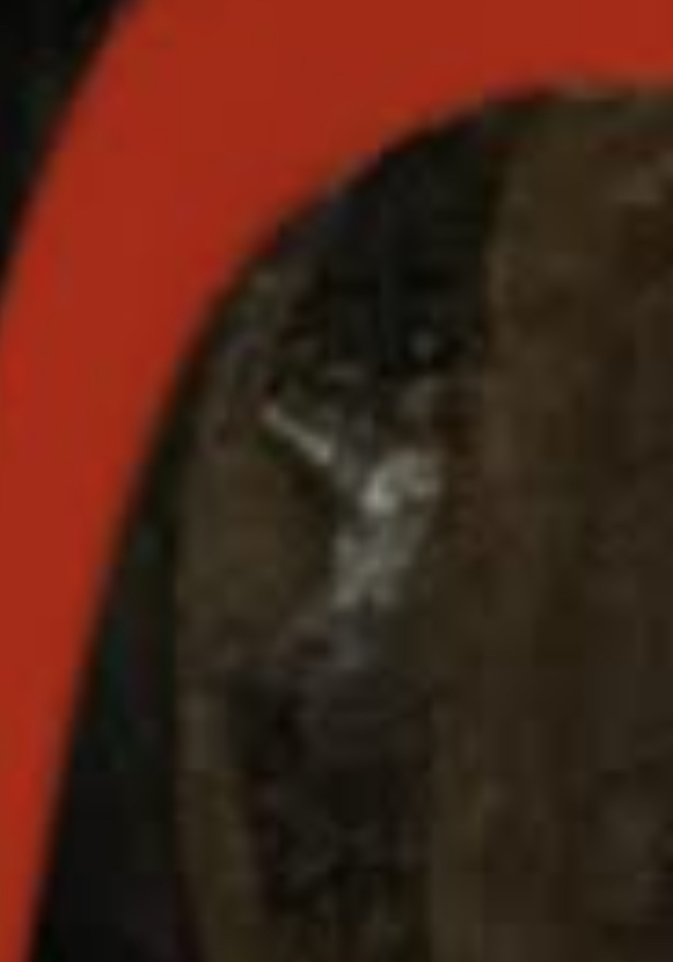

Looks like a small chunk of metal broke off and there’s now a divot, which the stopper could be getting hung up on and causing the “pop”.
If that’s the case, hit it with a grinding wheel to smooth it out. Then slap some grease on it 😬
