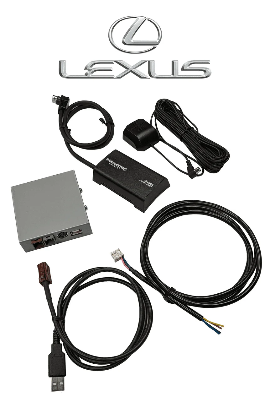

Rear one you should be able to lift it off as it is likely magnetic and that is how it is held on the roof. I have the same thing from a PO for a Sirius XM antenna (pulled up and says serious on bottom). I need to pull the edge molding to find out where the connection line goes, assuming all the way to the front, as I have little need for it but don't want some random cut-off wire hanging around.

My '05 LX470 has stock hands free bluetooth calling capabilities and the associated ponebook/pairing functions, but not bluetooth audio. As others have said, the square on the back of your roof is an aftermarket satellite radio antenna. My bet is that, if you pulled some covers off your dash and/or center console, you'll find a Sirius XM module buried in there and atached via a piggyback harness to the back of your headunit.

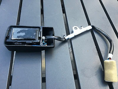

Most if not all USA 06-07 LX470, came with rain sensor. That is likely what the black box next to mirror is.
My 06 LX is a little different in that area, due to being NightView equipped, but it is my understanding that the rain sensor looks like this:
Rain sensor...same as on my '13 and to the right of the inside mirror.
