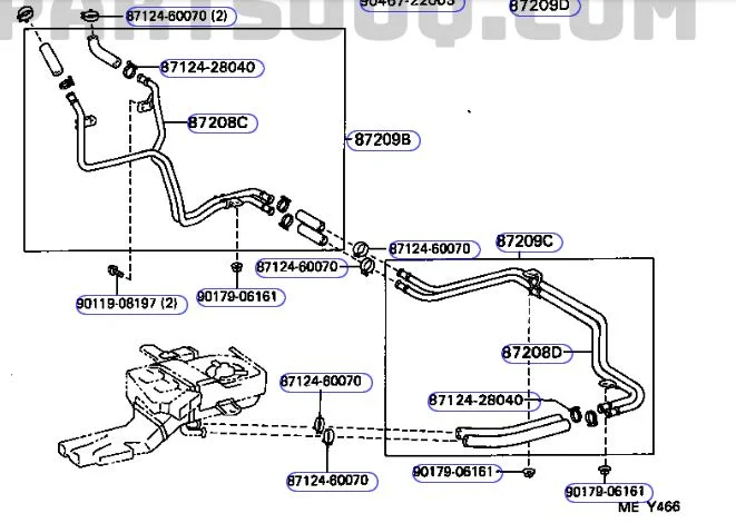

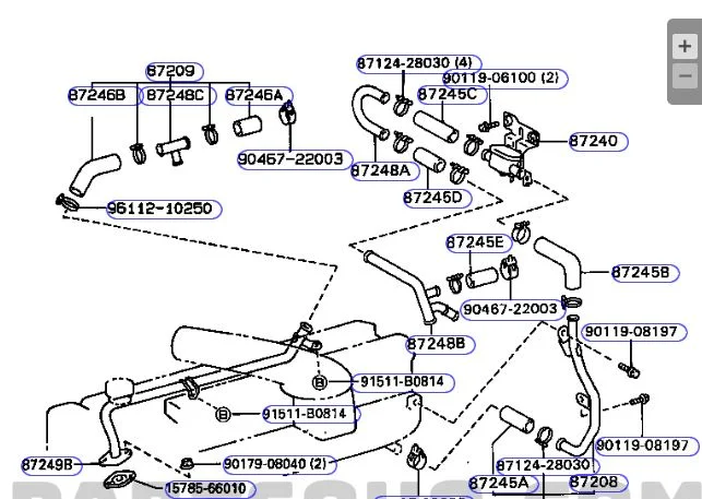

I'm digging into the heater hoses on a 97 FZJ80 and plan to keep the rear heater function.
As many know the sections of 1/2" hose that come off the rear heater pipes at the firewall come with that assembly from Toyota but are not listed as separate parts. So wondering if anyone has found a Toyota replacement part number for those two 1/2" ID hoses? There's also one ~ 90 degree 1/2" hose that comes off the bottom of the T pipe over to the right side of the firewall. Seems like it's been discussed in the past, just can't find that thread.
I could use Gates hose that will likely fit but would prefer to use OEM hoses for this particular location if I can find a hose from another application that will fit.
See Diagrams below:

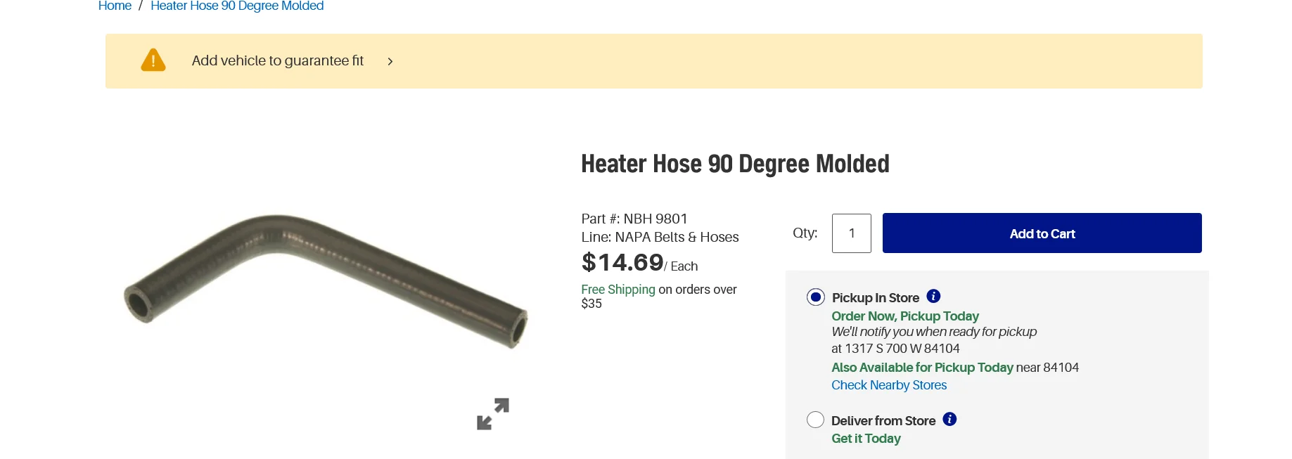

There was an FJ60 hose that could sub for the 90 degree rear hoses but that has been discontinued for around 6 or 7 years.
There is a Napa 90 degree hose, part number 9801, that will work.
There may also be a 100 Series hose you could carve up to work.

Thanks, that 100 series hose appears to be a similar angle as the what's used in the 80 series at the location in question. I see that's also a rear heater hose.
Good information.

Three hoses? Don't you mean two?
One on the passenger side from the bottom of the T to the firewall hard pipe.
One on the driver's side off that funky hard pipe to the firewall hard pipe
