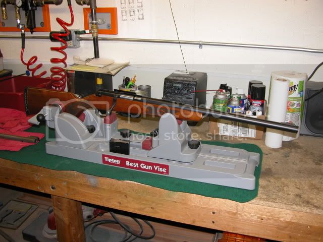

Ran lines down to my basement too (disregard the Marlin slug gun if you're a hater...):
