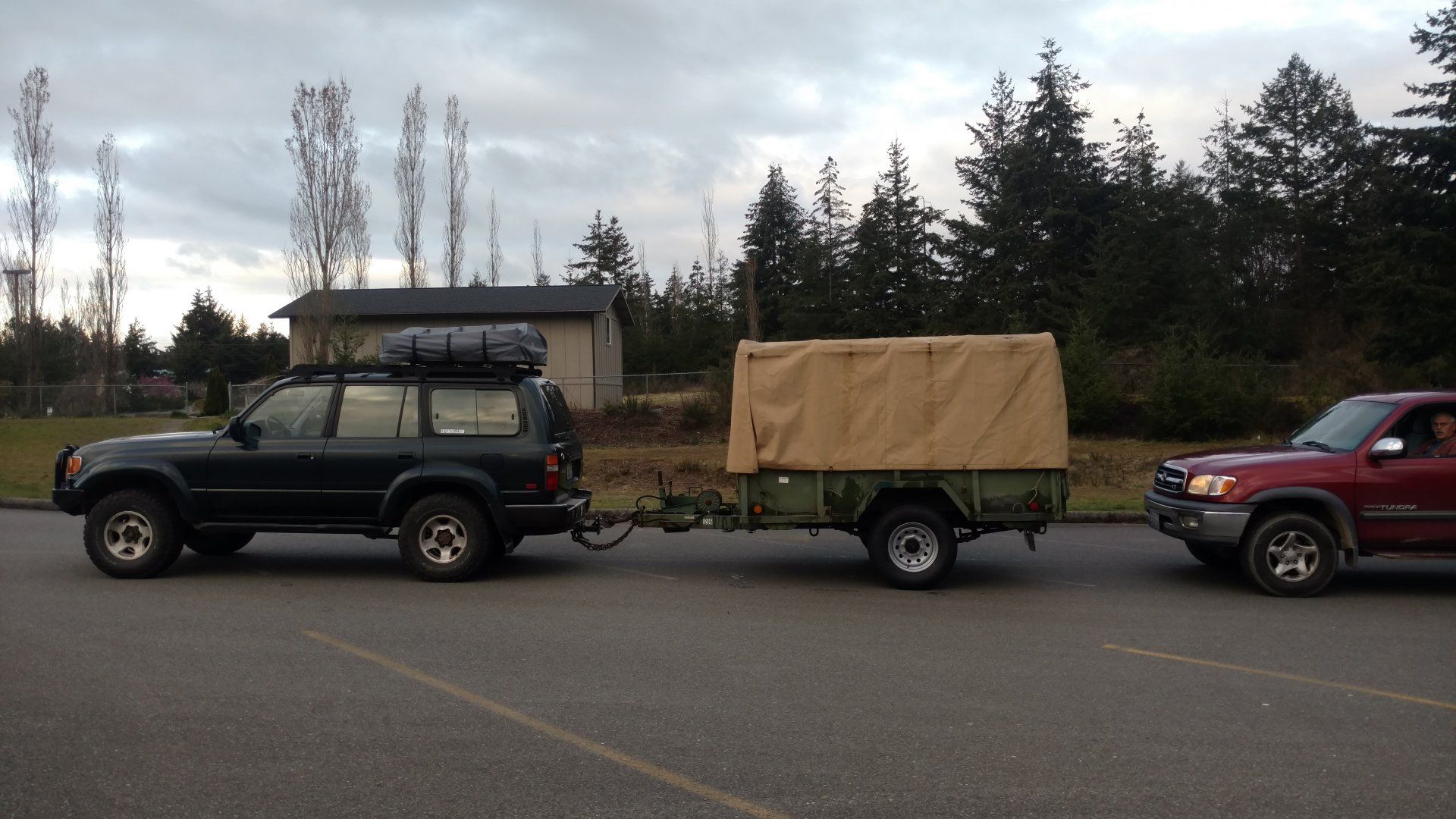

Got it rolling, just need to wire lights and brakes up. I'm pretty happy with the finished height and look. It pulls fine empty, though I haven't weighed it yet. Lighter than my boat at least. :p

It would probably be pretty big for an 80 series. you will definitely need a custom drop axle made. I stopped using mine after several years just because it was too bulky to get into most camping sites.

I still use my trailer as a heavy utility trailer. It's great, but I pull it behind an f150 instead of my cruiser now. If I did it again I'd look for something lighter, it's pretty overkill.
