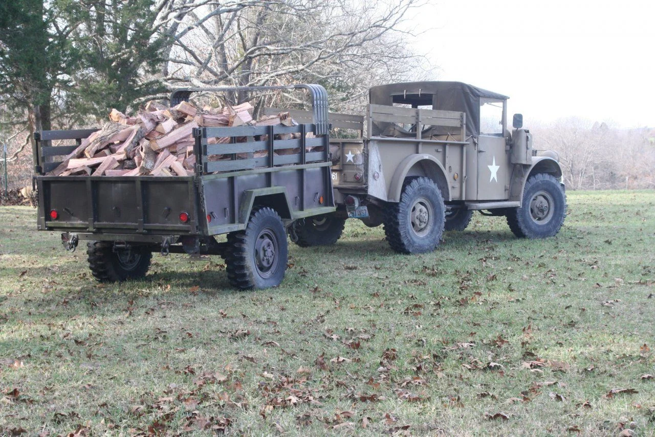

You guys kill me. I have both a M105A2 and a M416 (small). I pull the M105A2 out of my pasture with my FJ40, fully loaded with firewood. I wouldn't take it out on the highway unless it was behind my Dodge Ram, though. The M416 is a small trailer and is perfect behind an FJ40, but not wide enough for my bigger ATVs to fit inside. Either will hold more weight than you probably want.

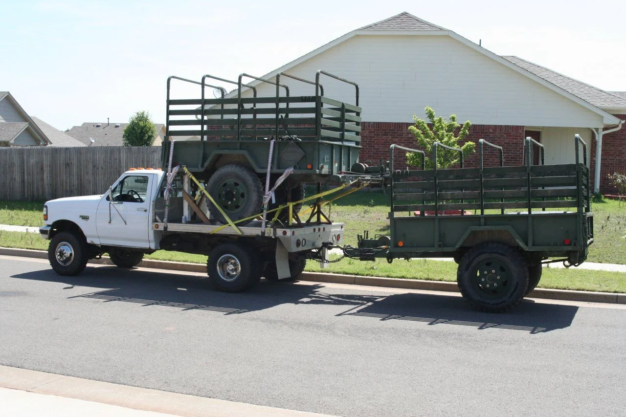

Here's two of mine and that's my old one ton truck. 105s are huge and then there's the spare tire problem, more weight. I can't pick up a wheel and tire for a 105 and those old military tires are old, cracked and not safe at speed. I'd hate to see a Land Cruiser try to control a 105 with a blow out. Watch out for that front landing leg, it will smash fingers real quick. That said, they are neat trailers. Good luck with it.
