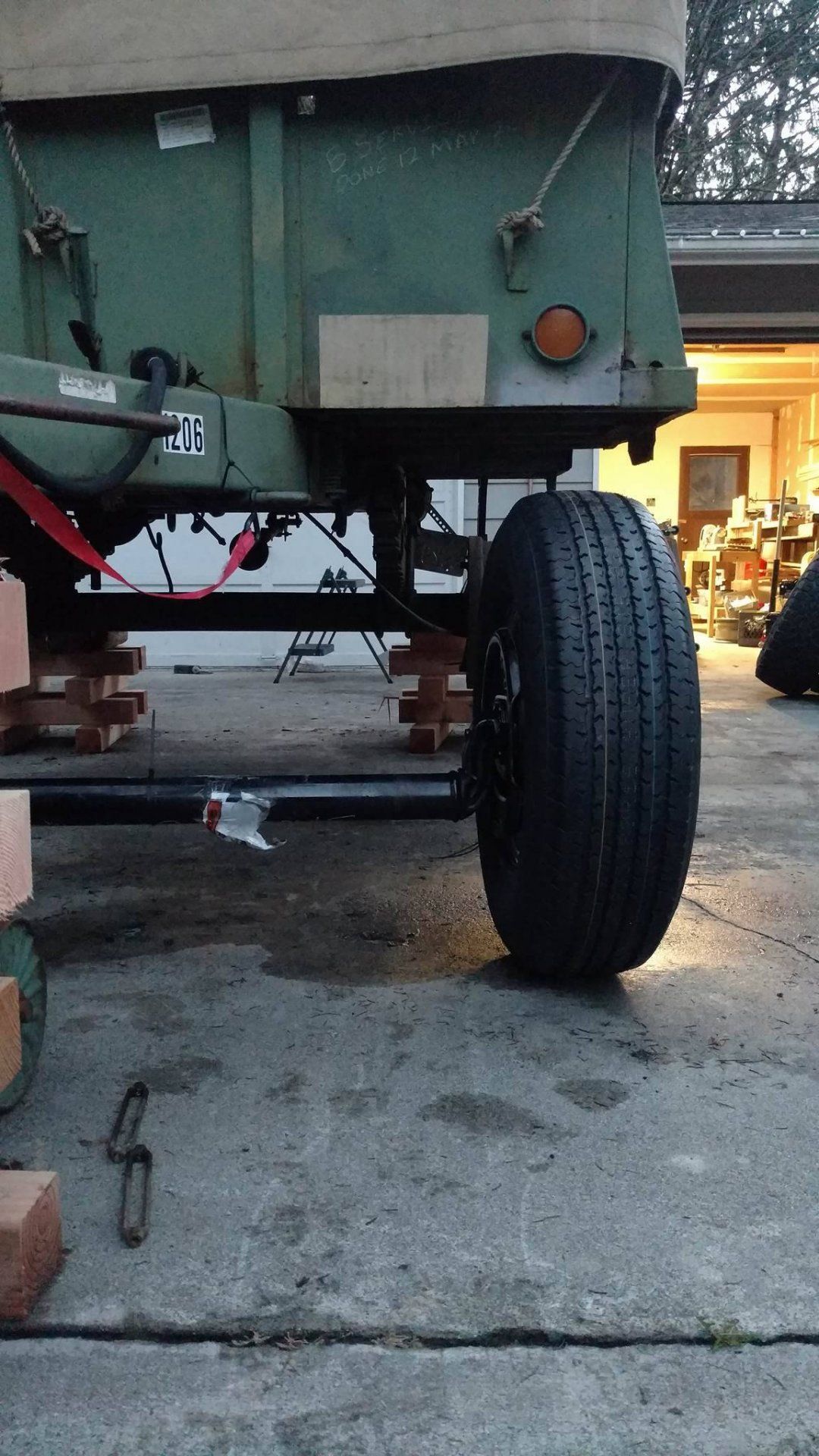

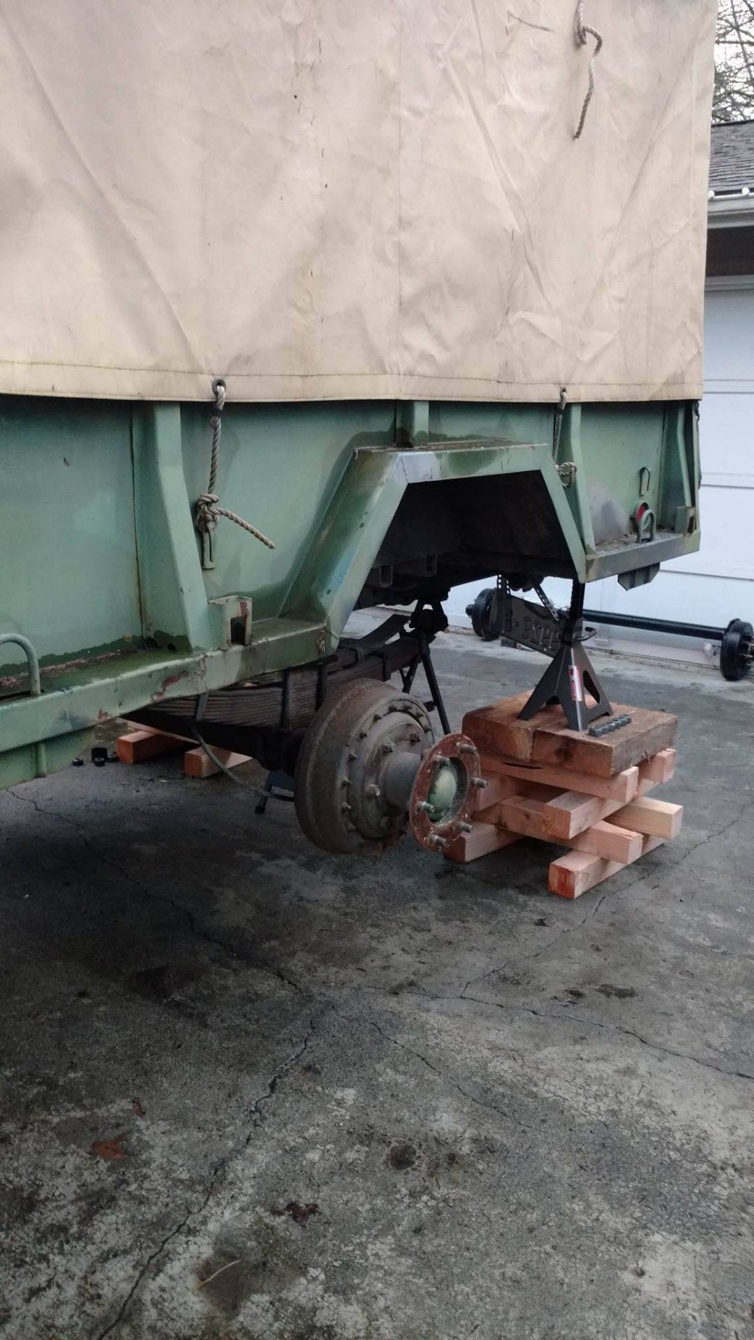

Towed alright empty and with a partial load of firewood. I'm currently preparing to swap it to a 6k drop axle with electric brakes, and matching wheels and tires to the cruiser. I'll also ditch the landing gear for a lighter weight jack.

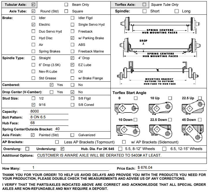

Getting closer to my swap. I wound up ordering an 8k 4" drop axle with electric brakes. 8 lug unfortunantly, but with the large difference from spring center to hub face I wanted a stronger axle.

What I like about the 105 is the volume, you can carry a ton of bulky stuff. The original axle and wheels are extremely heavy, I'm sure I dropped 4-500 pounds there, easily.
Swapping the axle got it down to a nice height. Like you say, eliminated a bunch of weight. Deleting the original dolly jack/wheel will take off more.
