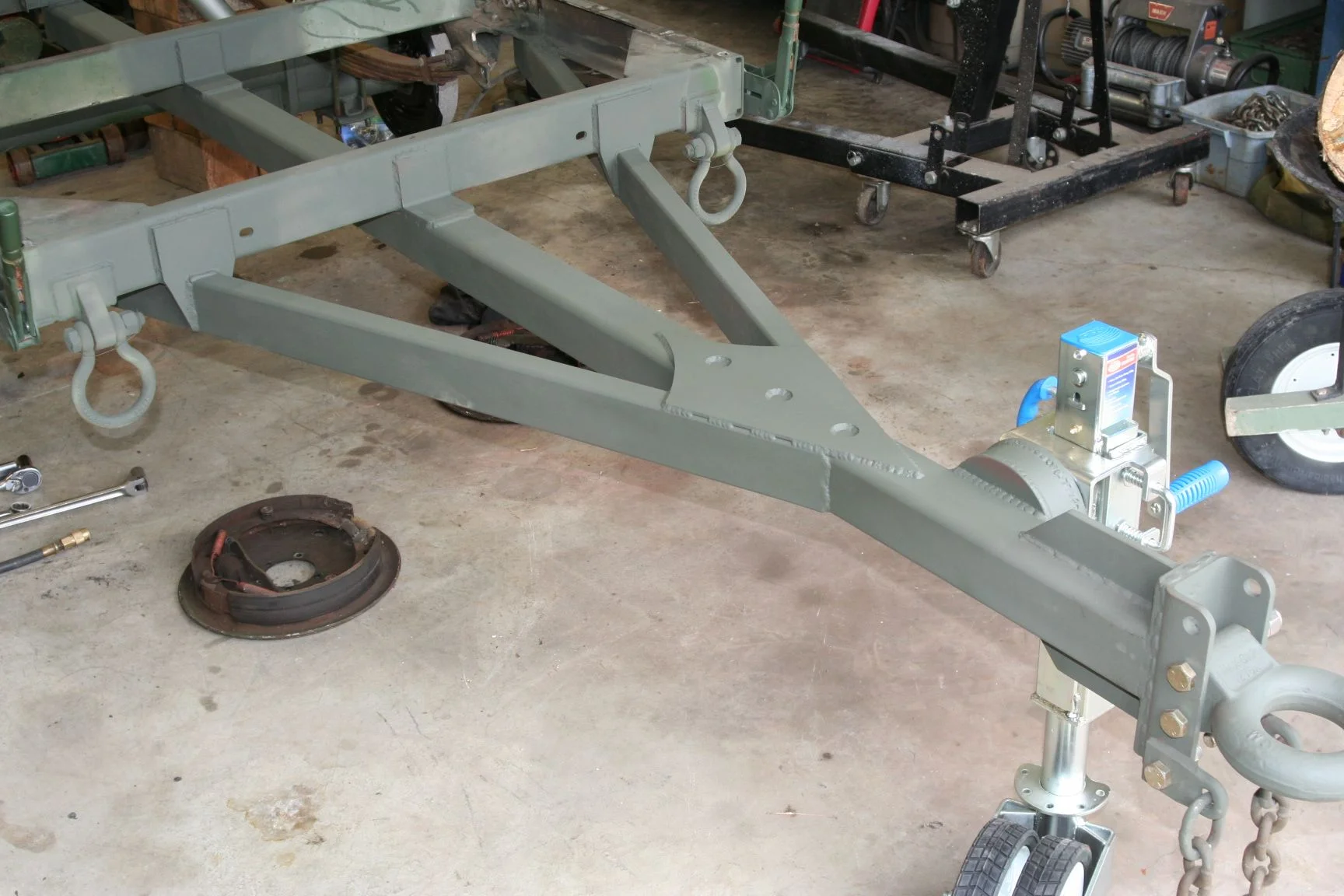

I picked up this new-old-stock Marine Corp M105A trailer from a guy in South Florida and got to work. I always loved the small overland trailers that people built, but I wanted something a bit bigger to fit all my gear.
First things first, the GIANT axle and wheel combo had to go. It weighed, i'm assuming, close to a million pounds. It was also so tall, that even my lifted F250 couldn't get the tongue level.
Next, I had ordered a custom 7k lb axle with electric brakes. I measured it no less than 3 times and even confirmed my measurements with others who built similar trailers. Apparently, though, I didn't take into account the width of the brake drums, since others opted to NOT use brakes.
That turned out to be a poor oversight on my part
Unfortunately, there were no pictures on me, hungover, cutting a brand new axle in half, sleeving it with 1/4" wall pipe, and welding it all back together.

Nice! I've got several of the 105s and as you know that landing leg can be a finger breaker, not to mention a ton weight. Are you planning to enclose the bed?
That front gear is a monster! Haha

Hi TaylorDurdan,
After you cut the axle, what was the hub to hub measurement with electric brakes? What rim and tire setup are you running on the trailer?
Thanks, Drew
I don't remember the final width as these pictures are from 2016, but I will be working on it again soon and I'll measure it.
I do know that I had ordered it at 78" wide and i *think* I cut out about 18" (if not more) from it. The leaf spring centers are 40" on center.
Pretty sure the wheels were just 8 lug steel wheels from Summit and the tires are 33s maybe? I keep the trailer across town in storage when not using it. I'll have more answers soon, sorry
