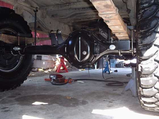

55s came with a rear anti-sway bar. I still run mine after the SOA. It's my DD.

Nice and clean axle dude .. but just wondering if your pinion angle don't need to be a little high .. ?
I wondered about the pinion angle too. Haven't had a problem as yet...
here you can see ( sorry I will find a better pic ) my rear pinion angle ..
plase don't compare my axle housing with your clean one :D
