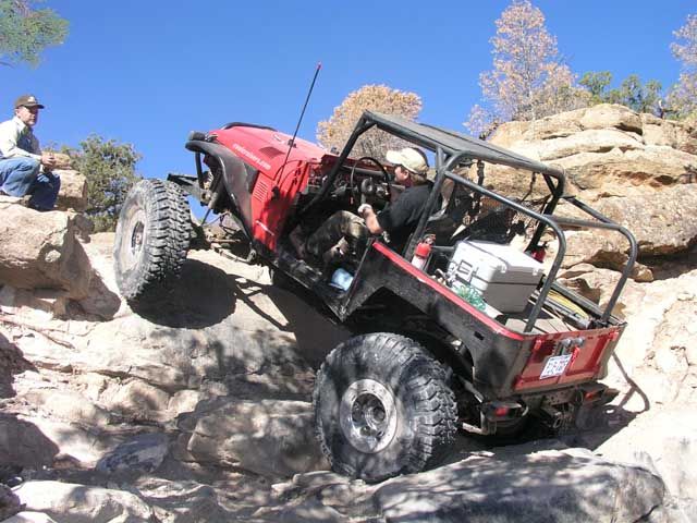

I ran them at one time and I liked them a lot in everything but mud. On rocks they are awesome. Rock Spider was a logo they had on the 40's when they first released them to the comp only crowd. The compound on them is DOT but there are some "sticky" MTRs available to competetors.

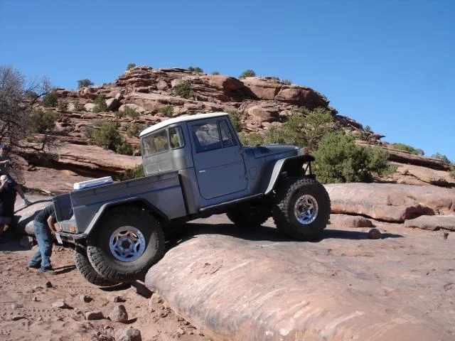

This is a simple Spring Over using stock 40 fronts and FJ55 rears. Tub is cut and the fenders are raised up.

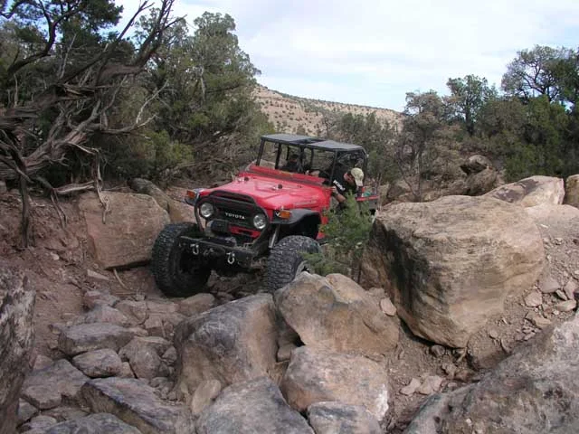

The MTR is a great tyre on everything but mud, thick sidewall, great puncture resistance, not to bad onroad, Pitbuls are bias ply, so they suck on road, but work well offroad, 39.5 x 16.5 17's I have been running. [thats not me either, just my truck in the workshop]
