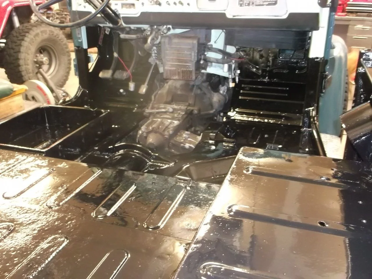

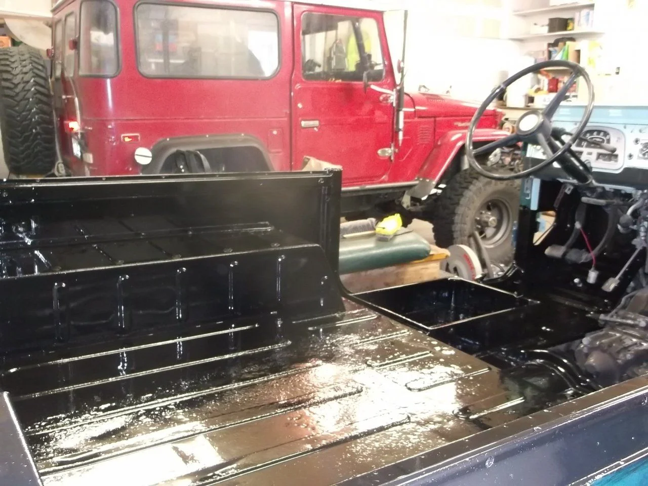

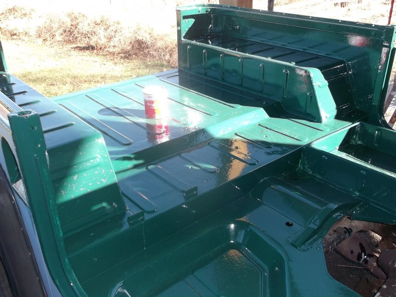

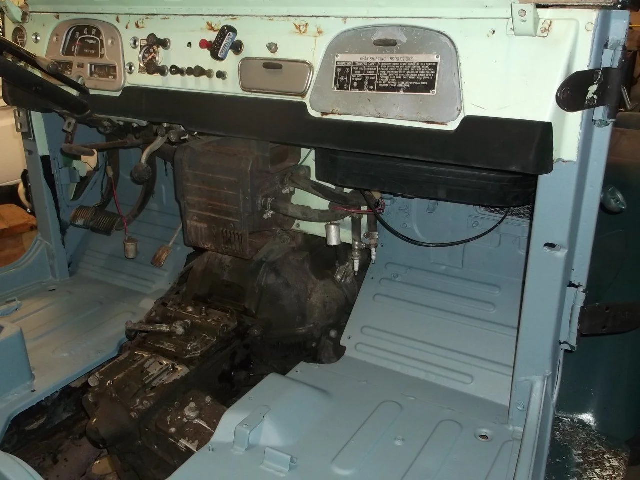

Good stuff used correctly. I go the full route. Black POR15, then Gray TIEcoat primer, Then I'm using a marine polyurethane paint. See photos. Sorry photos are not in order of painting.
