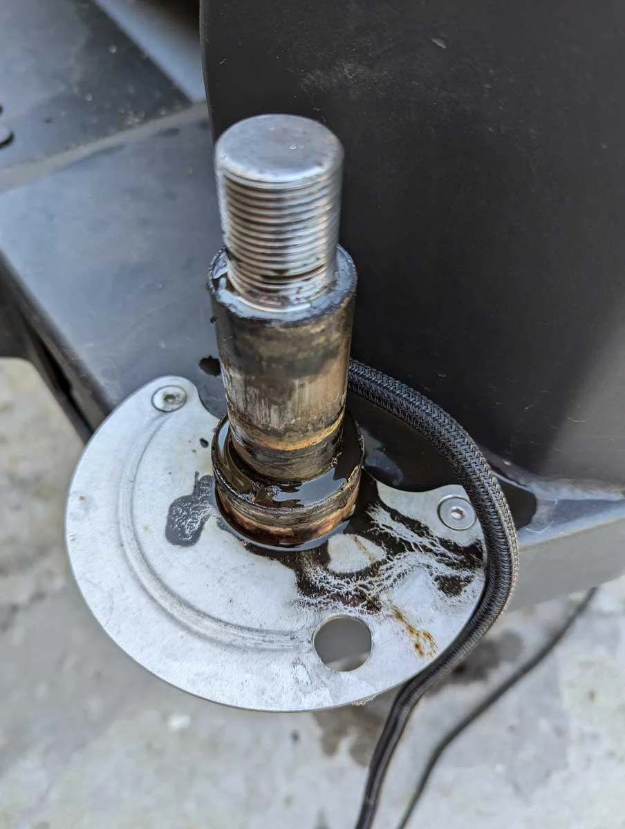

First one is the circular plates under the swing out spindles that stick out. These provide a guide and hole for the spring loaded pins next to the spindles. They are there to stop the swing outs from opening out all the way and hitting the car. However, they stick out, are unsightly and more importantly are prone to getting hit on the trail and getting damaged. My bumper came with an extra set, but to replace them you would have to take out the swing out, the bearings and the spindles...When I look at other manufacturers, I can see that there are better ways of limiting the swing out movement.

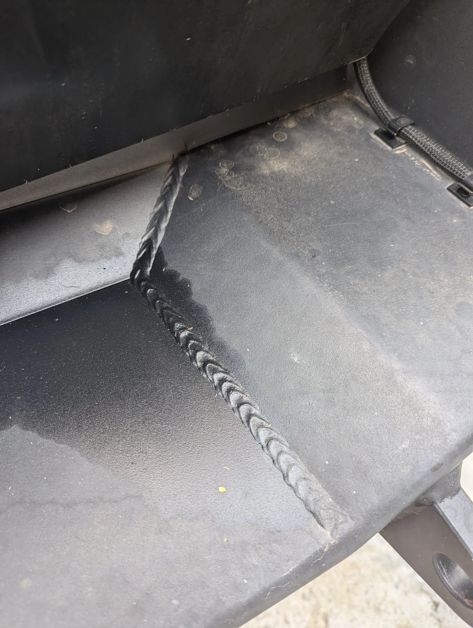

B) Weld quality: They are not the best out there but I have also seen worst. In my opinion they are average. Definitely, not as nice as my Dissent bumper but better than some other brands. I am including some pictures of the various sections for reference.

D) Spindle bearings (hinge): They failed after 1 year of use. Left side bearings broke and the swingout was stuck open. The right side is making grinding noises. There was evidence of water in both sides when I opened them. Currently in the process of replacing bearings and seals.
