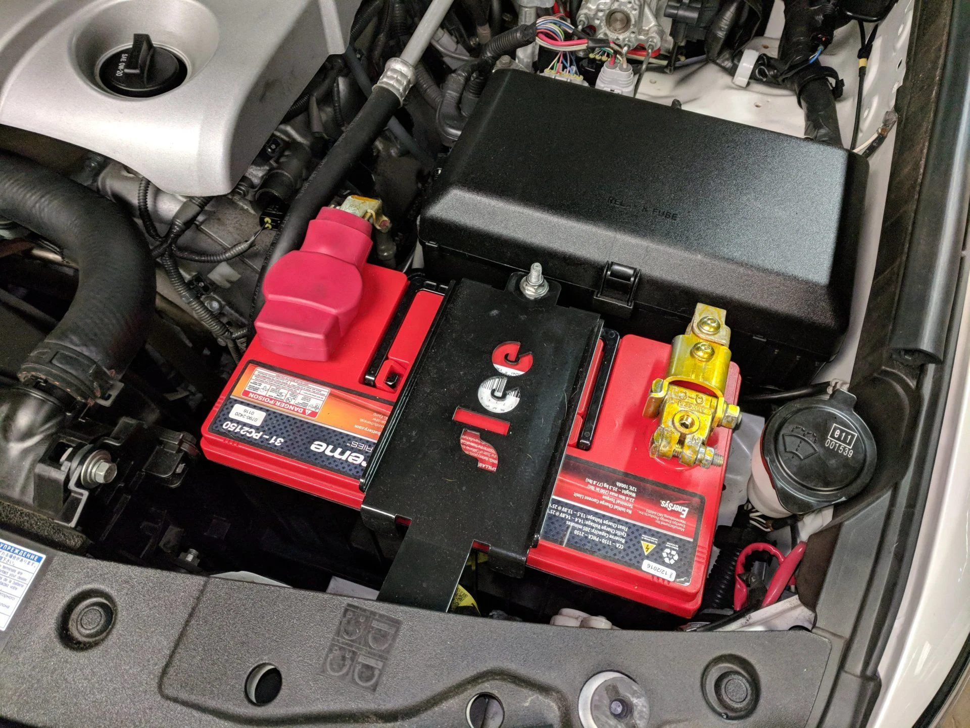

The 31 doesn't have posts, just threaded connections. So the 31P is just a 31 with post adapters installed. I went though the same thing when I bought my Odyssey.

Other group sizes do fit and I went with a group 35. (personal preference from reading 31 vs 35 batteries)
There is info in the "power" forum on dual batteries. Example if this is for a fridge Lithium is better vs winching AGM or wet cell is better. They also have some good video links over there. Plus cost .. I picked up a Lithium 138 Amp Hour for $350 for the fridge (not winching). So I have a 3 battery setup.
