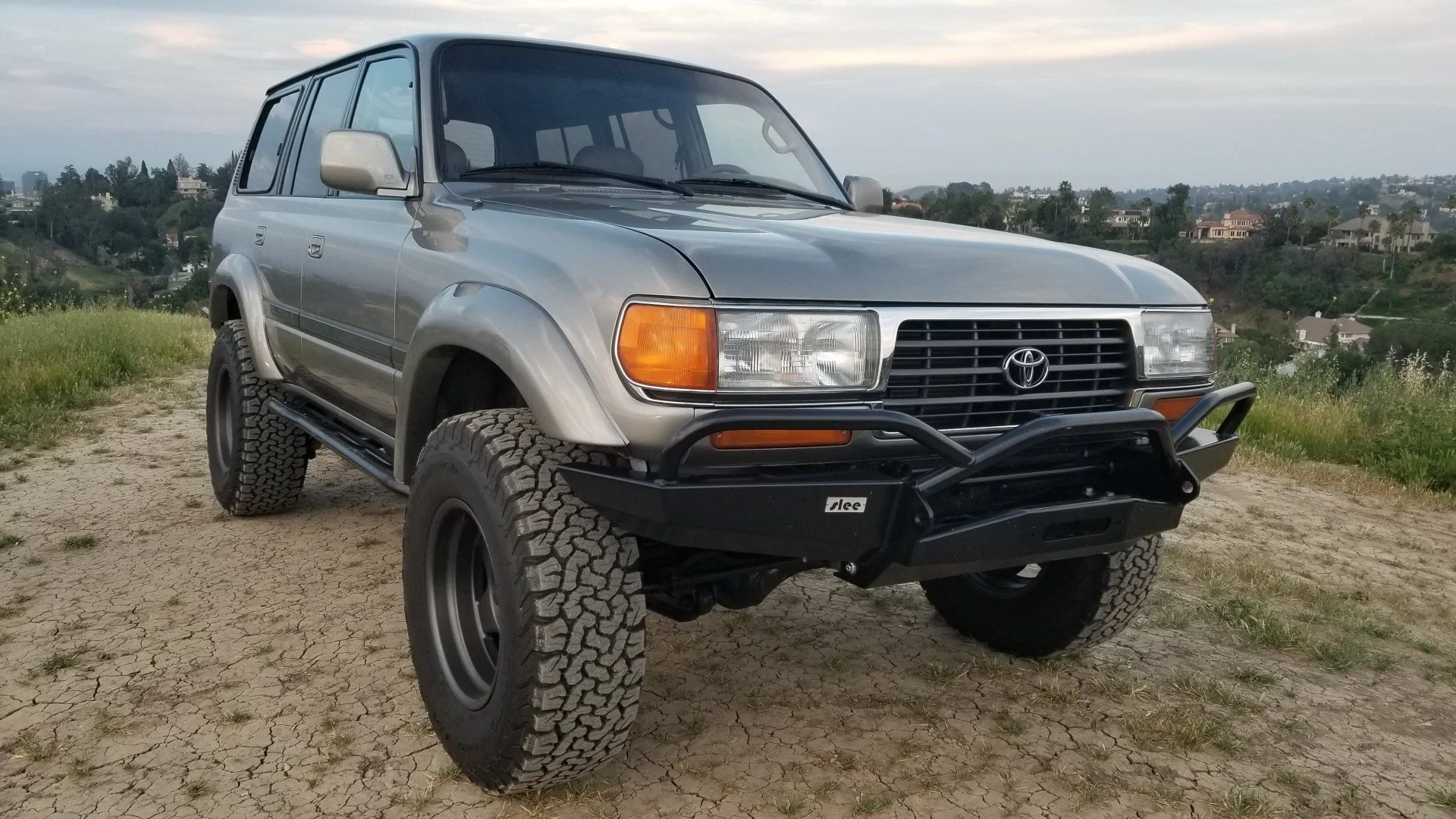

Okay, so I have a built 80. All the good off road mods. Plan to remote camp and mostly moderate trails for exploring. No real rock crawling...I have a brand new paint job! Haha.
I am trying to conservatively narrow down winch choices.

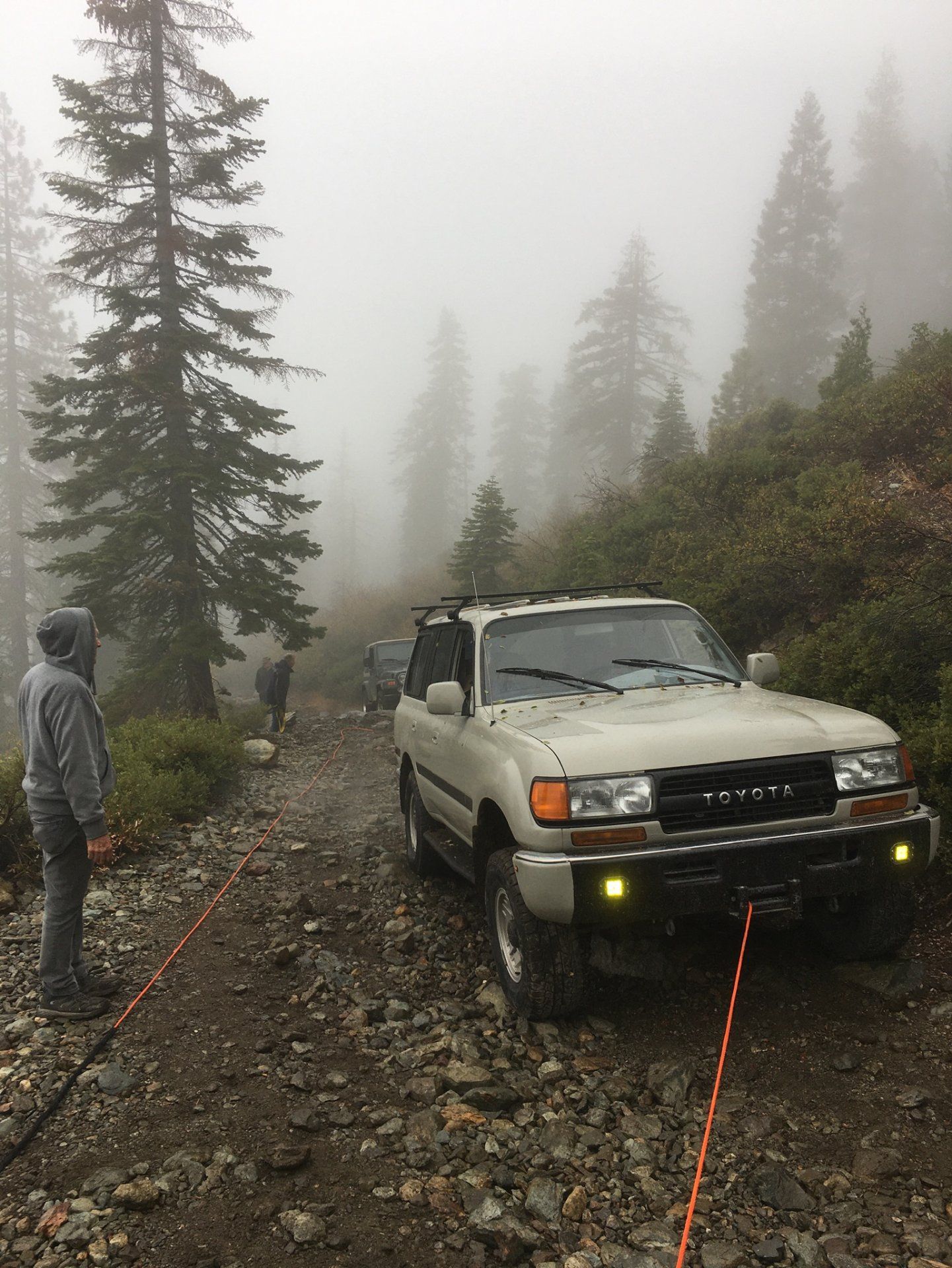

I’ll give two enthusiastic thumbs up for the smittybilt XRC 10k on my 80. Purchased on Craigslist brand new for $300. I was sold after my buddy came and pulled me out of the mud in my F250 loaded down with a full load of Oak firewood, uphill! He’s winched for years btw (grew up on the farm, had pulled his tractor out a few times also owned this model and used for a couple years). Waterproof, wireless remote, bought synthetic line, and hid it under stock bumper.
first time out on the trail I winched 5 of us out past the last obstacle, snatch blocked up to a rock, and backwards behind me.
