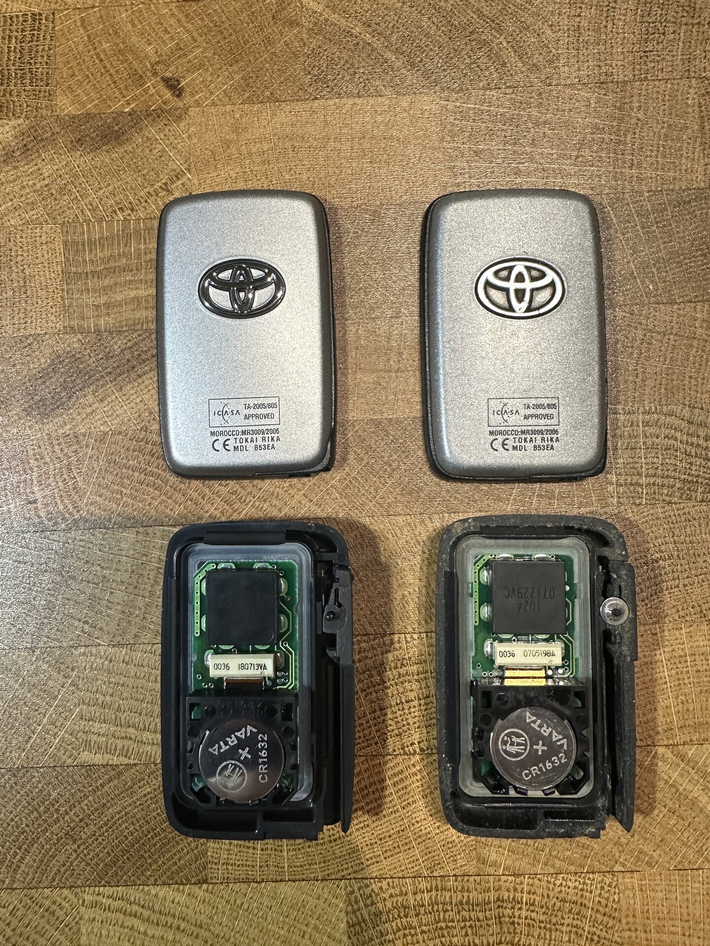

Met him today and directly tried to pair the key with my 200 since the last time with the one from China it didn’t worked (but was worth a try)
The new key got recognized by the Startbutton with a beep and then always the process failes with the step „place your key text text text on the passenger seat“, the 30s running down and I get a fail message.
The key is definitely virgin and oem (at least I hope so) so there must be any special trick with the paring I don’t know.

At least in the US we use techstream to pair keys, unsure if this is necessary in other markets but I’d be surprised if it wasn’t an option.
In US models, There is a code on the other side of the circuit board. I believe that has to match for the key to work. Did you verify that? I don’t know if some codes are compatible with others, but I know when I bought a refurb off eBay, I accidentally ordered the wrong code. Leakily the seller also had one that was the right code and I 2as able to exchange it. The second key worked fine. All other numbers on the key were identical except the 4 digit code on the circuit board.
