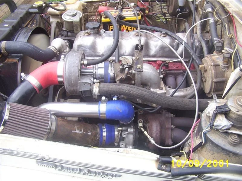

its a 100% custom turbo manifold made from 1.25" buttweld bends 4x45's and 10x90's if i remember correctly its definatly not made for show or flow its just made cause it was easy and fitted (just)
ill be taking the turbo off to fit new studs to it in a few weeks so ill post pics of the manifold then

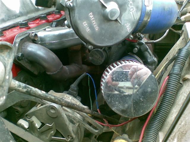

so pretty much its a r32/33 skyline turbo (oil cooled only) a impco 200 lpg(propane) mixer im changing this to a impco225 once i get more silicon bends too hookup the intercooler
the intake is a stock 84 inlet with a gas research throttlebody adapter (Gas Research) a ed falcon throttle body 4l

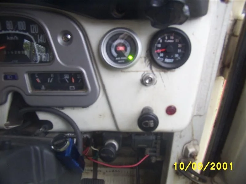

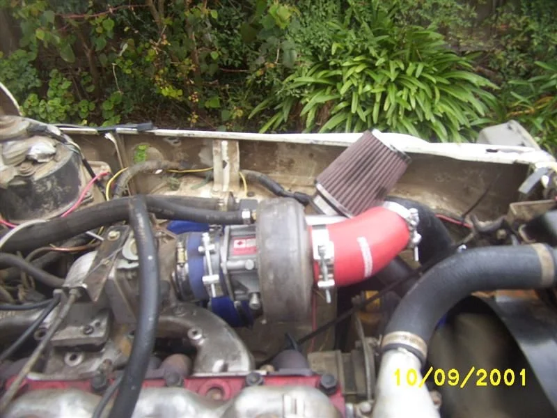

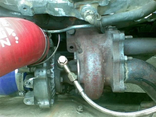

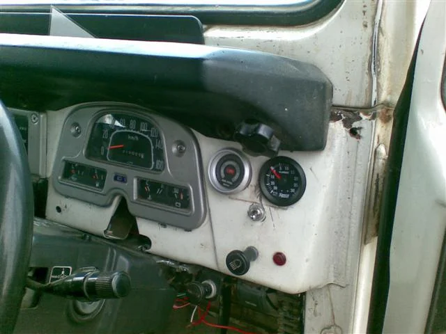

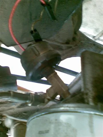

from top to bottom description
1 boost gauge and air/fuel gauge
2 overshot of engine bay damn messy but oil line will be shortened lots but ill do it once its all finished off and
3 turbo up close shows oil inlet on the turbo and yes i know there are bolts missing im waiting for stainless studs and nuts to arrive for both the turbo flange and wastegate
4 oil line and t piece of the oil filter housing works fine and ive still got great oil pressure to the engine

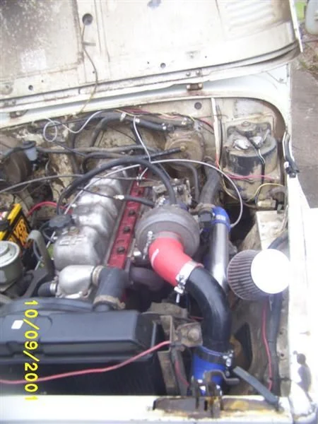

5 theres a intercooler wedged in there waiting on silicon bends and reducers to hook it up

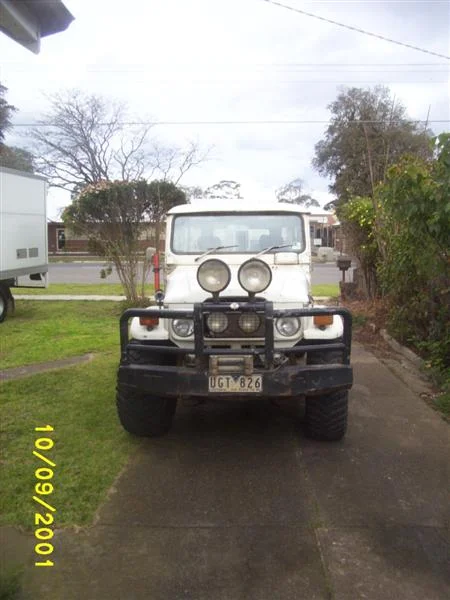

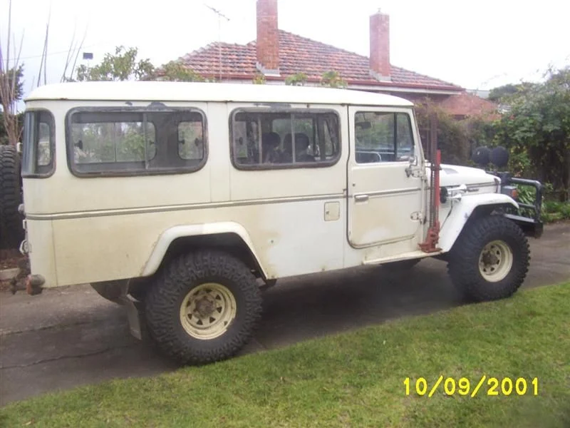

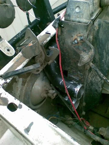

6 front on shot cant really tell much but shows 1 good thing with a aussie rhd cruiser is no steering shaft/box on that side to worry about

last i heard, this was "trialled" at 20 PSI, and the mixer still delivered enough gas to stop any detonation.
did you use ARP head studs? double gasket to drop compression? any internal mods to the motor?
lol yep but turbo ford 250 would kick even more ass
yeah ive ran it at 20psi and it hauls but at that much boost im gonan destroy something so im backing it down to 8-10psi
stock engine been recoed at some stage with 50 over pistons, and the head has double valve springs and inserts for lpg but it all looks stock apart from that

finally got my silicon bends and clamps so ive nealy got it all hooked up and intercooled

engine seems happy at 10psi no pinging and acording to a narrowband air/fuel gauge its only leaning under deacelleration and i guess thats normal

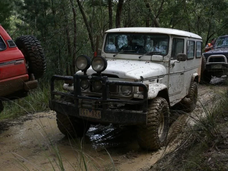

went for a bit of a play today however since it rained for about 5 hours last night everywhere was sooo slippery it was silly
had soem serious carnage a patrol slid sideways into a tree taking out the drivers door and the sill
another patrol killed the clutch or something clutch related
a 60 series cruiser snapped the mounts on his pto winch
and i broke something inside my pto winch head GRRR
heres a few pics no action shots tho
