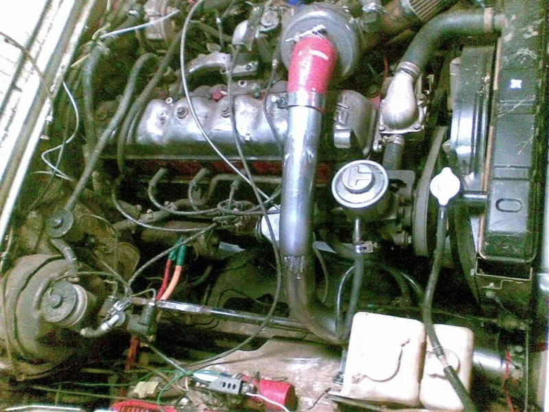

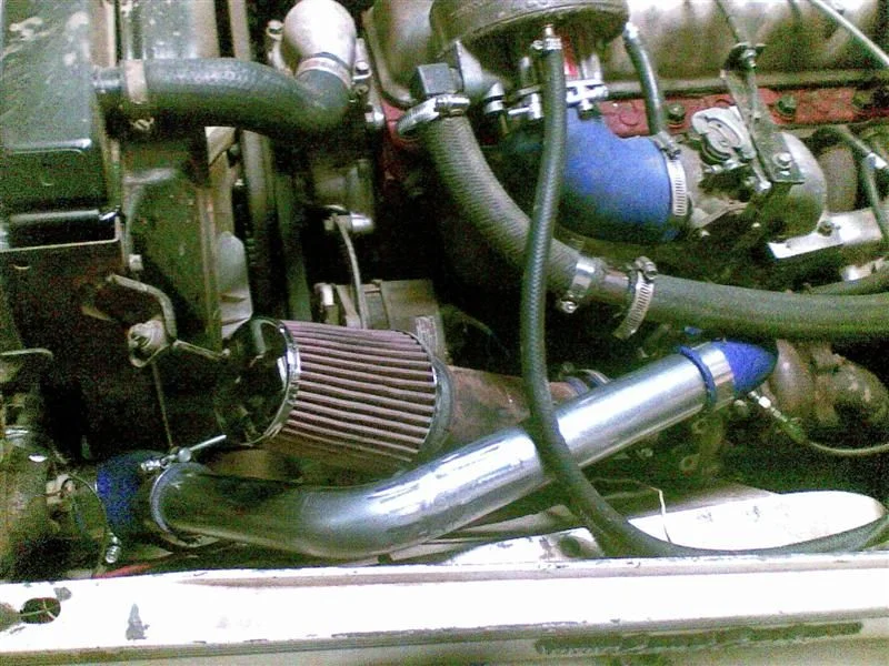

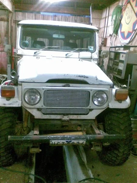

had to make a few small mods much bigger front mount intercooler and have also done some rust repair
running heaps better but ive got a leak from the exhaust manifold so ill have to replace that gasket will prolly get it faced while its off to make sure its flat

with the bigger cooler/LOOOOOOOOOOOOOOOOOOOOOOOOOOOOOOONG intake, is there a noticable increase in lag while it pressureises the intake

its fine with the extra intake piping i dont notice a distance tho i havnt driven it much yet
the extra piping between the gas mixer and intake means its a bastard to start(always has been tho) i need to get a electric primer for the converter to fix that

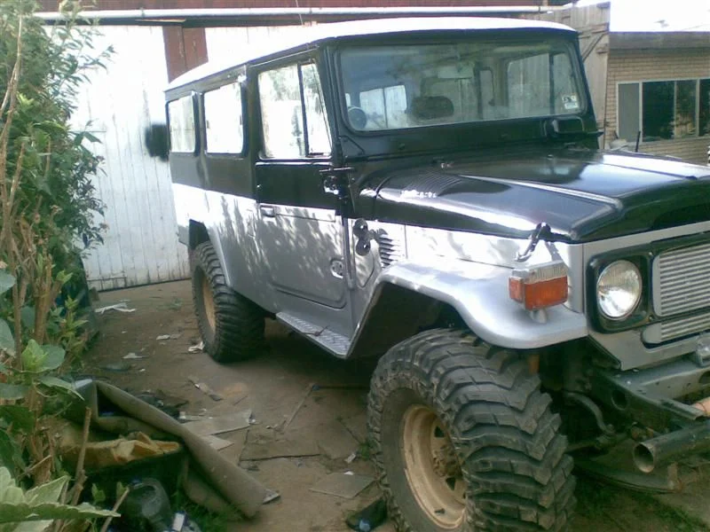

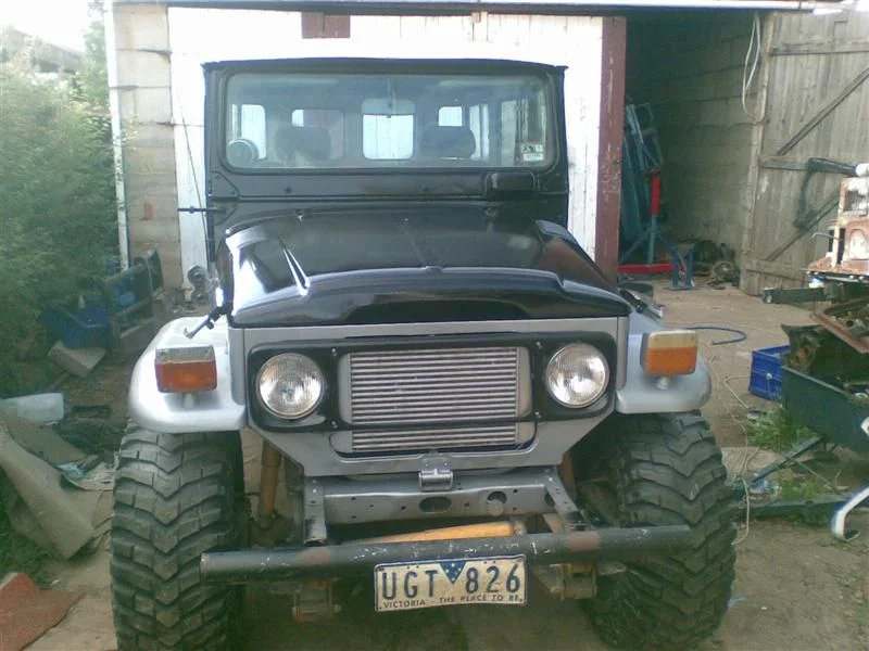

and now its just had a new paint job and rust removal poor quality paint but atleast it make sit look pretty for the photos and from a distance
painting the old bullbar and refitting the winch and bullbar tomorrow
yeah it looks great from a distance LOL been out driving today and its running great and also cruise control i fitted is working a treat (yes a fj45 troopy with cruise control what else will us aussies think of)
yeah i recon ill paint it a mix of black and silver as im trying to hide the intercooler as much as that is possible LOL

it gets quite warm uphills on boost but i do have a monster intercooler and im also running 12psi on a totally stock engine without having it tuned after installing the turbo
