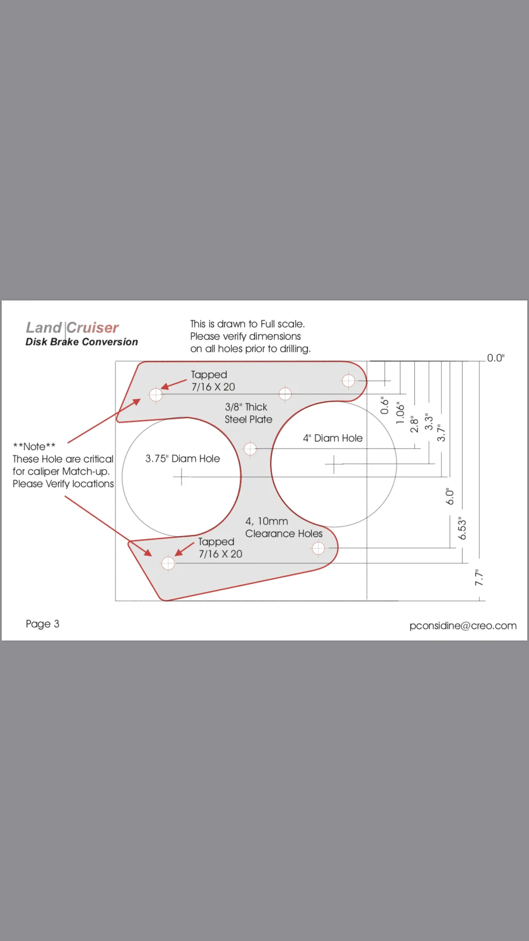

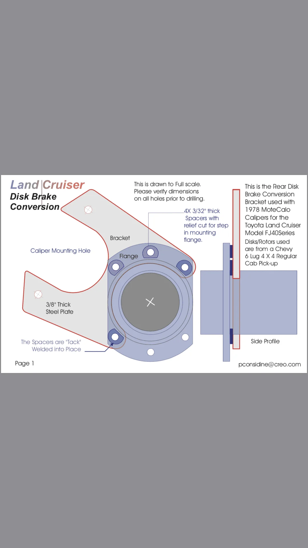

Did you design the bracket yourself? Just curious. I did my own because I found that some of the files floating around were not very accurate.
Sorry for the late response. This is the thread where I found the brackets. All I had to do is convert the files into a DXF so I’ll it would talk with the water jet. I did however make the holes a little smaller to account for the kerf from the water jet.
Once the brackets were cut, I reamed the holes open to the proper size.
Brackets for Rear disk conversion
Whoever drew these up did a nice job.
I started with those but when I cut out a test set, I had some alignment issues. I designed and modeled my own set. If you have any problems with those, shoot me a pm and I’ll share the .dxf.

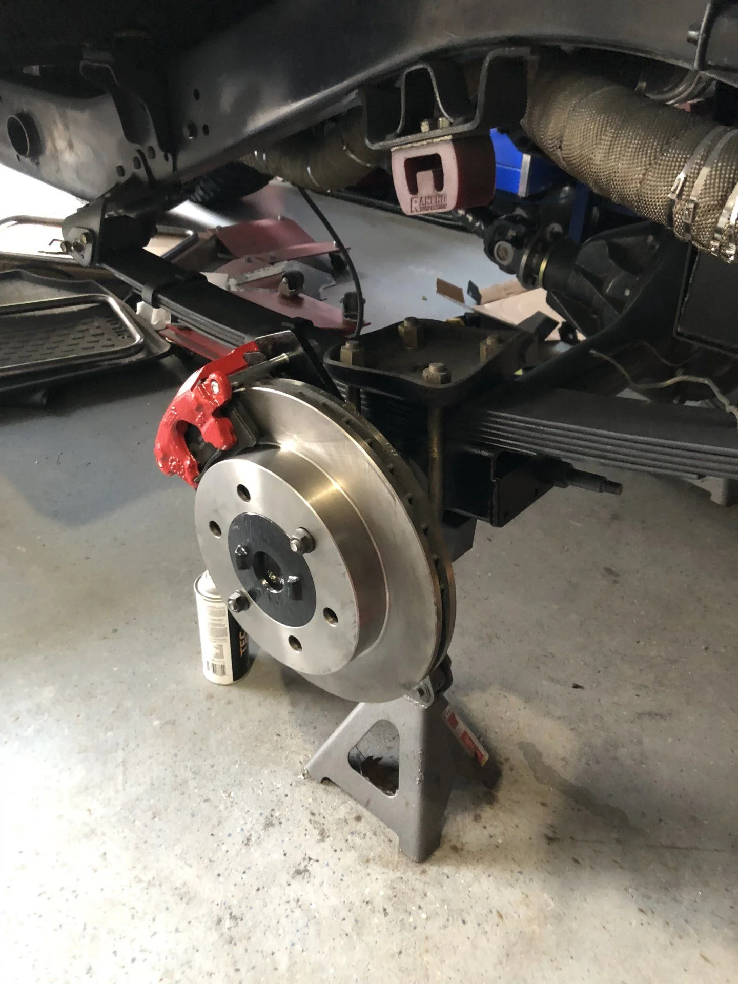

Test fit.
No. I am running the same setup, along with a booster from a 74. No proportioning valve necessary.
