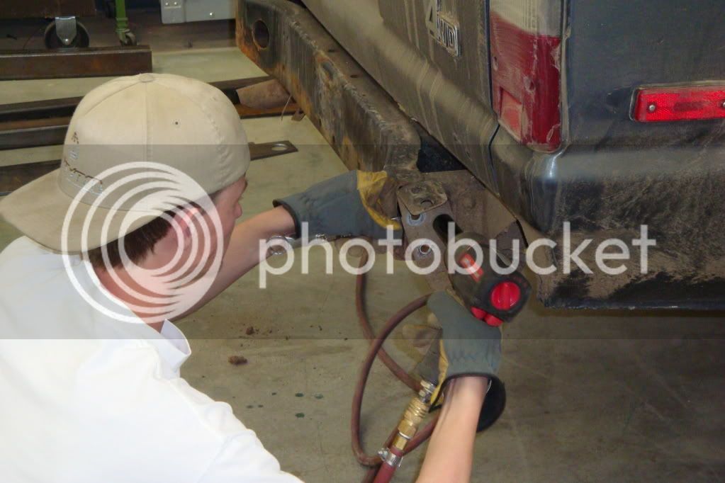

Today was a pretty long 13 hour day of building the bottom section of the bumper. Still have at least 1 more day of work ahead though.
Some pics...most have my dad in it, because I had to take pictures otherwise he probably wouldn't. All of the welding is/was being done by me...most everything else is too....
Thing is gonna weigh a metric ton by the end of it, but hey...it'll be damn near bulletproof.

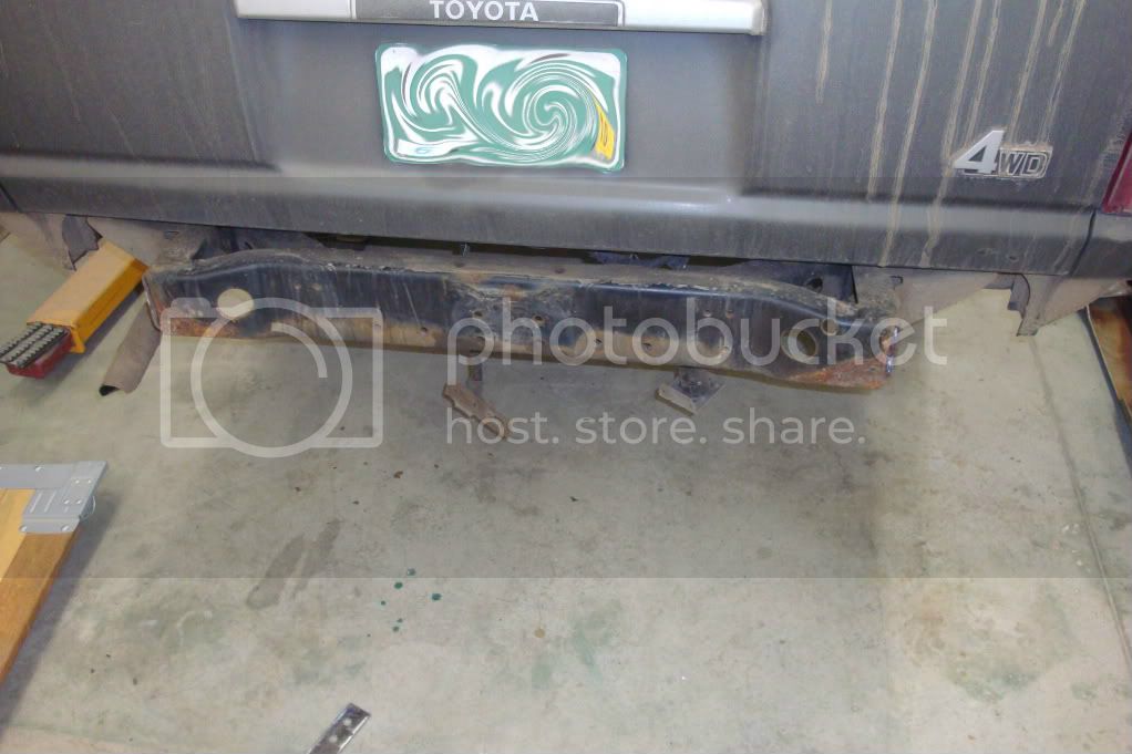

I figured I'd take a picture of just the xmember for ya to illustrate my point.
The instructions are helping quite a bit, but we started with the vertical plate (with the tow points) and then tacked the top plate, then the side wings.
We had to add some extra spacers in between the frame brackets just because of the variations with the extra x member. No big deal though, especially when you're building this thing a full on metal shop with a hydraulic metal bandsaw, drill presses galore, 220 and 115v hookups everywhere, etc, etc.:D
