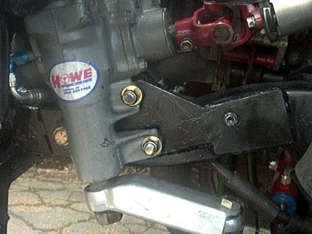

I took a picture of the power steering pump last night.
Hopefully someone will recognize where it came from. The PO's claim was it came from a 60.
Definitely not FJ60 or 62 or 80.
99% sure it's an IFS mini-truck steering box.
Here is a Pic from Roger Brown (Minitruck guru/smart guy/Trails Truck Tech Editor)
looks like a match to me....
