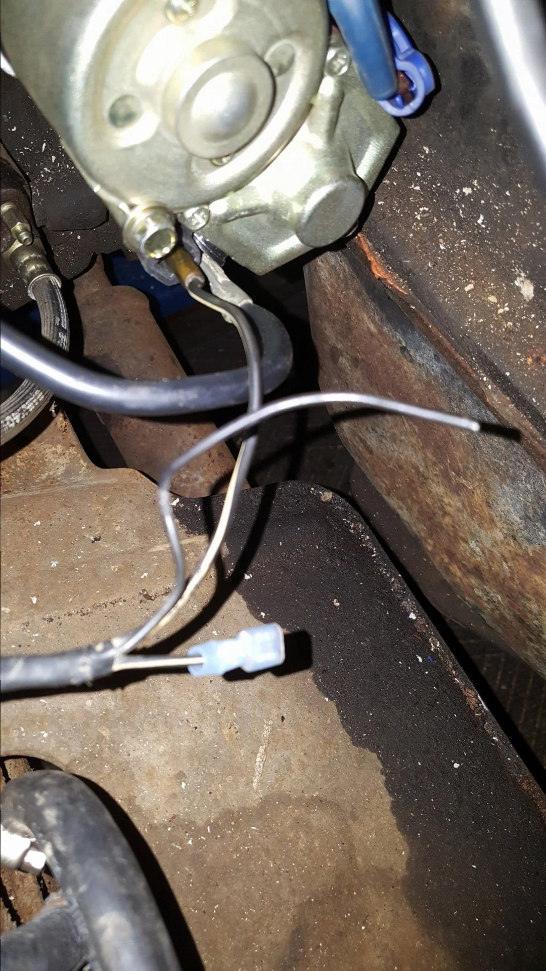

1974 Fj40 with a new Petronix Igniter Ii and the Flamethrower II coil with a new gear reduction starter.
On the starter end of things I have the B/Y wire connected to the starter along with the power from the battery of course. The black wire and black/white wire not connected (picture)

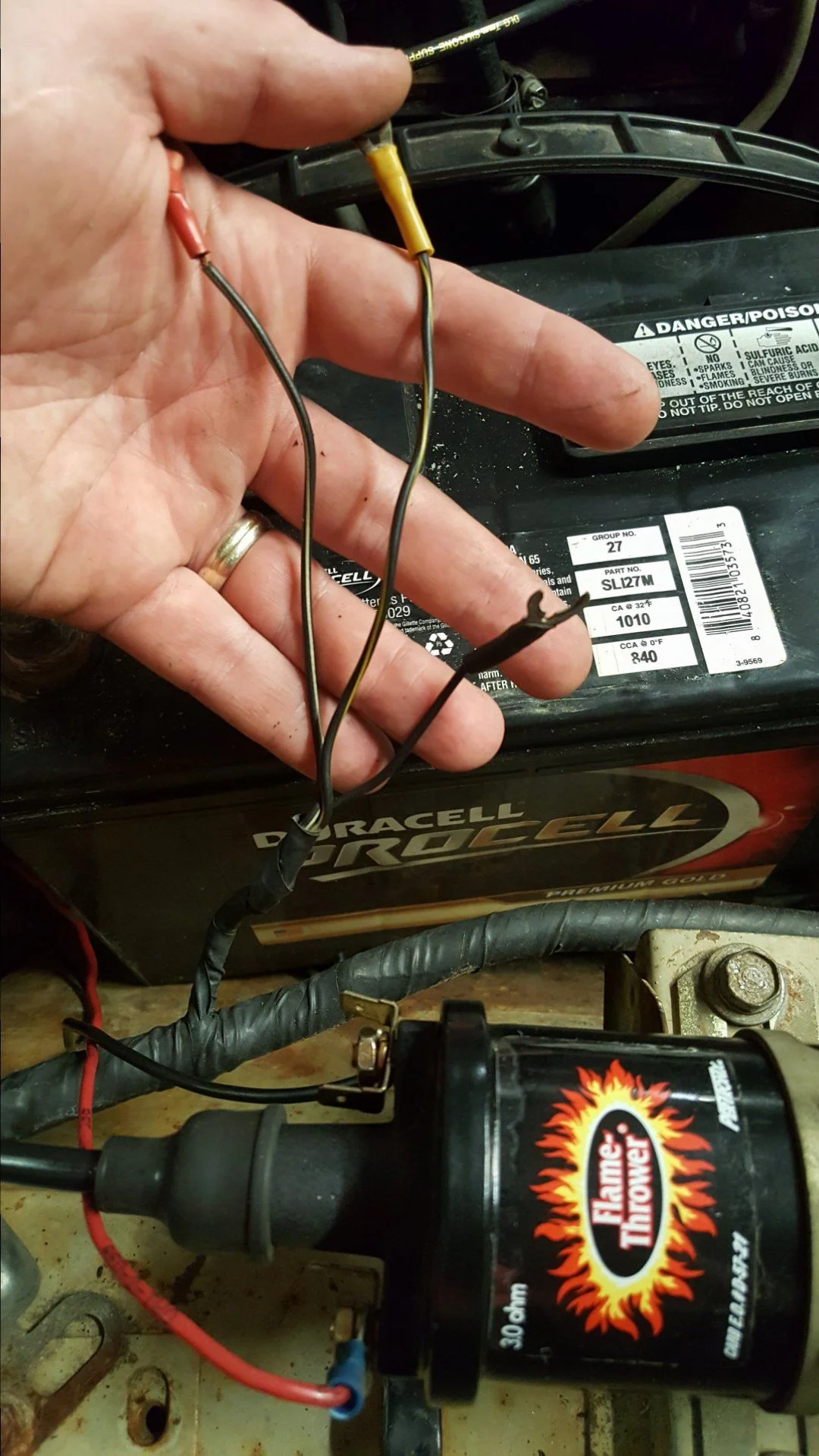

On the coil end, I am not using the ballast resistor, so i have the red wire and black wire form the distributor connected to the + and - respectively on coil. There are 3 wires next to the coil, B/Y, B/W and Black. i just need to know which wire is supposed to supply the power to the coil? I have looked at the wiring diagram and it says the B/Y, but I have read that the diagram is incorrect on one or two of the years.
The starter is turning over fine, but neither B/W or B/Y wire seem to be supplying power when connected to the + side of the coil.
Keep looking. There are TWO B/Y wires. Chances are you need the OTHER one.
Got it.... it was the B\Y wire next to the coil. The problem was old wiring. Traces the wires back and once I got the blower motor working, suddely i had power to the B\Y wire next to the coil. The B\Y wire runs aling with the blower switch.
You need a ground on that starter, the large black one. Bolt it to the frame.
Already one there.... outside of the picture.
