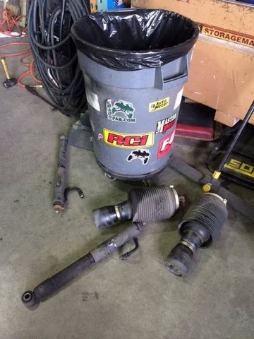

yep, Radflo plus coil conversion (remove airbags) and sliders today (hopefully if enough time). if not I will throw them in the back and put them on at home.

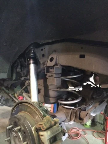

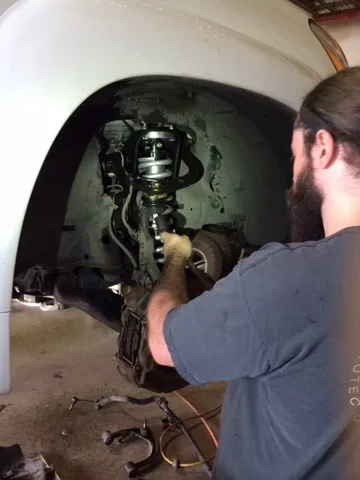

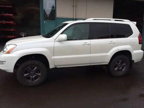

the CB mount was purchased at right channel radios but I forget the exact mount. In other news, the suspension is in and I am the new owner of a Radflo suspension in the GX. LT at Metal tech was very good and really spent some time pulling out the old worn out components and adding in the new goodies. We ran into a little rust so had to use a chisel to separate the front shocks from the mounting plates.
Finally got everything in (except the sliders), but we predrilled the frame and i threw them in them back so I can mount them up this week.
So far my impression is that it is not the "cushy or velvet soft" stock setup, but it sure soaks up the real bumps like railroad tracks, speed-bumps and road potholes. I'm really liking it and it is a firmer handling setup while driving on the road to work in the mornings. Now I need to try some trails and bumps to really test it out. image.webpimage.webpimage.webpimage.webp
