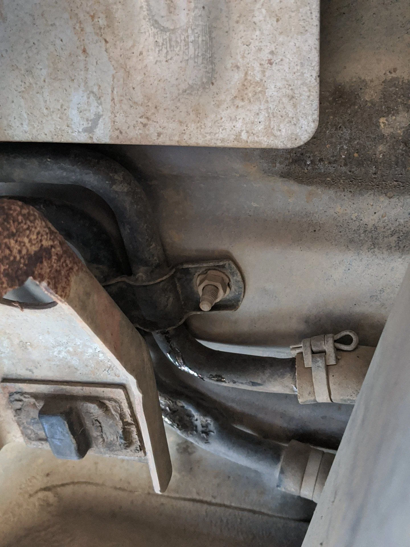

I've read a ton of threads but most of them involve eliminating a CAT to go over the frame on a 1997, which I don't want to do for fear of the smog czars...but I think I can keep the cats where they are and sneak over where the rear heater hoses are...I will bypass the rear heater since I managed to crush them. Has anybody done this? What am I missing?

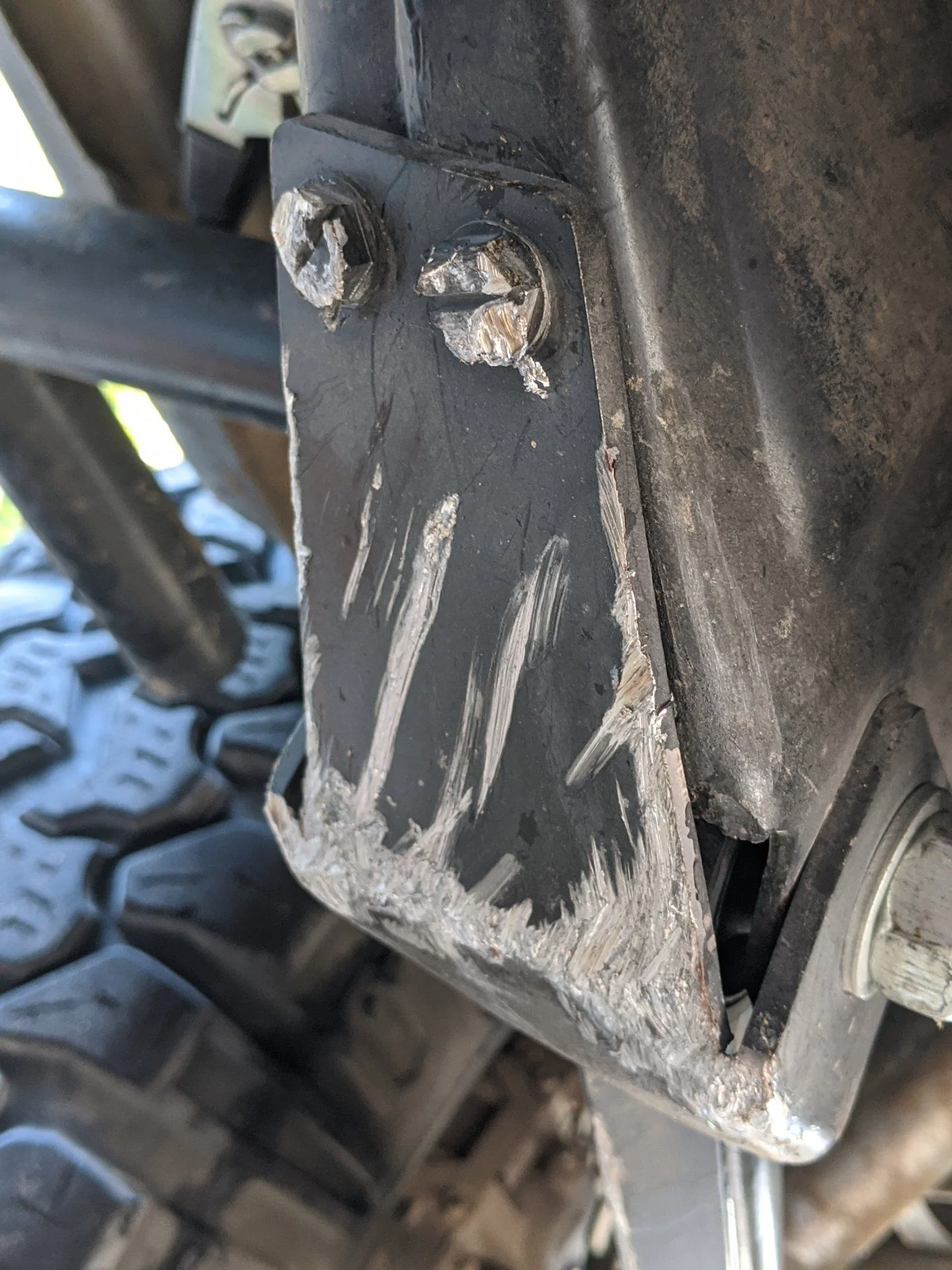

One of the wratchet straps melted going down the 15...might have lost the tire:( but learned a lesson, not sure what it is yet but...😀

Look like mostly the side biters are damaged ? Those tires have a thick side wall I wouldn't worry about that.

Im sure the tire is fine.
Yeah, I dont think it went through, I will pull it off and take a really good look just to make sure, but Im not too worried about it.
