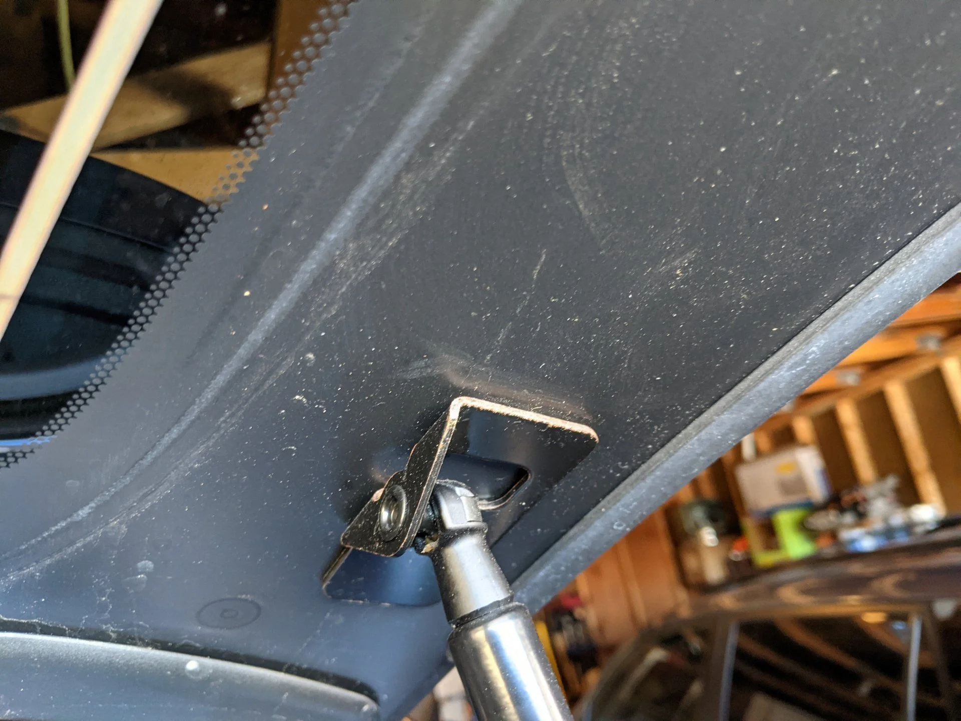

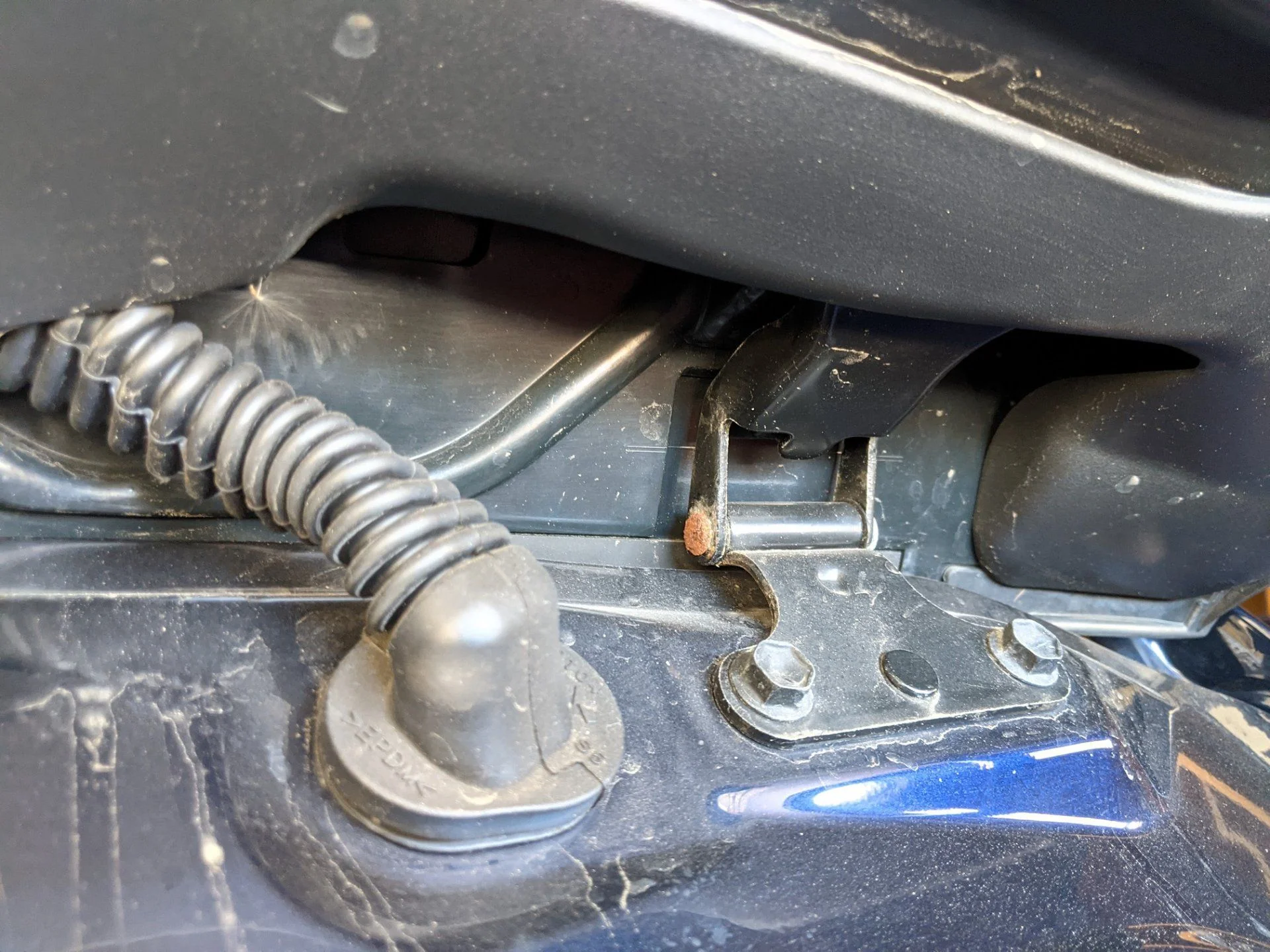

Has anyone seen corrosion under the rear window? I've got some on the hinge pins for the window and the edges of the mounting plates for the gas struts:
Seems like an odd place for corrosion, the underside of the truck looks fine. Will need to find a good way to clean this area up.

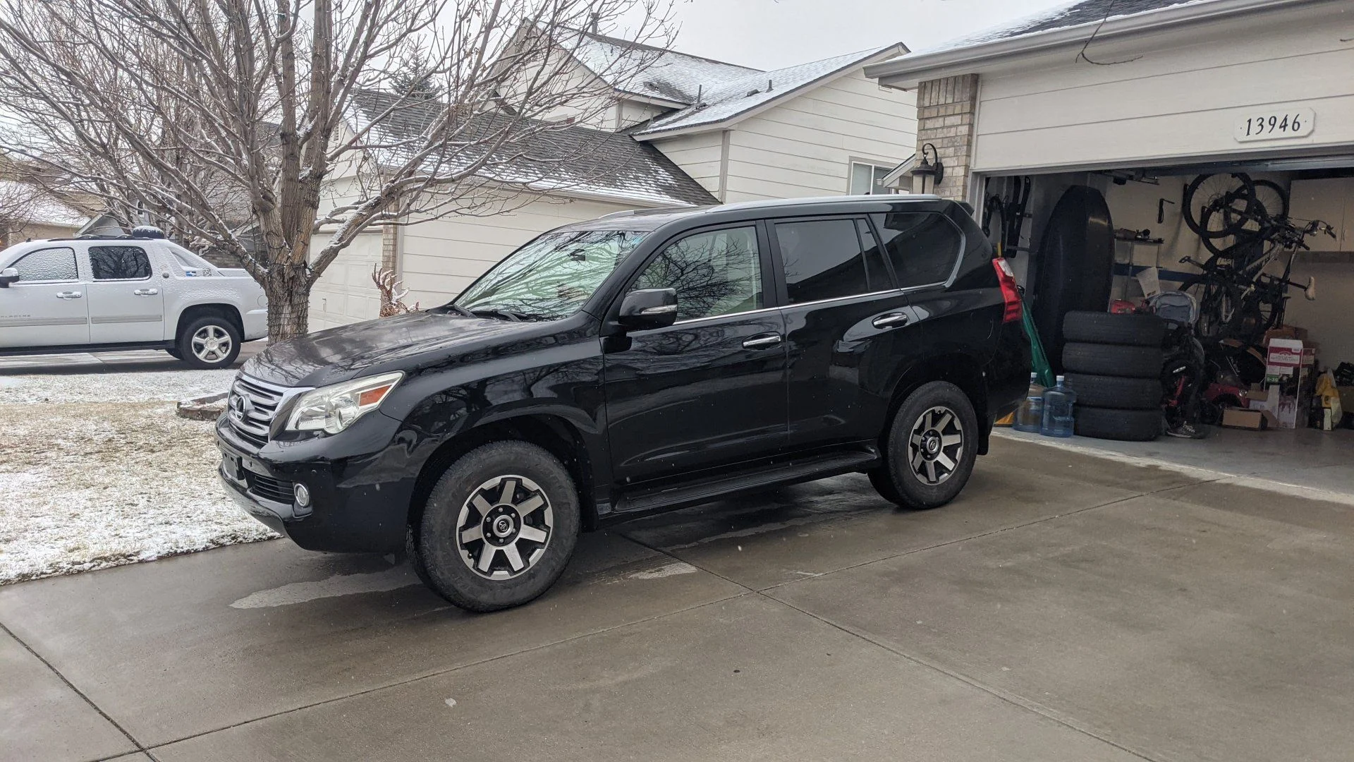

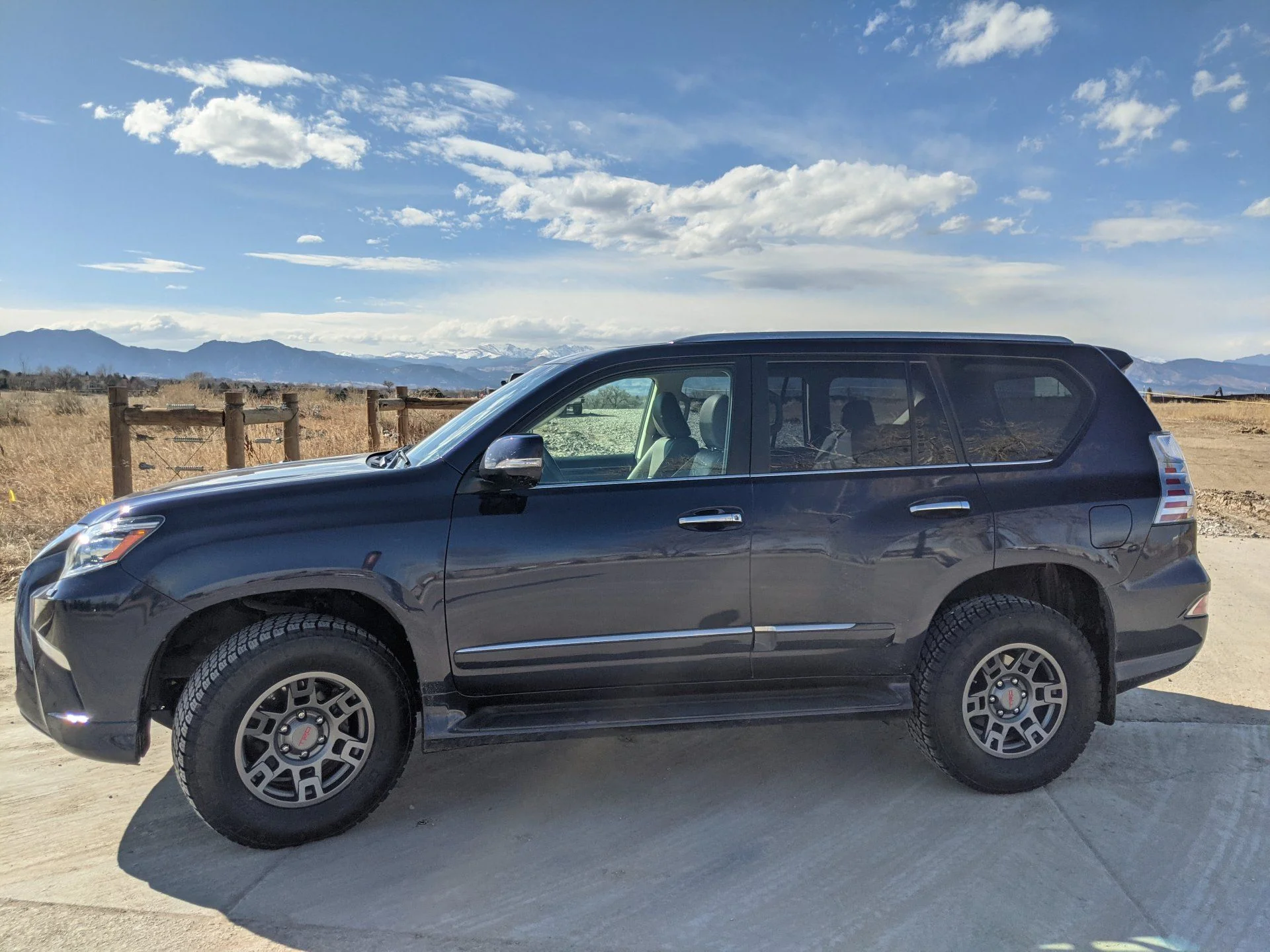

Found a good deal on 17" TRD Pros in Matte Grey, so I picked up 5 and put some 265/70/R17 Nitto Terra Grappler G2s on them:
I don't have a problem with the chrome on the GX, but I'll probably look for some vinyl wrap to match the wheels and wrap the chrome bits as I find free time here and there.
Looks good!

I had similar corrosion in those same areas on our 2019 LX570 and it was largely a street queen down here in south Texas. It baffled me as well but the only thing i can figure is that those parts weren't properly treated.

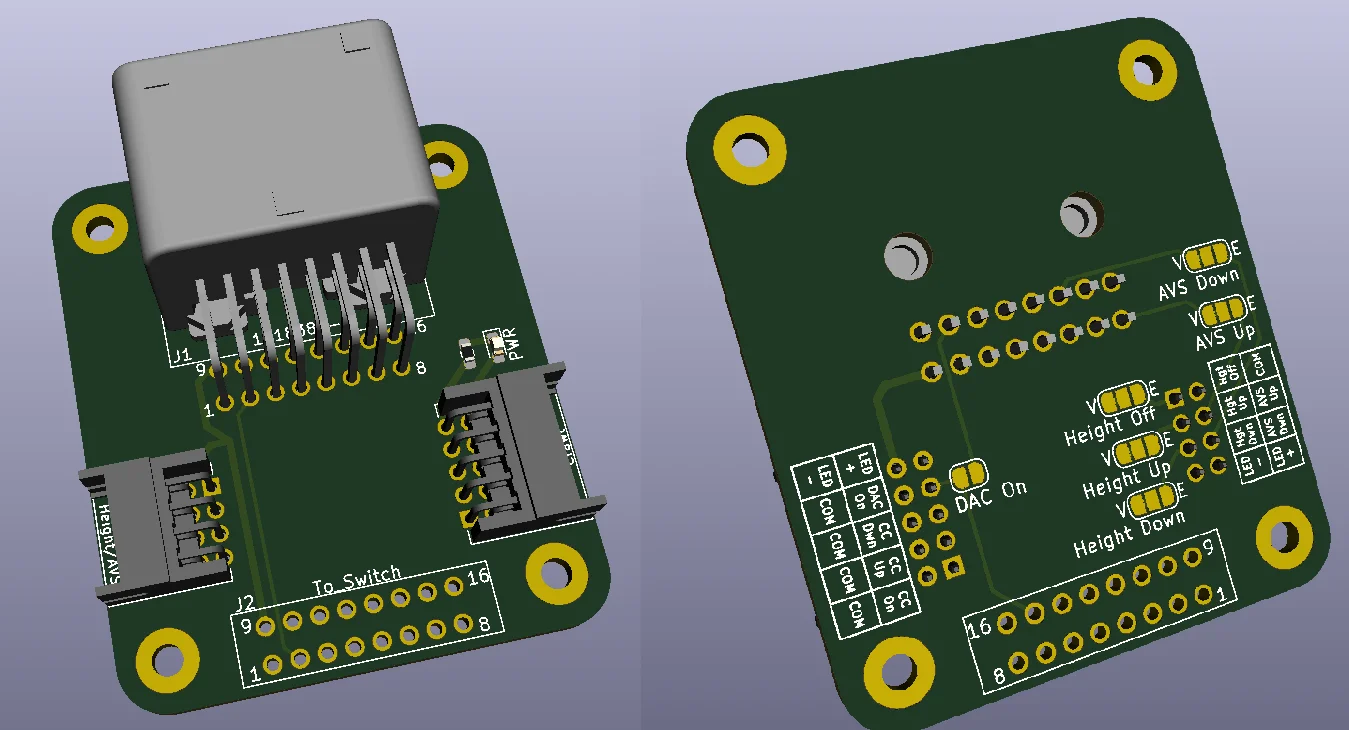

As part of getting ready I spent an hour doing the uni mod and installing MTS and Crawl Control. I don't have AVS/RAHC, but since I know I'll want some extra switches for mods later on down the road I installed the crawl control switch set that includes the AVS/RAHC switches. Took the time to reverse engineer both switch sets before installing, and have spent a bit of time designing a circuit board to insert between the switches and the vehicle that will allow me to break out the AVS/RAHC switches/buttons for external purposes:
Figured that I may as well break out the crawl control switches while I was at it, so the board could be useful for adding crawl without purchasing the crawl switch set. Need to finish routing the board and send it off to fab; will hopefully have a couple prototypes to test out in a month or so.
Very nice! looks like SolidWorks??
Also this may help, Acrad posted this some time ago:
It's actually KiCad/Pcbnew's (schematic capture/board layout software) 3D viewer.
Lots of good info from Acrad; I may end up trying the RAHC switch for a winch and the AVS switch for lighting. Either of those projects are a ways off yet, though.
