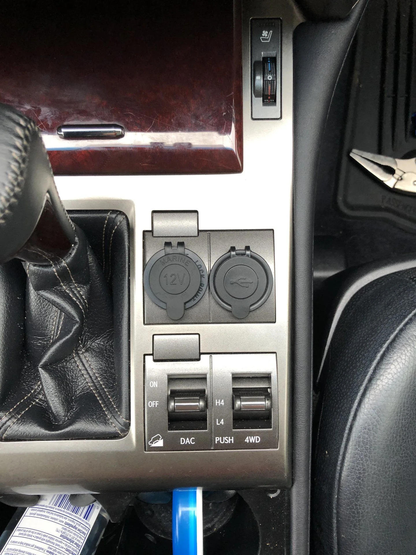

I don't have RAHC but am also looking for something similar because I don't like the giant blanks on mine. I thought about drilling them out and adding USB ports. I'm not sure if the circuit board runs underneath the blanks or if it's just empty plastic though.
A CL member did this on post #907.
Internally roughly looks like this. This is an 080 which is the AVS/RAHC without DAC.
Battery meter is a fantastic idea.
This was from another CL member before the 090 was known.
Great info 22Eyunu35VO! I too have been playing with the idea of what to do with those two switch blocks.
I may even add more USB ports there.
