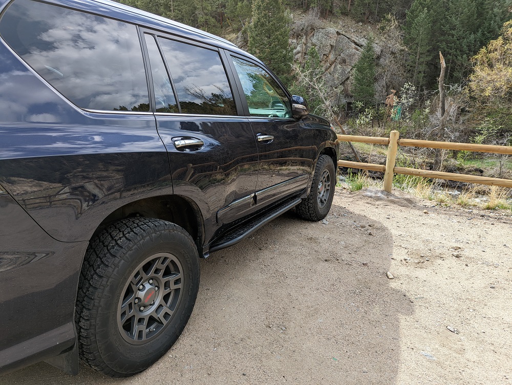

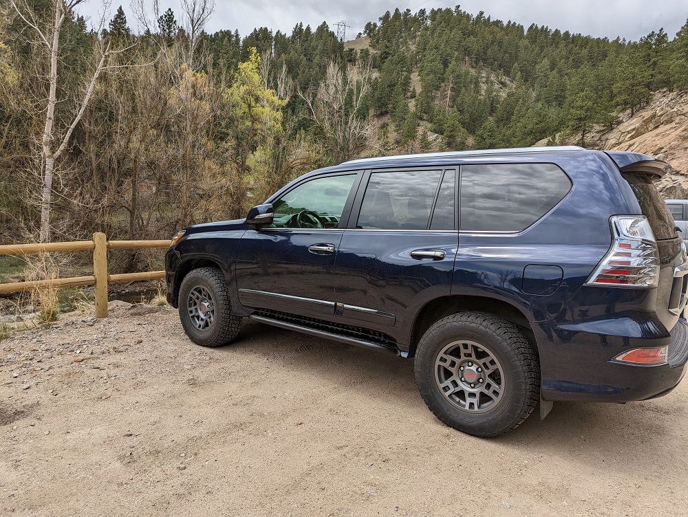

Finally found the time last week (an hour here, an hour there) to install the RCI sliders:

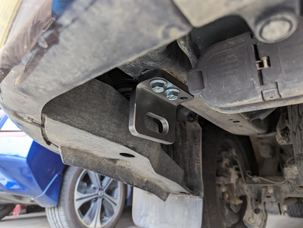

Also installed some rear recovery points while I was down there:
Slider install wasn't as bad as I'd been led to believe. Having a rolling motorcycle lift made positioning easy, and to get behind the KDSS lines I made a small wedge from some scrap hardwood slightly thicker than the slider mounting plate, pushed it behind the KDSS lines from the top, and then led the slider push the wedge out as I lifted it into place.
