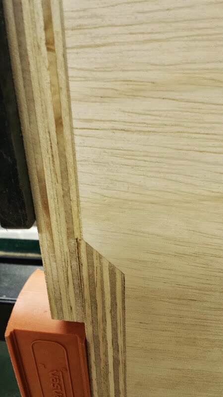

For the drawer front, you nested the front and back of the drawer into the sides. You noted this was difficult due to the stepped sides. Is there a reason you couldn't have cut the sides 1.5" shorter and put the front and back panel against the sides? This would be a lot easier to make I believe.

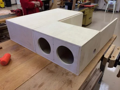

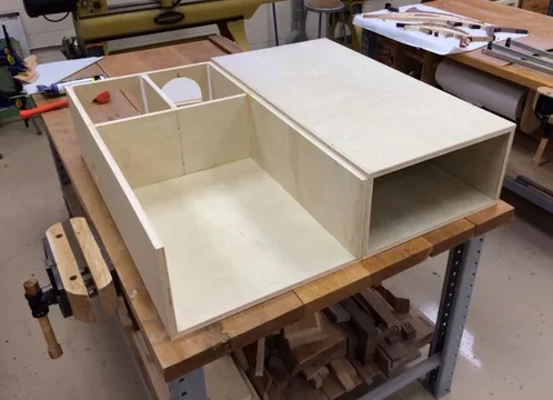

Here's where I'm at on my build. Driver side will house all electronics and subwoofers and stay in vehicle all the time. Building a short drawer for now but will build with consideration of making a slide for fridge in the future. Pass side is going to be a near replica of your fine work.
