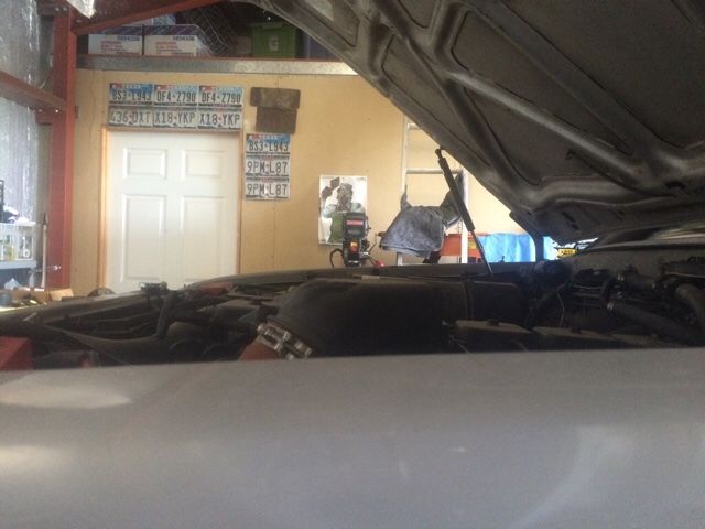

Here is a side view for reference regarding intake horn. Remember I have 1" body lift.
