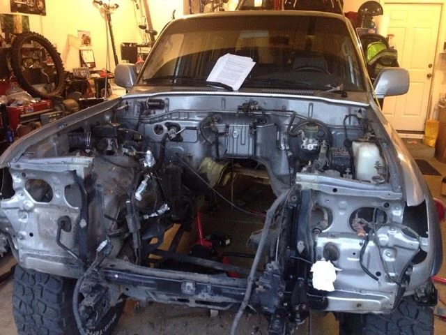

Also I'm officially in the same Diesel Adapters club... I drove up and got my kit couple weeks ago (which is seeming to be an advantage I have living kinda close to him) and am well into the project, I just need to get caught up on a build thread...
